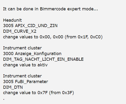

Did anyone tried to code the instrument cluster light to not to be so dim ?
I found this on the g forum on bimmerpost.

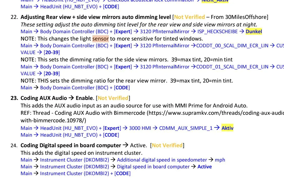

Is this the fix ?
What was the value that you coded ?
The coding value is a multiplier
Thanks in advance

That's for the head unit, not for speedometer.
I'm searching the solution for the speedometer
