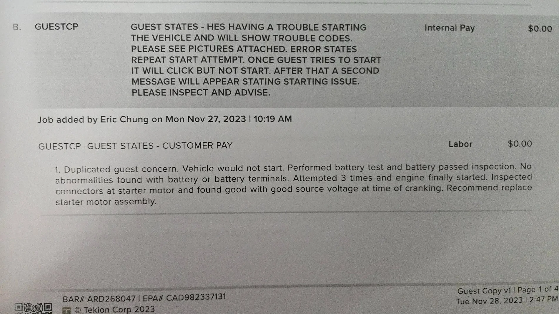

Could be either the battery or the starter motor. I had a similar issue at 23k miles and the dealer was able to diagnose it as a starter issue and replaced it under warranty.

Probably the starter motor then. My car had that hesitation starting up for a few weeks until one day I got an error code and I finally brought it in to the dealer.
Why would it only happen on cold starts tho. I thought it might be more fuel system related, like a pressure leak of some sort.
