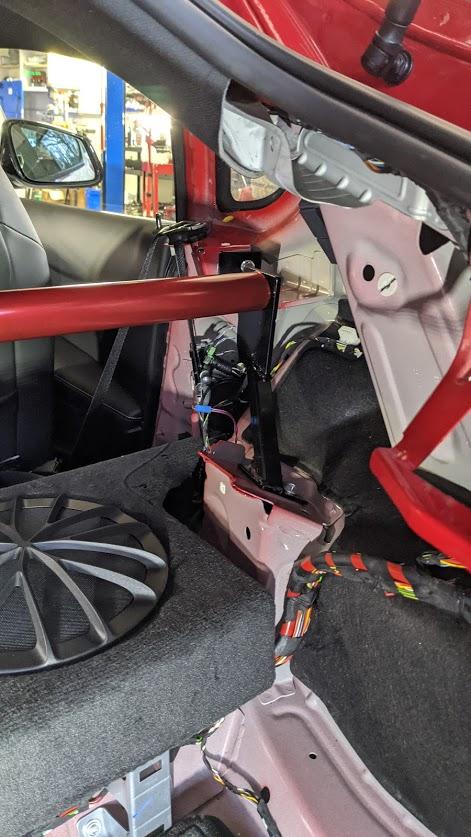

Then take a look at the USR bar if you are on the "Cusco is bad" train. Actually uses the same mount point as the CMS roll bar you were looking at.
https://www.unitedspeedracing.com/products/usr-harness-bar-for-2020-toyota-a90-gr-supra-mkv-mk5
There is also the WPM roll bar but you need to lose the sub box and weld plates in (for it to bolt to)
https://www.walkerpromotorsport.com/product-page/a90-supra-bolt-in-roll-bar

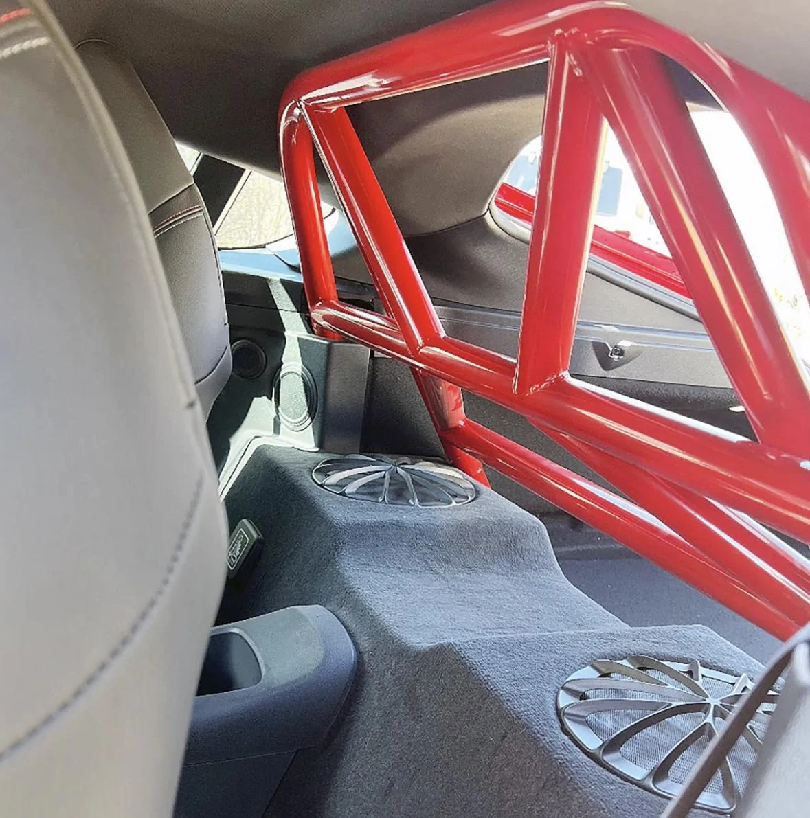

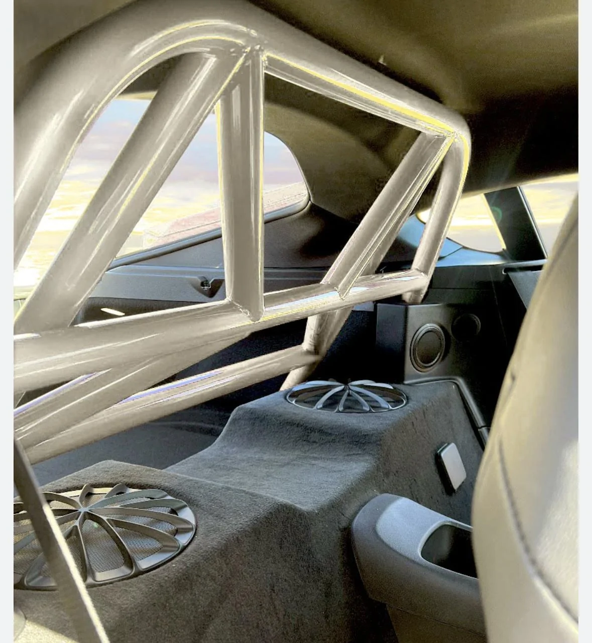

Here is what a studio rsr one looks like. Seat still goes all the way back.
DarkZupra
Matt
May 16, 2021
36
1,133
1,793
Orlando, FL
2021 Supra 3.0
I spoke to Studio RSR who told me id lose 2-3" of room, aka id have to move the seat forward 2-3", which I cannot do.
