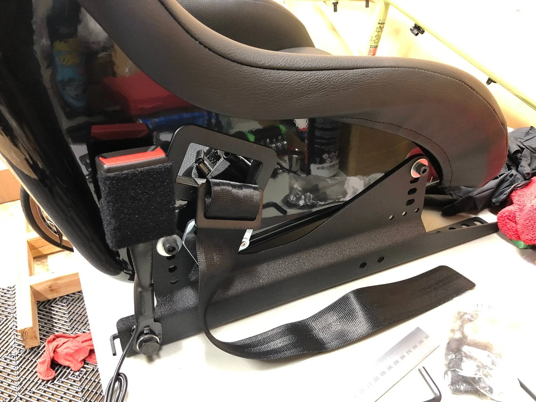

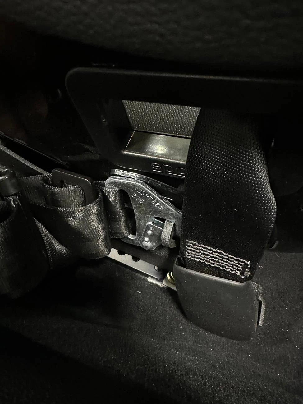

The issue with seat mount anchoring for the harness is that many people add seat slider rails. That would put the force entirely on one piece which is the lock on the rail itself.
Even anchored on the seat mounts, the torque created from a collision of the seat would exert an extraordinary amount of force over the mount itself, that force would be transmitted to the screws of the seat mount that are not rated to sustain sheer forces the same way the harness anchors are. Remember that when chasis mounted, a backing plate is needed. I don’t think many people place backing plates in their seat mounts (normally you would not need them, the seat is not exposed to the same tenaion
Finally the issue with the OEM seat mount.
It is safer than a seat mounted harness. There is no question about it: the OEM seatbelts are designed to travel and lock. The inertia of the belt decreases the speed of the driver by applying counter pressure for long (in the sense of collision timeline) period of time over a large surface area. That travel of the seatbelt on impact decreases the G forces on the entire system and allows for the rest of the restraints to work (mainly the airbags).
A harness does not travel; the pressure is static and very short in time over a very very large surface area. That’s why you also need a Hans. You are basically a fixed object moving at the speed of the car over something that is not flexible. On a 35mph collision of a 180Lb individual, you get close to 7000 lbs of force over those screws, you and the seat will exert twice the weight of the car over that seat mount - or the Cusco bar. If you think you can hang two Supras on those two pieces of hardware, then that solution should be ok.

thank you Bryan, the only one to actually show me what they did in their car. then it turned into another useless argument that people in the future will have to wade through when they have the same question i did. can't wait to see what my next thread will turn into.

@Vtec13 Glad to be of some help, let me know if you have any other questions about the setup.
