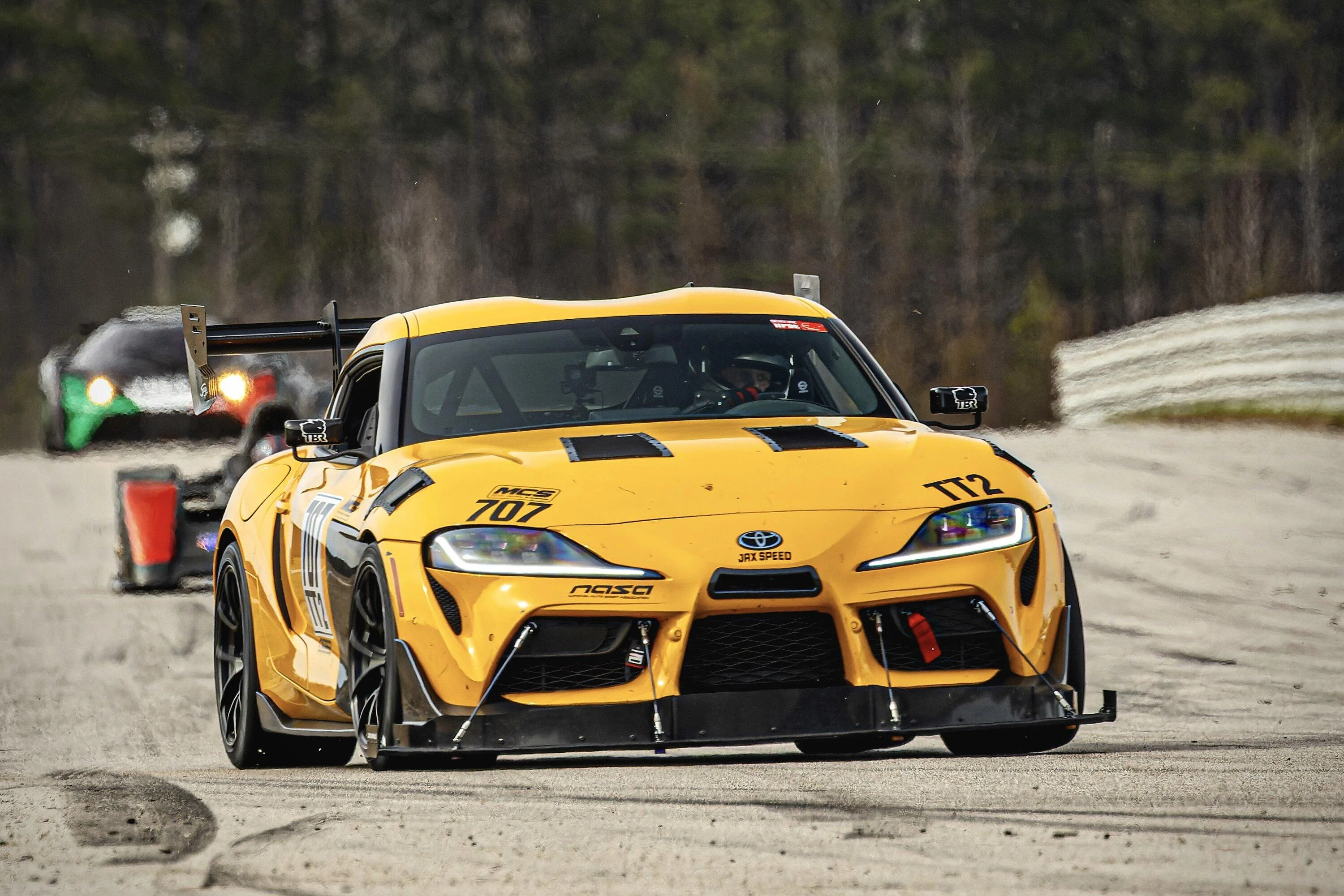

"Allen Patten was competing in his first Time Trial event with NASA Mid-Atlantic at Virginia International Raceway when he put down these two fliers. It’s interesting to note is that he’s running on Nankang street tires and stock suspension from the Toyota factory. Allen managed to beat his previous personal best, which he ran on Hoosier A7 slicks, and finished second in TT3 that weekend at VIR."

Can you share more details about the setup?
Nankang 200tw
Stock struts
Stock springs?
Tune?

Hey there,
This is on 200tw Nankang, stock struts with hks springs and stock tune making 370whp.
It had a verus rear wing only, which I think did a lot more harm than good at this track with how bad the understeer was even turned down to 0 aoa.
I’m still relatively new to driving, I think if you ditch the wing and more driver mod, can get this down closer to 2:00.
Going back soon with the new setup we did over the winter, excited to see what it does.

Great driving! How do you like the hks springs vs stock springs on the track? Any places where you feel the damping is under or overdamped? Do you have any rubbing issues? Did you skip the front splitter at the time due to spring rate?

Thanks!
My biggest complaint in stock form is the excessive body roll and I think the springs do a decent job to help with that. The biggest advantage I’d say is being able to run wider wheels. There was definitely some self clearancing that happened on the fender liners but nothing too crazy.
I’ll be honest I’m no where near a suspension expert but I would generally say the biggest issue with the stiffer springs on the stock struts is the lack of rebound stiffness. As the car would roll through the corner, it tended to wallow around a lot, especially when I tried to run slicks. Had to be super precise to get the car to sit down and corner smoothly.
I was just waiting on splitter due to plans to overhaul the aero over the winter anyway. The car has proper aero and suspension now and is a rocket ship! I left the wing on out of pure laziness really and just decided to drive around it last year.

What aero are you running?
