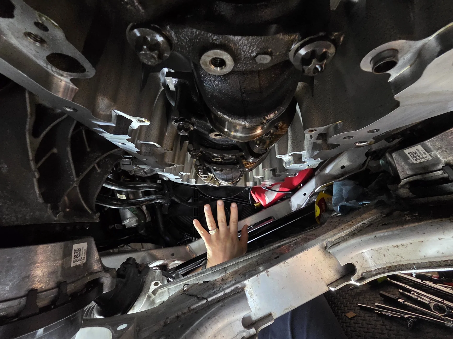

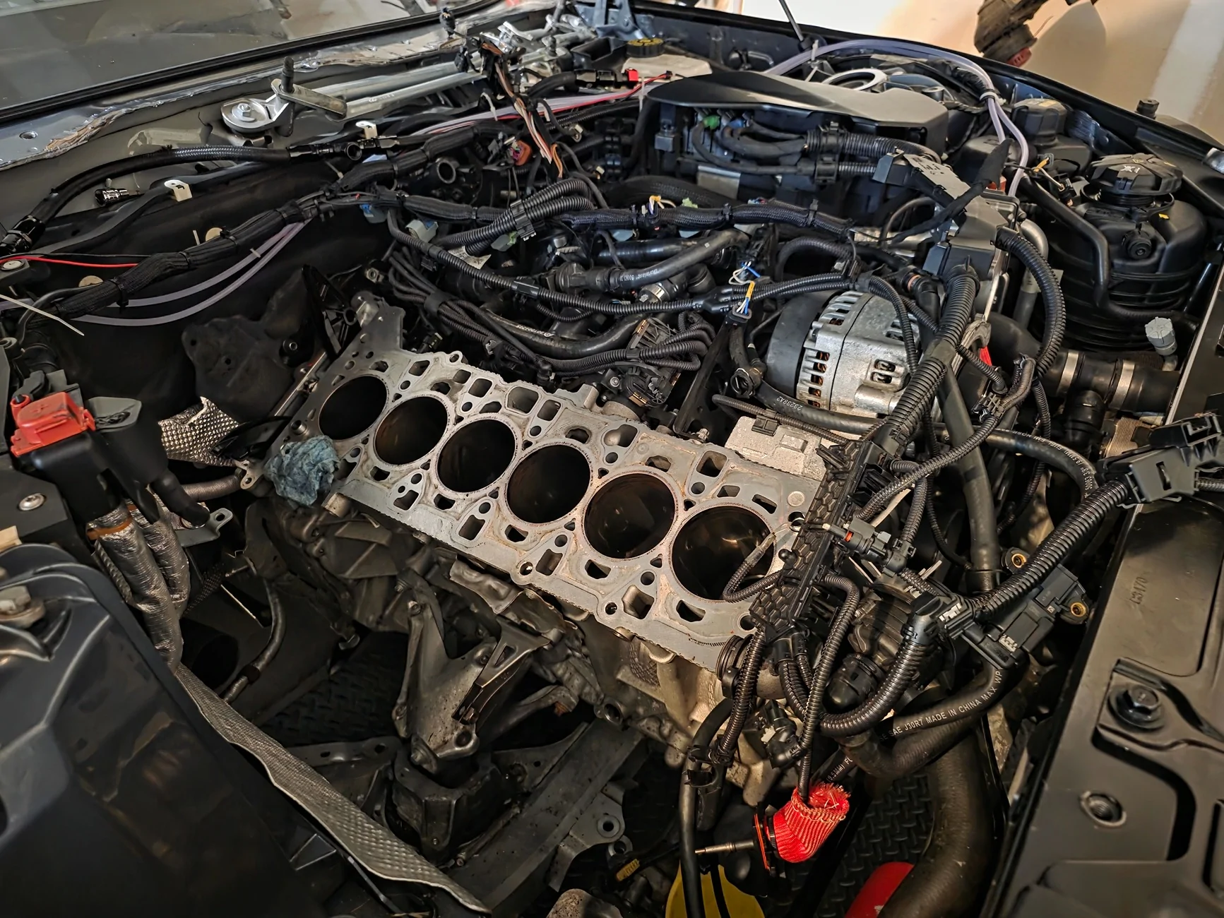

Make sure to do your retorques... i did 3 and 3 oil changes before I let it get into boost... all that by 500miles.
It went pretty smooth for the most part.
Issues that arise:
Disassembly:
- Cradle bolts and oil pump bolts are weak and will shred if the socket isn't perfectly on them.
-Buy all the bolts and tools ahead of time to reduce delays.
- This is a good opportunity to replace the plastic oil pump
- I used a machine shop to clean, install valve springs, and deck the head for $400. Shaved a lot of time and money on tools I don't need in the long run. Do this in the beginning.

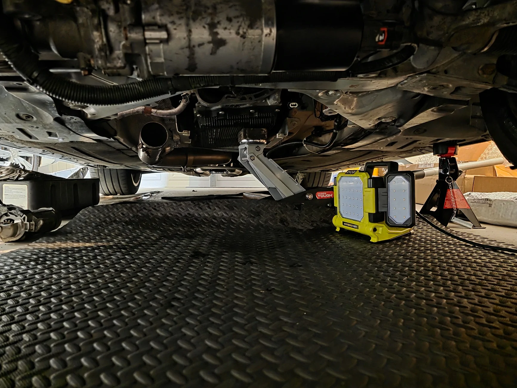

- I had to jack one side place wheel ramp under that side then jack the center with a wooden block to get the car high enough to place jack stands on both sides.
Reassembly:
- I missed the ground on the back of the engine block, caused significant delays trying to figure this out.
- Reset adaptations before start up, reach out to tuner for a new map before start up.
- I didn't really have any other issues putting things back together other than the ground.
- I'm going to let this break in for 500 miles before I start doing pulls and sending logs.

I might have jumped the gun, but I am currently on the reinstall steps, i've installed the pistons and rods and will get to the oil pump and oil pan next.
I've been taking it very slow and ensuring I research everything before I go into the next step. I've put well over 25 hours of work into it over the course of a month. I've been learning as I go.
5150 website has the best price that I can find on the pistons and rods as a set and they offer a ton of variations.
I went with the OEM gasket, mainly because papadakis did, and I don't plan on going over 900hp.

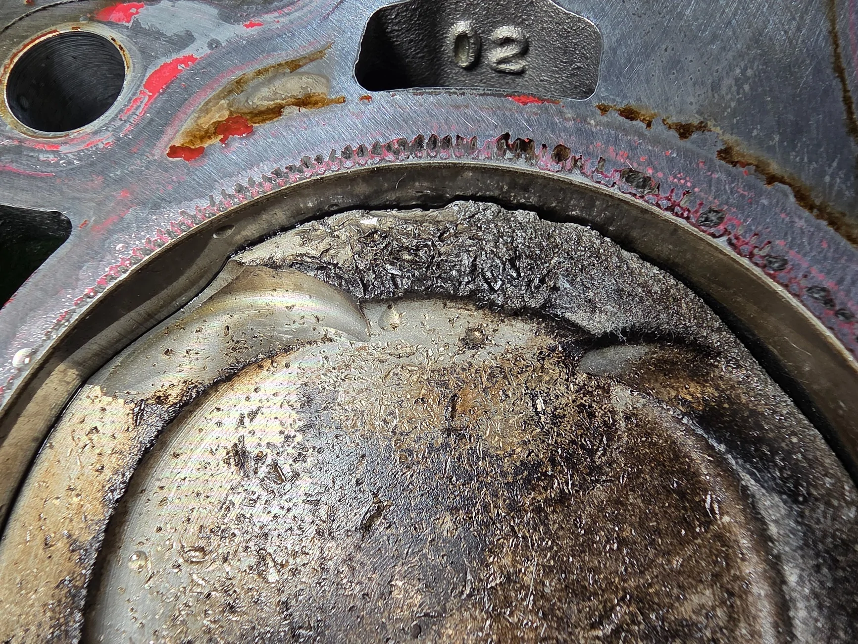

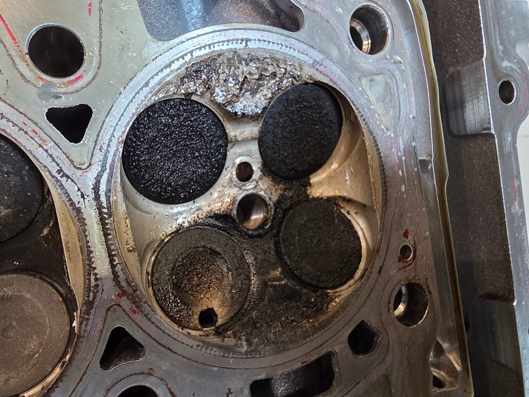

For me, the head had damage in cylinder 6 so I had to get it machined, but there are tools you can buy to check the surface of the block.
The tuner, Pureboost, recommended against going down in compression.
