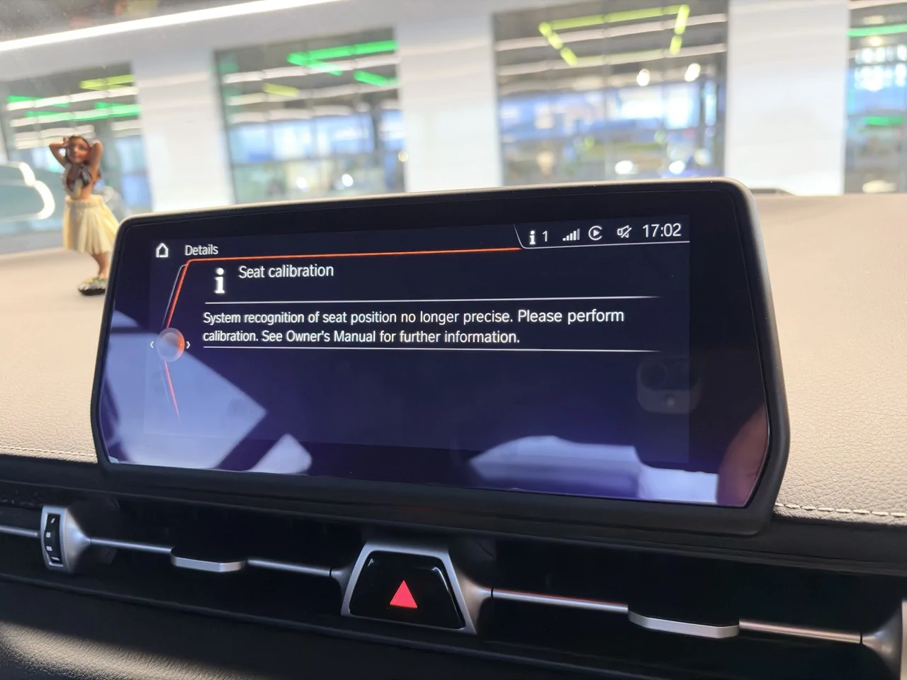

Not exactly relevant but.. I got this weird error today while at the dealership after a service. Nobody there knew what to do as the Supra techs had gone for the day so I drove the car home with the error. After a few attempts, the calibration from the manual seems to have made the problem go away. Weird.

Just by way of an update on my issue.. after calibrating it as per the manual a few times, the error went away. 🫡
