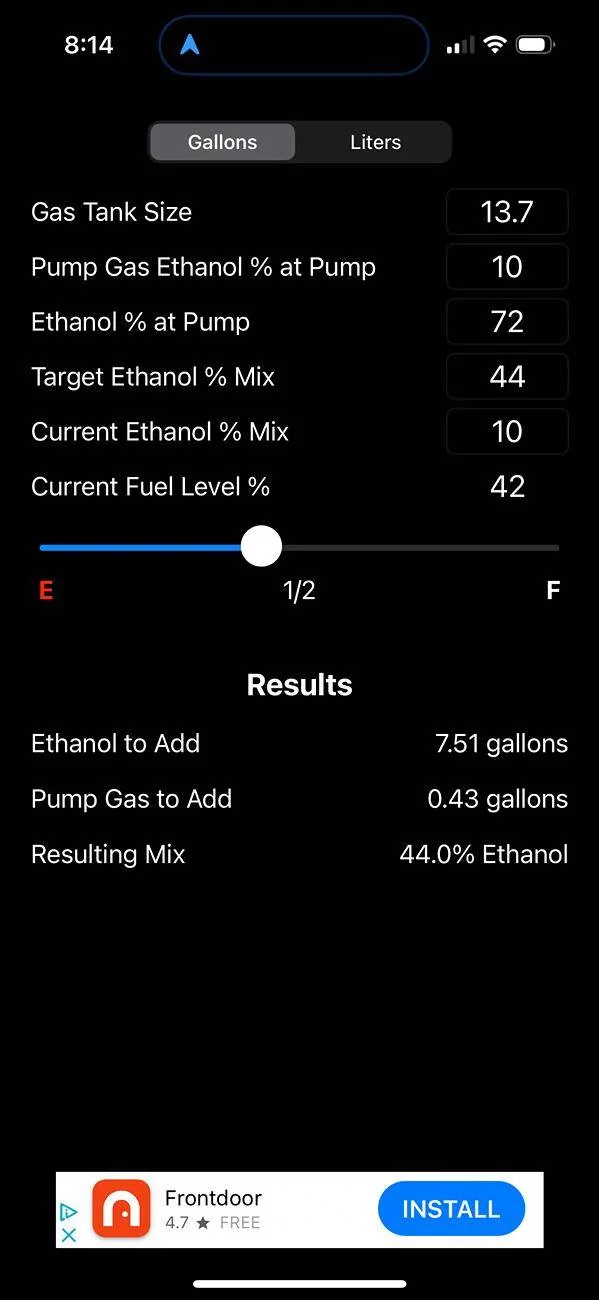

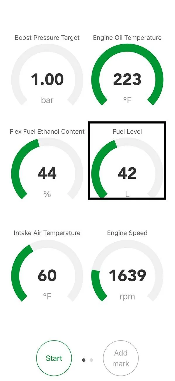

can someone help me, So i have the Ecutek app and I use the fuel level on the dashboard so I can put it on the ethanol calculator app to fill up e50, and as you can see, the Ecutek app says 42 fuel level when on the dashboard it shows I have a full tank, and the calculator app is reading 42 as less than half. What am I supposed to do is there something wrong I'm doing on the Ecutek app or is there a different app to be used? Someone, please help. Thank you !

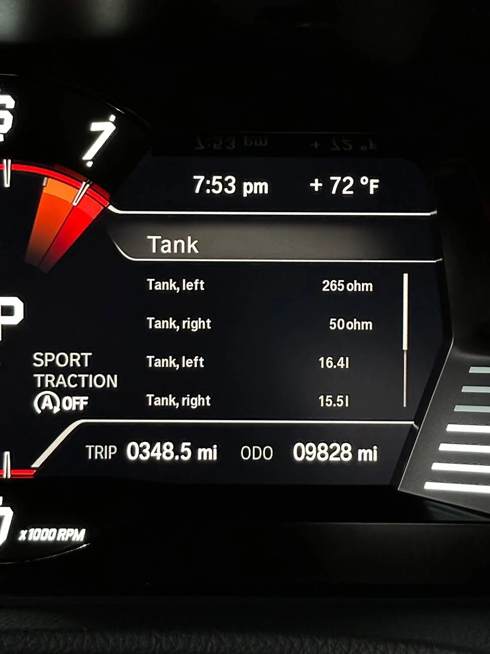

Skip that method. Go into the secret tank menu to get exact fuel measurement then use this calculator to get amount of ethanol to use.
- RJM
E50 Calculator
