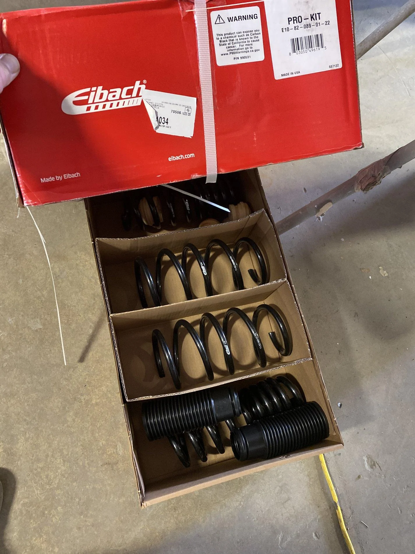

Hi guys. Just want to share this NEW information I got fron Eibach. Apparently, with the 2023 GR Supra Manual, using the same Eibach ProKit springs (E10-82-089-01-22) the advertised drop is NOW 0.9” front and 0.8” rear (compared to the Automatic which lowers the Supra by 1.7” front and 1.2” rear) :D
I haven’t confirmed whether the drop differences between the two transmissions is because the MT is lighter compared to the AT or is it because there are actual damper/shock suspension differences. (or both) ;)
Either way, these are the new numbers if you’re going to drop your MT which to me is a plus :cool:
Ordered a set. Thanks for the heads up!
They come with f & r bumpstops and new rear boot now
