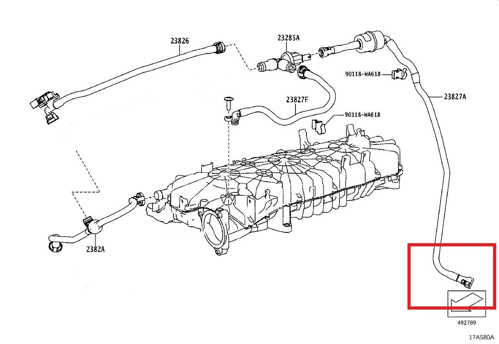

I've removed my EVAP system down to the forward side of the firewall and just placed a breather/filter on the quick disconnect fitting (Shown in red square). As for the entire system, I have no idea what all is required to be there.
