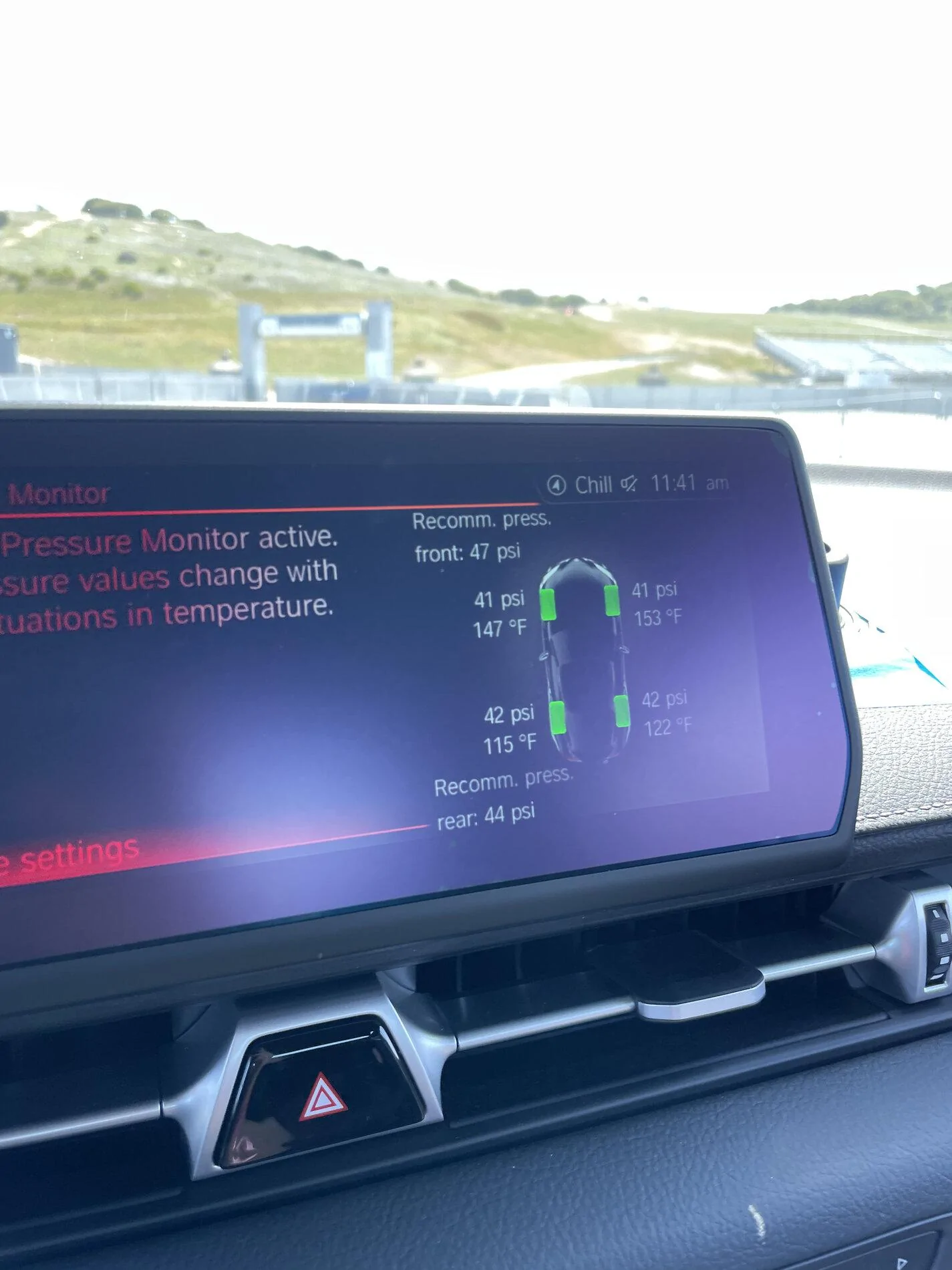

Start low 30’s cold to start
Look for wear on edges. Keep eye on temps
I was out at Pacific on a 95 degree day. Low 30s cold translated to about 40 warmed up on the stock PSSs. Might need to go down to about 27 cold to stay in a mid 30s hot range.
Possibly, everyone's climate is different. 30ish does great for first session or two. But i do end having to lower again at least once.
Check pressure and temps after each session.
You should be able to feel it get "greasy" when it beach balls. I can guess the pressure now fairly accurate by handling.
ps- there were a couple days that were so hot the pavement got to temps that velcro wouldn't have stuck to! pressure made little difference in the bite.
