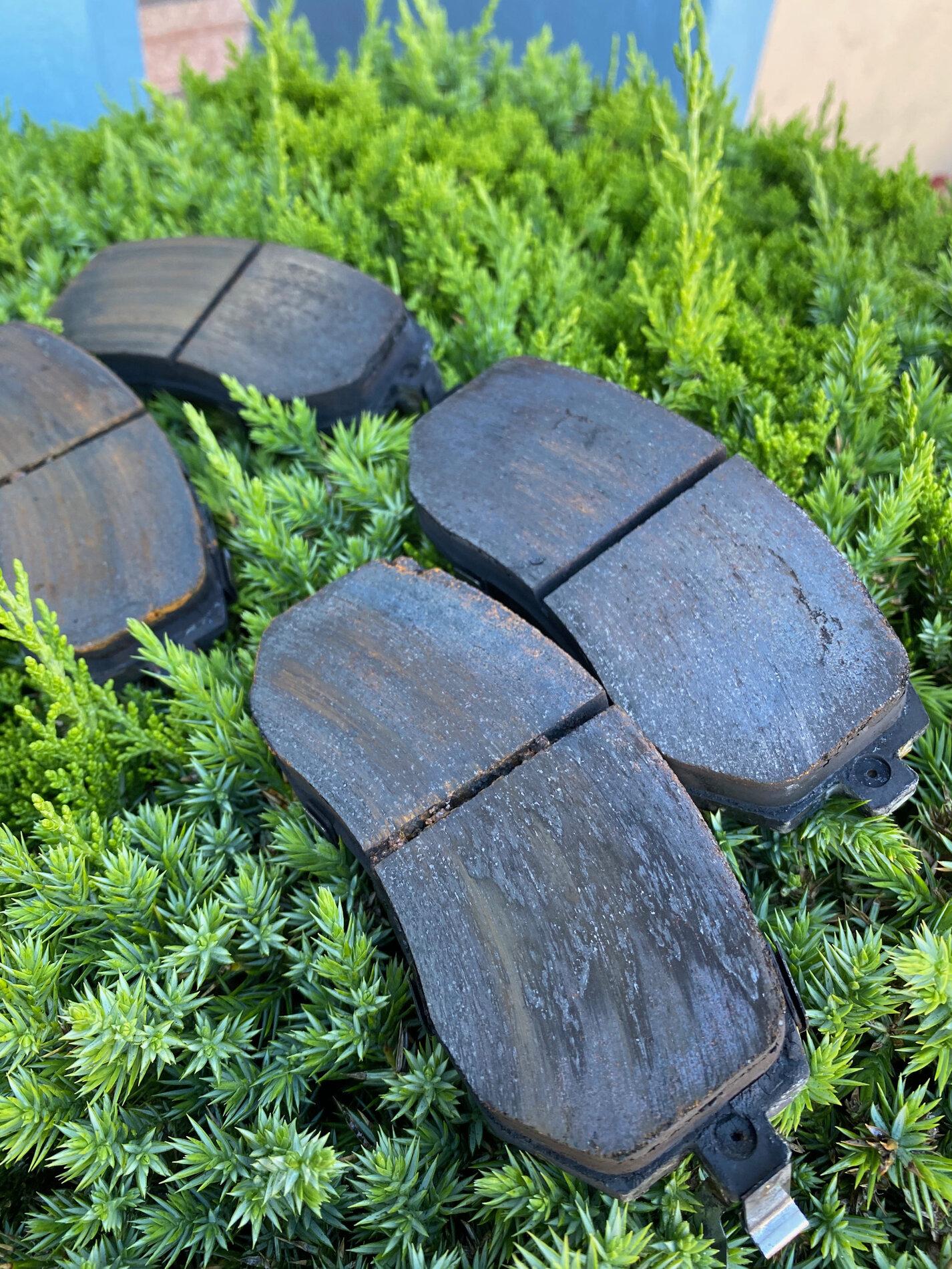

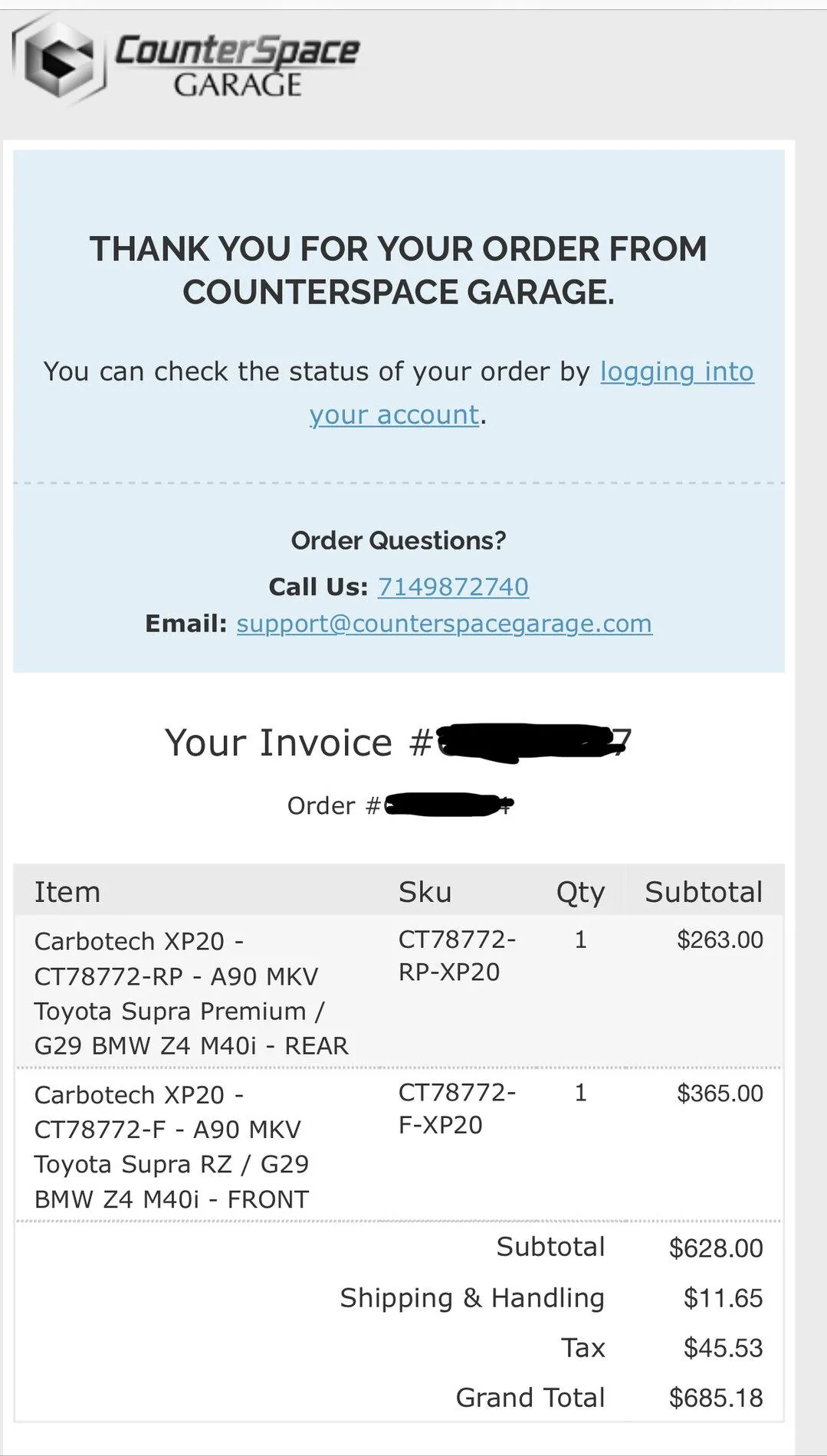

The carbotech XP20ā€™s Iā€™ve been using would work fine for a drive to the track and they come front and rear. The not for road use disclaimer is for excessive wear as far as I know and even though the temp range is high they bite frigginā€™ hard even when cold. They do have the metal-on-metal sound but with anti-squeal applied to the back, itā€™s not excessive.
Also, Iā€™ve seen people mention (mostly corvette forums) that they use a less aggressive compound for the rear. This is a common practice for race cars that do not have antilock brakes and use tires that flat-spot easy. However, the Supra has antilock brakes AND the Supra brake pads are already staggered in size and clamping force. The pads in the back are literally half the size as the fronts. Also, I havenā€™t confirmed this but, I saw one of those semi-pro track junkies disassemble the rear brakes and he noted the Toyota engineers put a more aggressive OEM pad compound on the back and he was pointing out the codes on the front and rear pads. And the part numbers pictured below are for the Supra Premium with the larger rear pads

Thank you! Pretty sure we watched the same video where they showed the pad ratings for front and rear. Seems like there are good options out there and I was over-thinking the warnings of not for street use.
