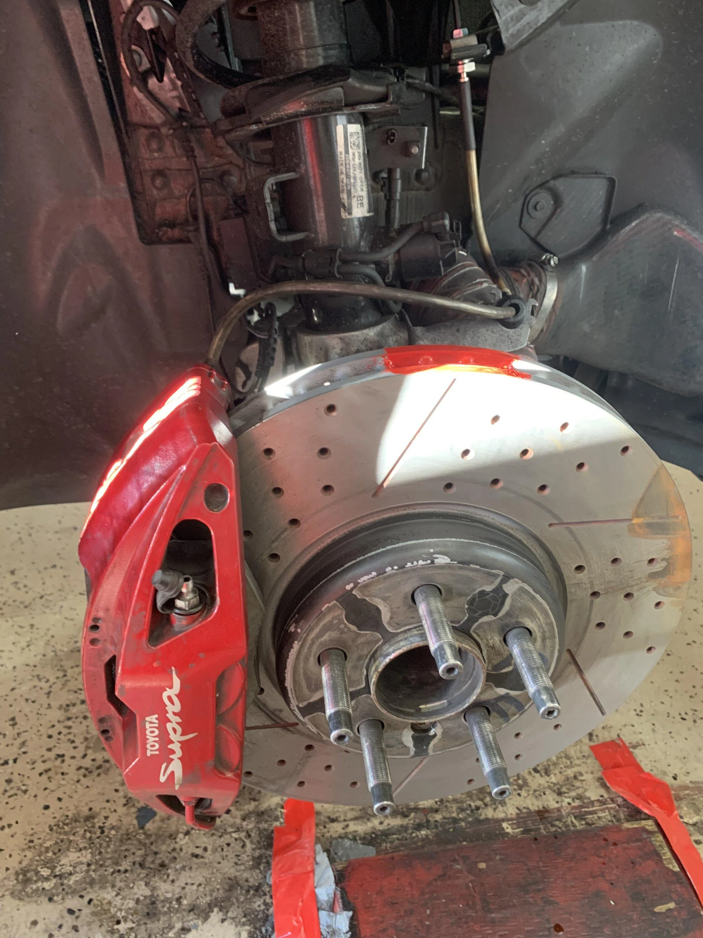

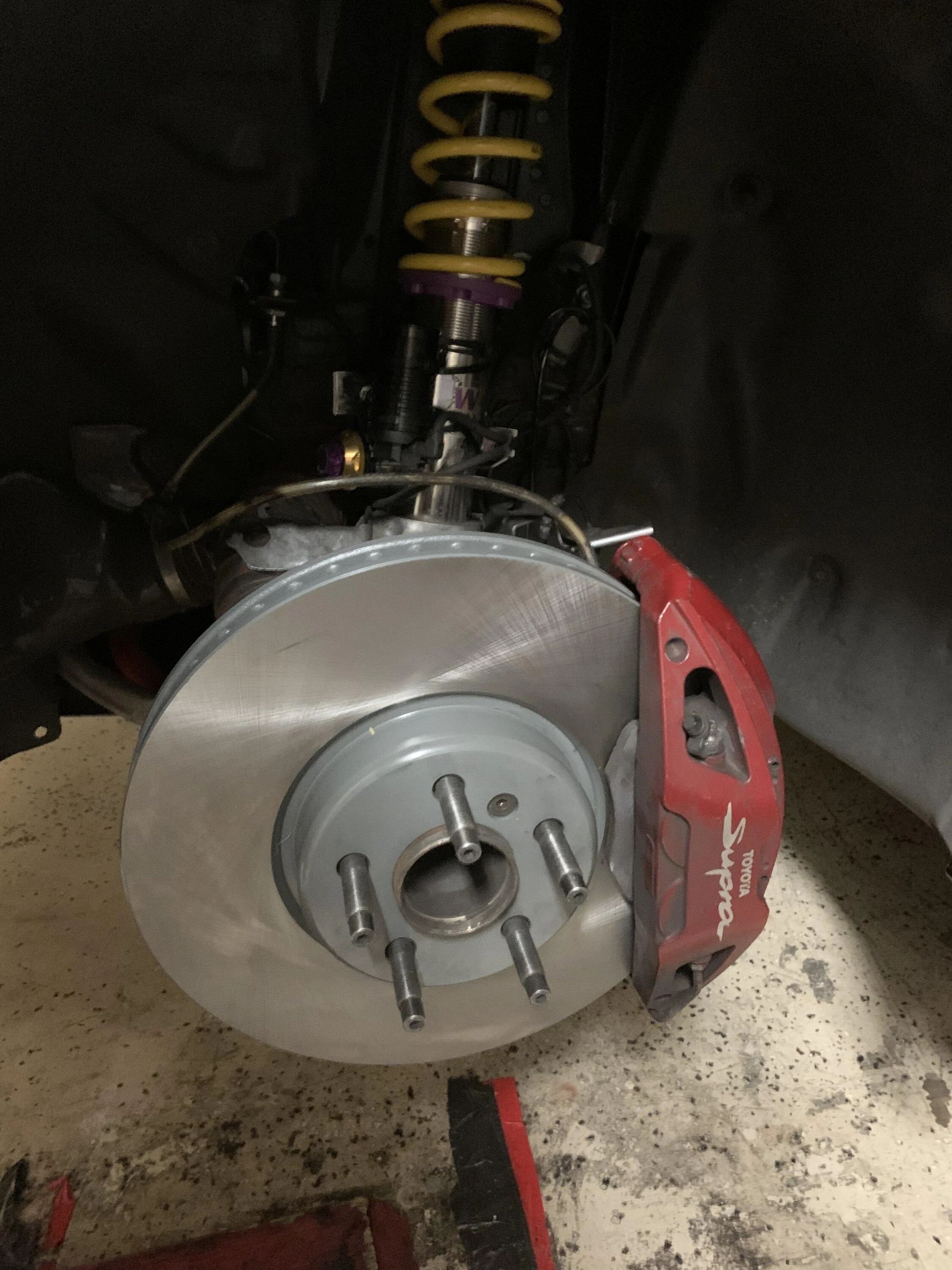

It's probably been said, But your issue was likely uneven pad deposits from not bedding the brakes in properly. I've had this problem for the same reason once, I took some sandpaper to the discs and removed all the pad deposits. Problem solved. I made sure I bended them in right the next time ?
The odds of a rotor actually warping are pretty much zero
It's probably been said, But your issue was likely uneven pad deposits from not bedding the brakes in properly. I've had this problem for the same reason once, I took some sandpaper to the discs and removed all the pad deposits. Problem solved. Make sure I bended the men right the next time ?
I remember doing this with a drag car guy, buddy, long ago. Was thinking, wtf… But it worked! Great reminder/suggestion!!!!! Thx @kaj ?
Certainly doesn’t hurt to try
