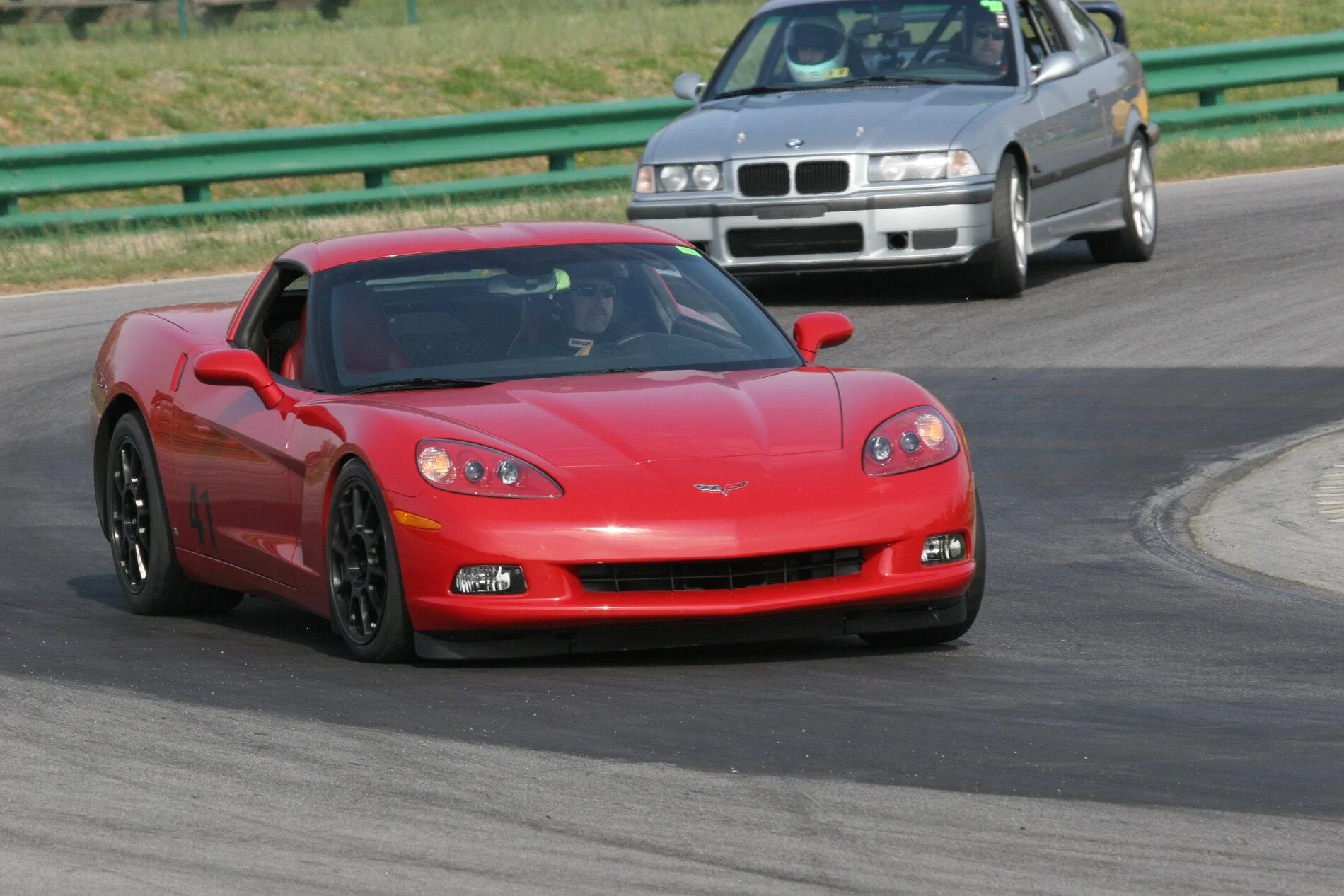

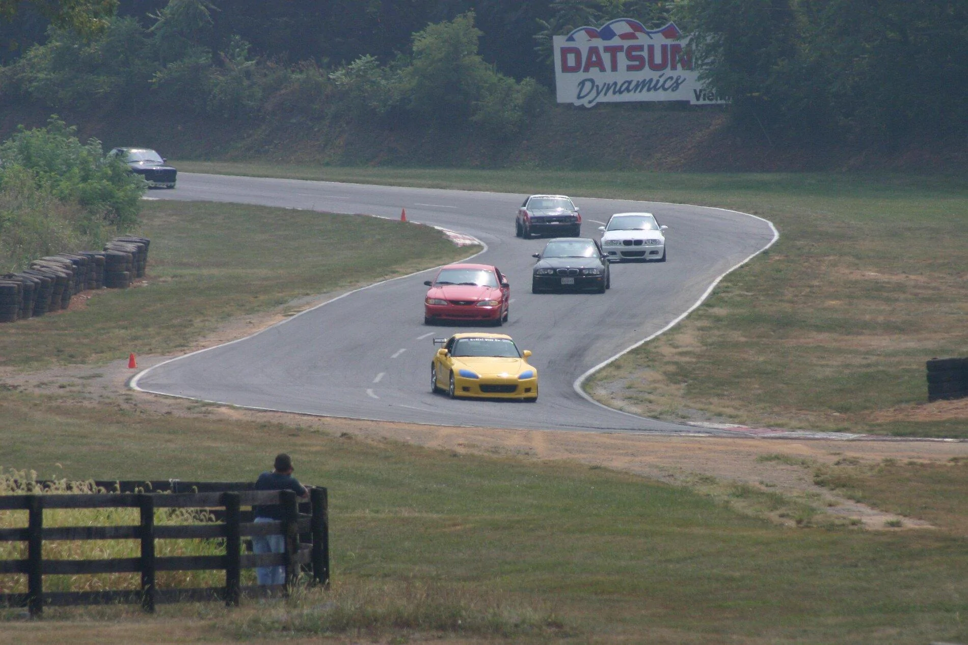

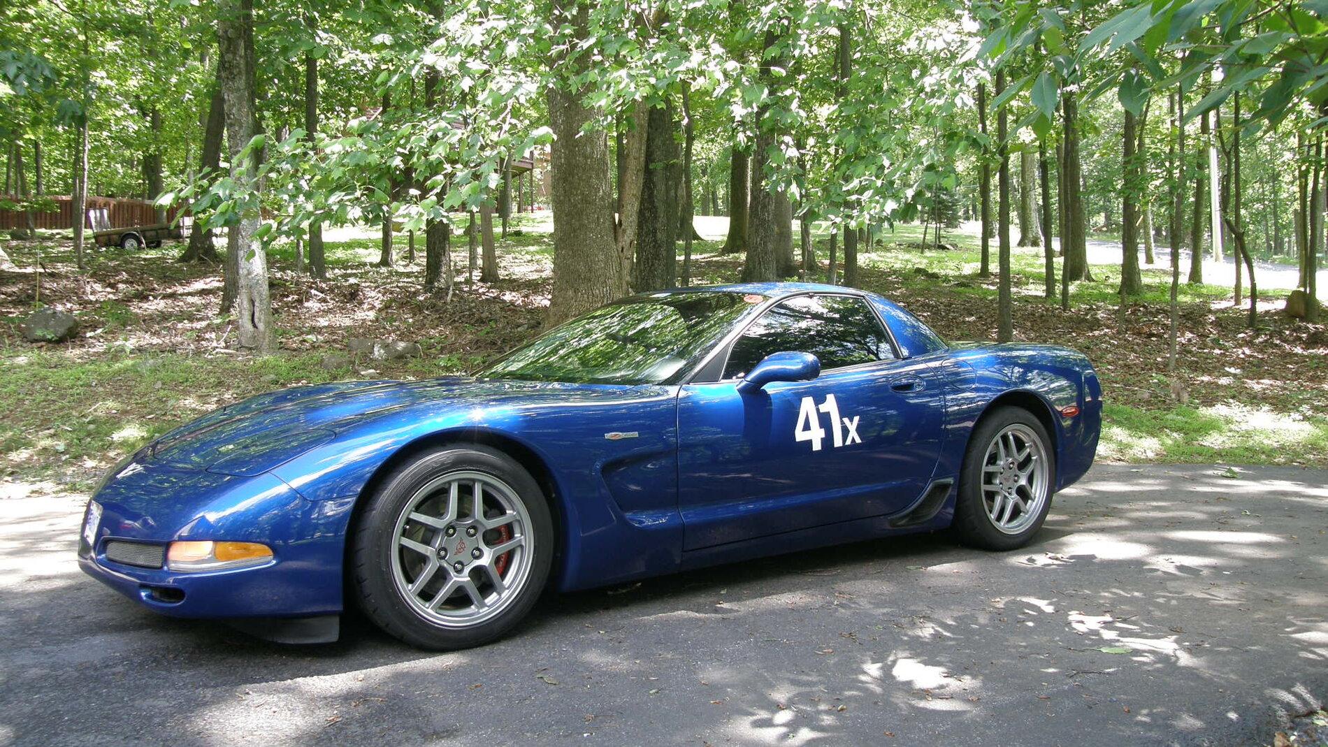

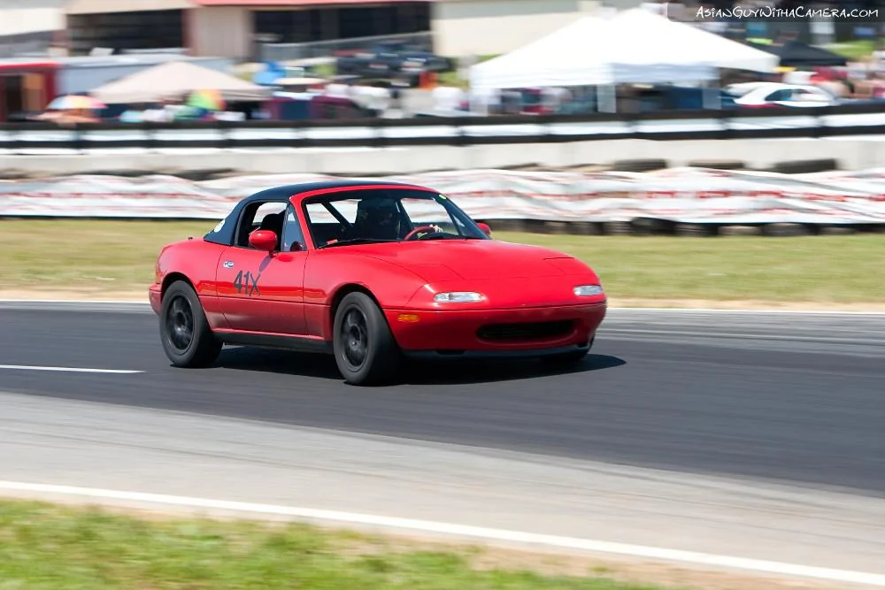

I had a few other track cars over the years, 2 Corvettes a S2000 and A Miata. The Miata and S2000 were caged with race seats, the S2000 had a rear wing.
