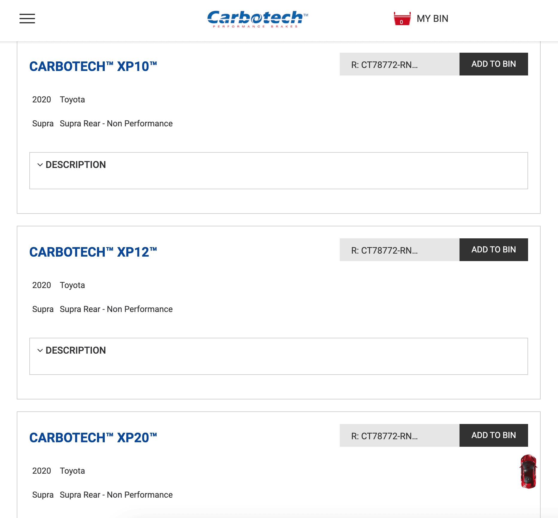

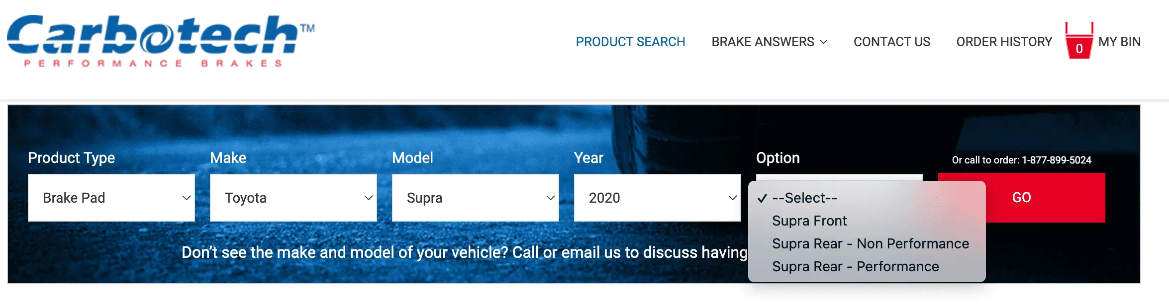

Where did you find them? I've searched for carboTech and G-Lock and found nothing. I would like to run the XP-10 (IIRC) on the rear.
From the carbotech site:
I have an email out to them asking them if non-performance means base model. I was hoping that would be the case.
I'm assuming that is the case because they are the same pads in each view, just different part #'s. So it's not just non performance vs performance pad compounds.

Thanks to @Afterfire and @razorlab, I finally found pads for the base model. Carbotech has them, which is my favorite pad anyway.
CT78772-RNP-
Then follow up with the pad compound you want. I.E.:
CT78772-RNP-xp10
CT78772-RNP-xp20
Etc
Thanks to Afterfire for the breakthrough!

I think you might be wrong. The RNP is for the base rear brakes “NP” is non-performance according to the site and what @Afterfire has on his invoice. Also check out my screenshot.
