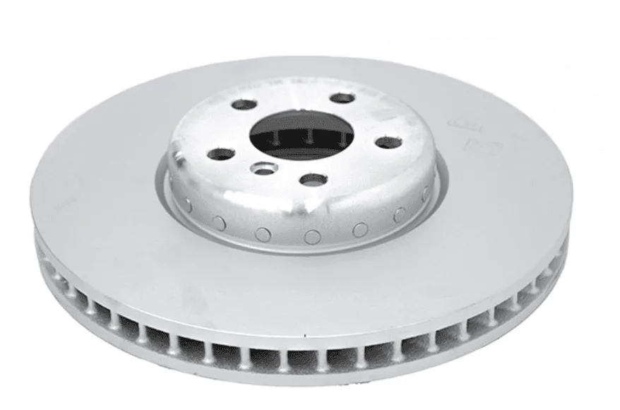

Because they are 1 piece and the other things @kaj mentioned.
The OEM rotors are 2 piece with an iron disc pressed into an aluminum hat.
Ah okay I understand a bit better now. So the two piece has the benefits of lightweight aluminum hat, with the benefits of iron breaking surface
This is why I see two different price tiers? Two piece seems more expensive.
Yes, harder to manufacture, higher performance, more expensive.
