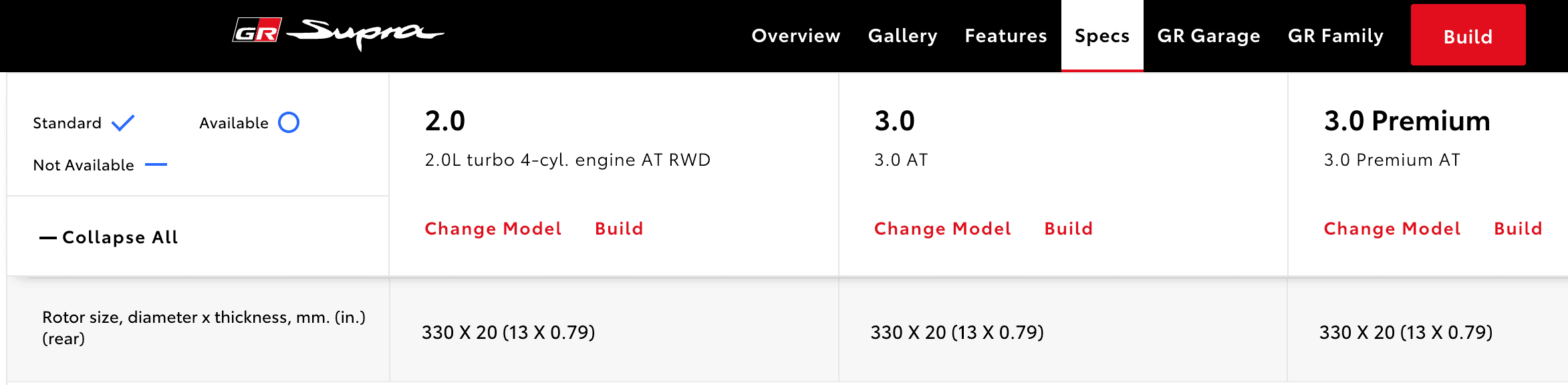

Another issue with confusion here is that even Toyotas website is wrong on the specs. Currently states all models have the smaller rear rotors, which we all know is incorrect.
