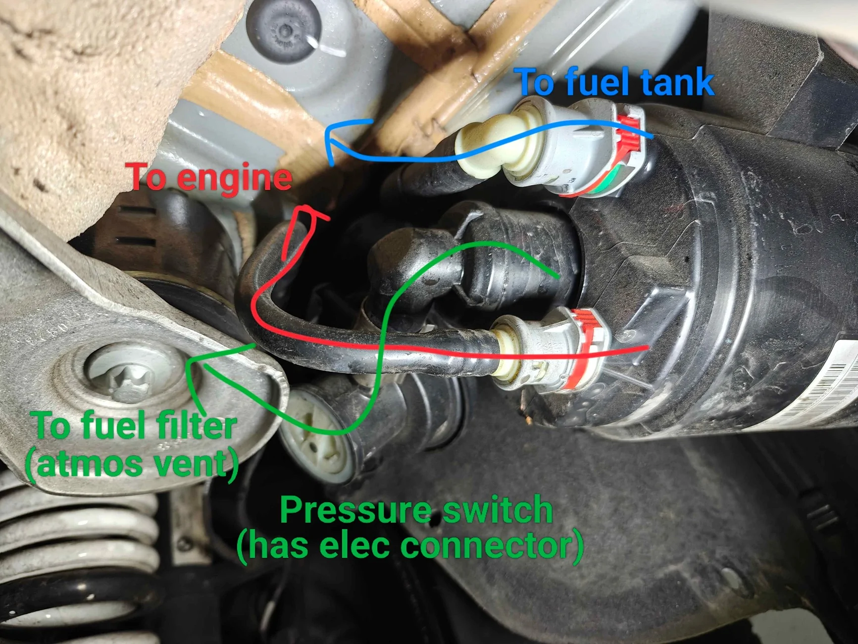

Yep I got a few evap leak codes that were easily cleared/ignored. I don't know if or why removing the canister is related to the fuel starve but I just got this problem right after removing the canister, and the canister vents the tank, which has a pressure sensor built in, and a jet transfer pump etc and it seems like everything is connected somehow on modern cars 😭

did u just do a delete and not reroute anything?

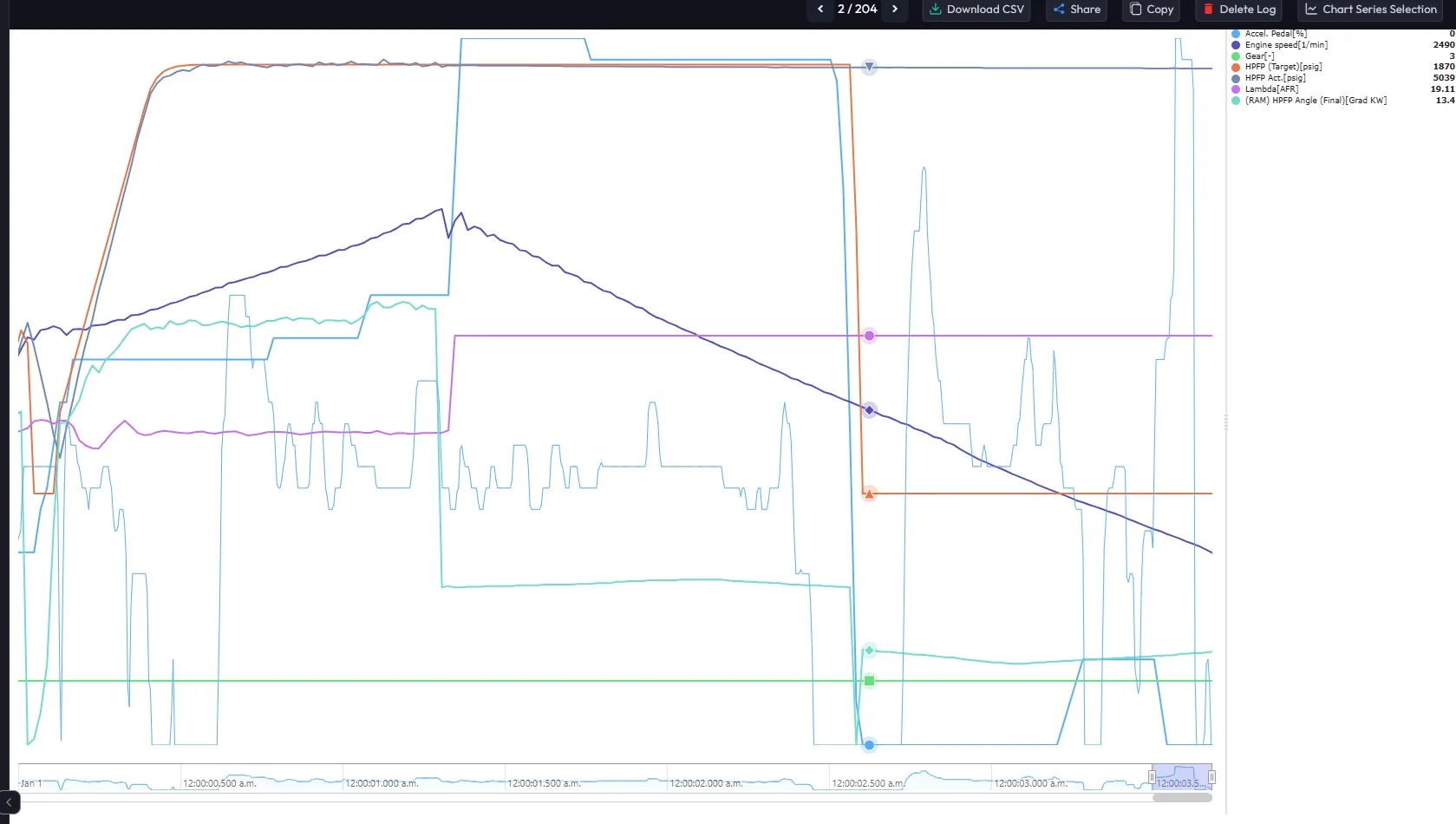

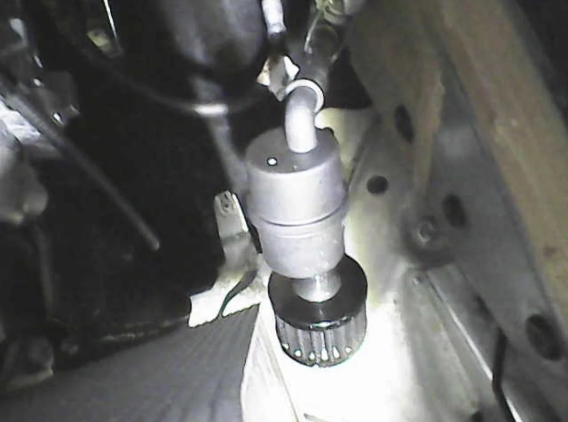

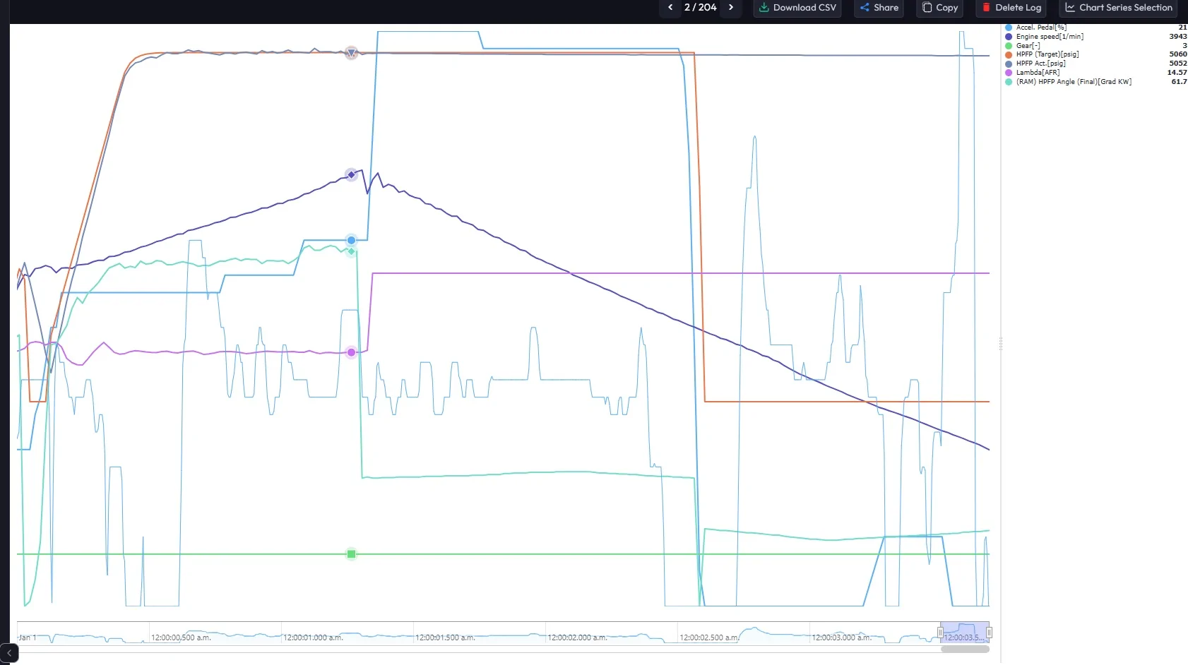

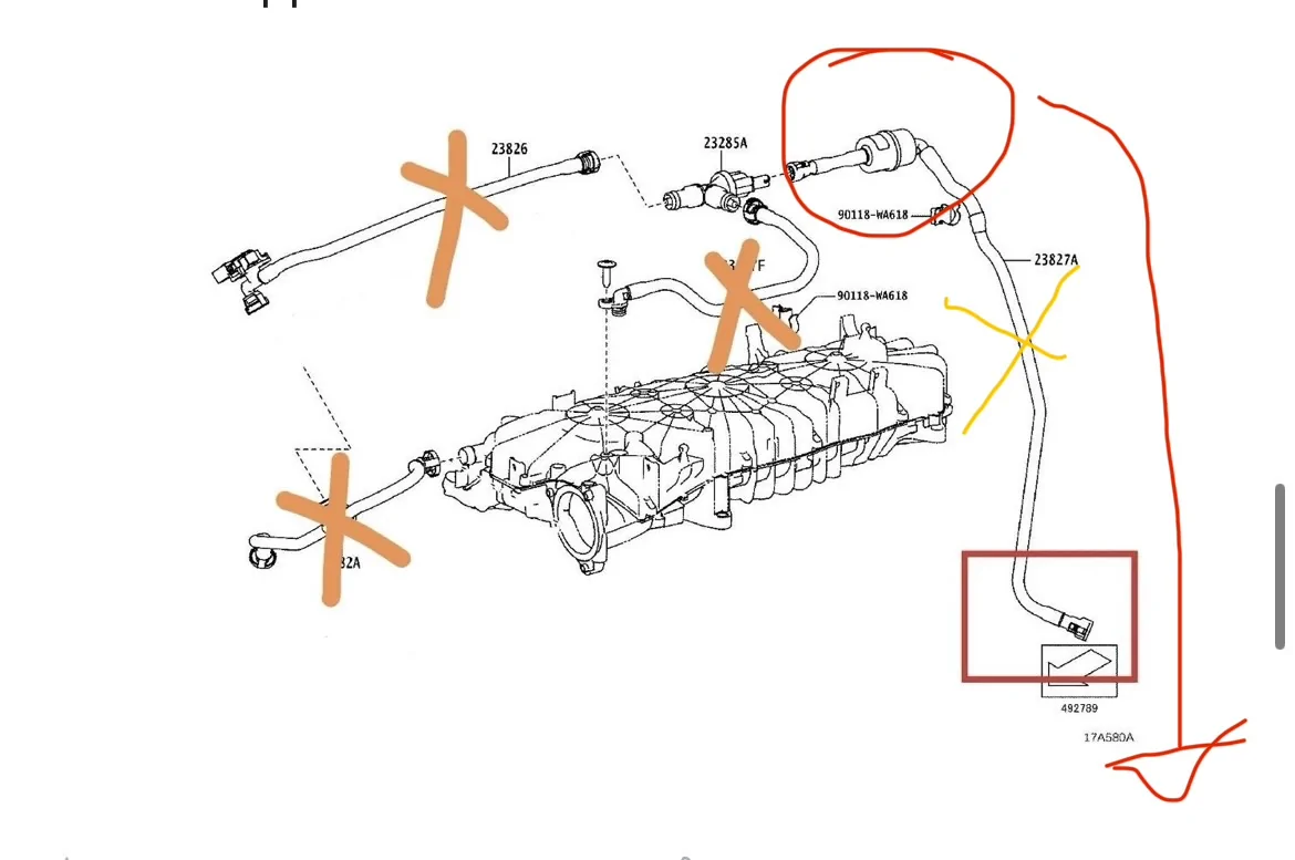

Just an update on this in case anyone else wants to do the same canister delete. I drained the tank and pulled the lpfp inspected everything and it looked okay.
Kept the canister delete by putting a filter on the tank vent line and capping the first purge solenoid in the engine bay with a vacuum cap.
Fuel starve issue seems to be gone after draining the tank removing the lpfp and putting it all back together. No idea what caused the original fuel starve 🫠 but draining the tank seem to fix it
