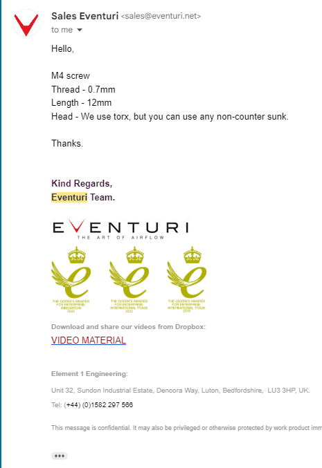

Picked up an eventuri intake that’s missing the screws for the MAF. Their parts list say “M4 MAF screws” and don’t mention the threading (which is different than the OEM screws). Does anyone happen to know the threading for them? I picked up some 32 TPI screws and they look close but there’s significant resistance when starting to screwing them in by hand so I’m concerned about stripping
edit: I’ll be picking up a tap/die set tomorrow to check for myself. I’m praying these aren’t proprietary to eventuri otherwise I may just have to tap it myself and make do. But if anyone has any insight it’d be much appreciated

M4 bolts only come in X 0.7 from everything I've ever seen
Those 32 TPI are SAE and will destroy your shit. One awesome common source for them is those ribbon-bagged hardware packs that come with TV wall mounts, which is why I always save them. Do you have any stashed somewhere?

Brain fart on my part lol. Forgot that these are definitely metric, thank you for calling that out
Here you go
