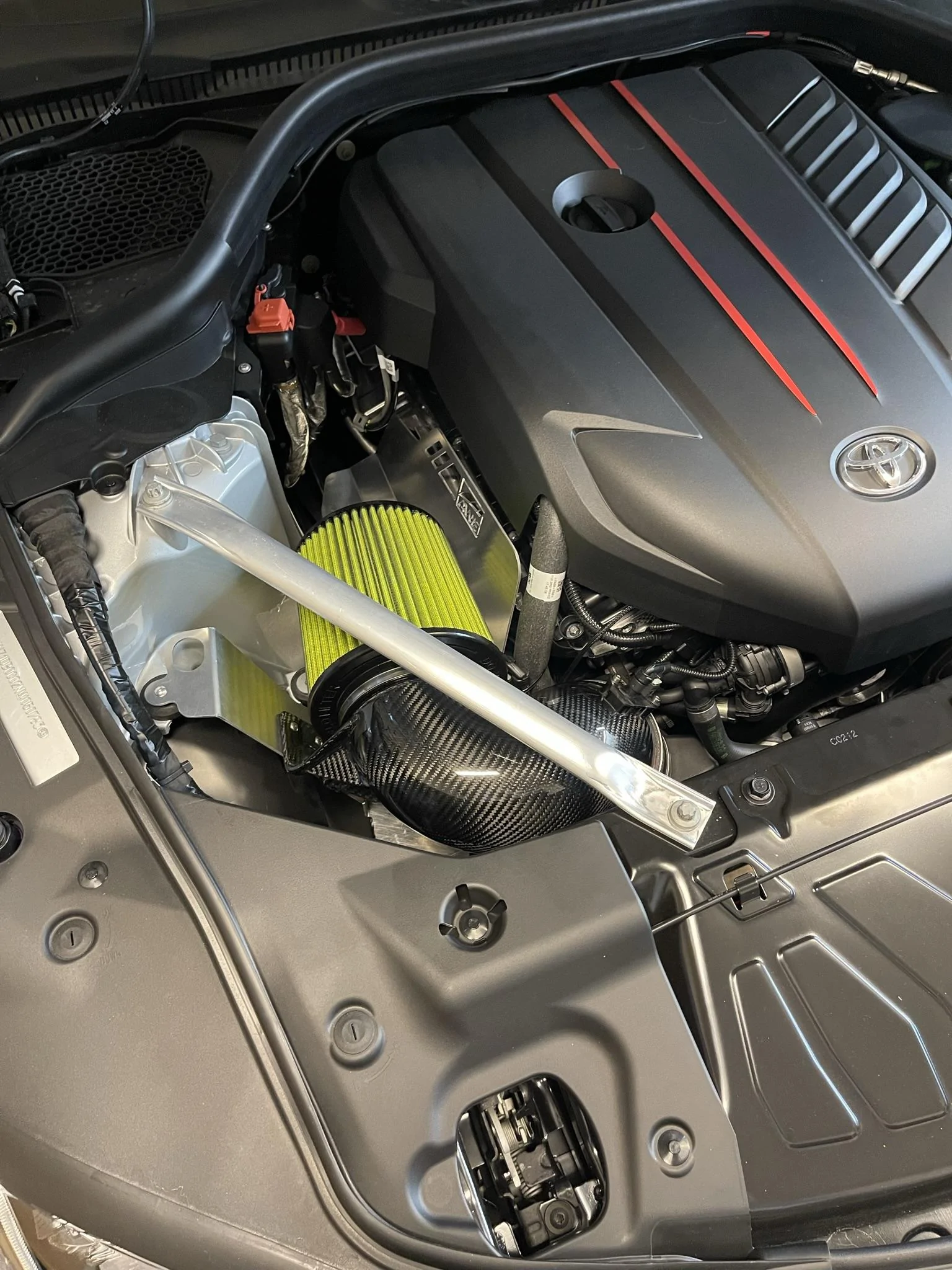

I have a 2021. I installed an ingen EVO2300 intake and an Mishimoto 3”charge pipe. These items increase the sound a little bit. It sounds great. Also in my opinion it made the car more responsive as well. I spent about $600 for both. It was worth it to me. These are the only mods beside an oil catch can from burger Motorsport tuning I have on the car.

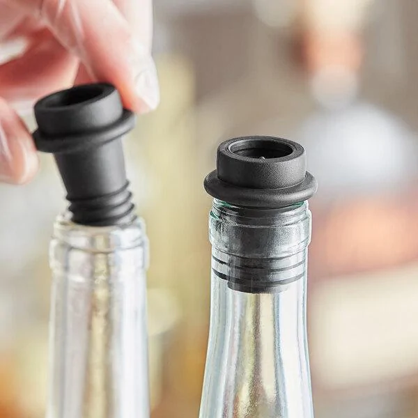

FYI, if you really wanna be cheap, you can pick up a plastic or rubber wine bottle stopper and simply plug the resonator inlet hole in the airbox lid. The resonator box will stay where it is, just no longer dampen the turbo hiss noises. Also, remove the acoustic foam from the bottom of the airbox under the filter. Drop in a high-flow filter and you're off to the races!
A few folk have recommended that kit, but can't find any videos online :(
