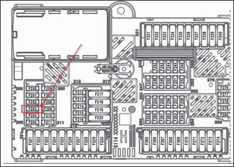

There is a fuse that controls the flap. Check that to see if it is blown. It is in the trunk in the little compartment on the right side. Here is the layout and I boxed it in red.

Hi,
I checked my fuses as suggested above, all good.

I had the backbox mod done and have also removed F203 fuse as posted above to keep the flap open. No issues. You could also just keep the cable unplugged to the valve. Doesn't make a huge difference to our UK cars as the flap is open most of the time anyway.
