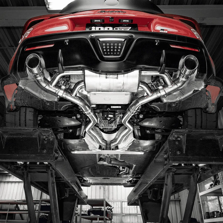

iPe also has what you're looking for. I got a reference image
