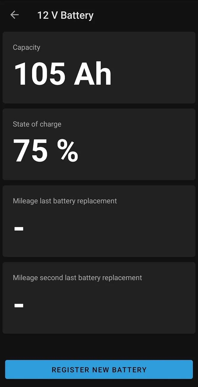

Anyone know why I failed my emmissions inspection? Inspector says it was the battery, but bimmerlink shows 75% charge. Mods: AA catted DP, AWE track exhaust, MHD+ OTS Stage 2 (93 oct). Any help is much appreciated.

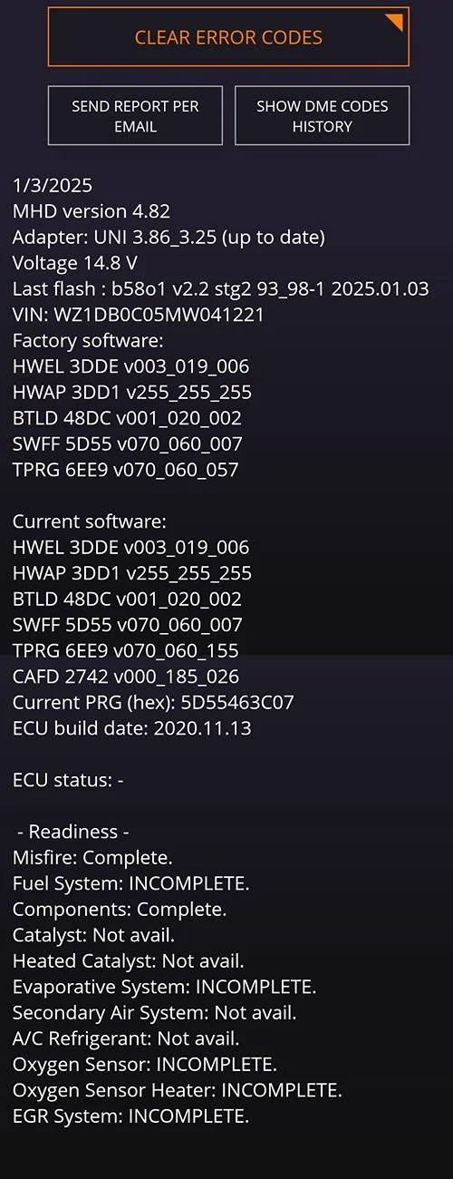

Did you clear any codes prior to taking it in? If so, you need to drive the car about 50 or so miles in order for the systems to complete their checks.

It seems your emissions systems like evap, EGR, etc. aren't ready, you'll need to drive it until it's ready. Did you tune out the cat too? It says your cat is not available.

I'm gonna try flashing map0 and running it for 50 miles. Hopefully I'll be good, then.

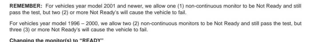

That inspector is an idiot. Failed because of battery LOL.
The reason I see based on the paper (without asking what Mods are on the car) is because you have more then 1 "not ready" status.
You have to drive the car for a few days so that status changes. If you keep flashing tunes you are pretty much "resetting" these sensors in the cars eyes.
Source: I did state inspections and also the TX state inspections site

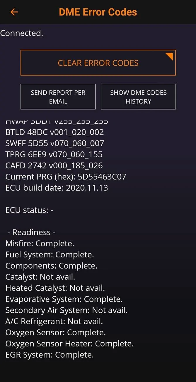

I flashed map 0 about 70 miles ago and the cat is still in the "Not avail" status. Any ideas? I have an AA catted DP (400 cel) w/no cel, so i should be good.
Yes, you should be good to go, "not available/ not supported " is not the same as "no ready".
The not ready status is to avoid people from disconnecting the battery right before an inspection to temporarily get rid on the CEL.

I'm good now. Passed. All i did was flash map 0 and drove for about 70 miles total, between 10 or so drive cycles. Just don't clear any codes like i did. If your ecu status looks like mine, then you should pass.
