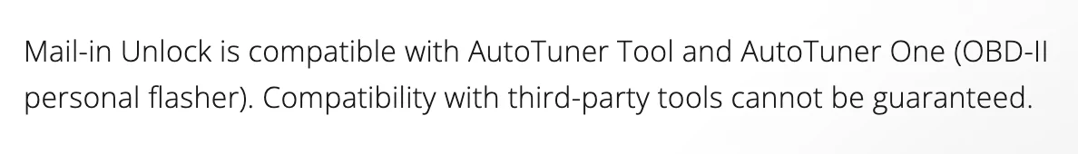

I wouldn't be so matter of fact about #2 yet. As I stated before, AT also states that they don't guarantee that other tools would work to flash their unlocked DME's and we all know they work just fine.

100% agreed, I was just trying to condense what we officially know. I also suspect the other tools will work just fine BUT we don’t know how the unlock methods may differ behind the scenes. Until somebody tries it, we can’t confirm so as of today, I have to take Autotuner at their word it doesn’t work and not try it. As for the flasher method, they soften the language to say can’t guarantee and I think less risk of messing anything up so I felt better about that.
