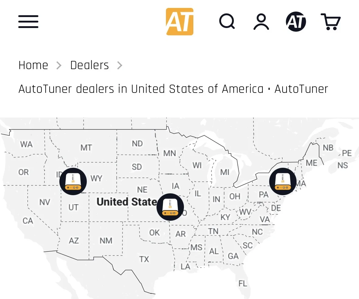

I heard back from autotuner directly who said bench unlock after the full unlock should only be done by autotuner tool (which is like $6k but meant for shop use). I’m up in MI and no shops close (even the new one in Alabama). So if dealer relocks it, it means sending it back out to a dealer or autotuner. They did say they are working to rapidly expand the dealer network.
With that said, seems like Femto might still be the better option if you don’t live near a dealer and mailing it back out is a concern for you. Femto doesn’t limit the tool to bench unlock and if you don’t live near a shop that has an unlock tool, you can just buy the MHD one for $450 and never worry about it again. If you get relocked 2-3 times, it pays for itself. I’ll prob go that route.

Autotuner announced Auburn, AL. I haven’t heard from Femto.
It appears the Auburn, AL is for product distribution for now. Hopefully they announce something about their US Unlock mail ins soon.

Autotuner confirmed by email thats where they will operate out of for mail-in unlocks and will be fully operational by time of announcement. But they wouldn’t share any additional details, only saying details like pricing etc will be announced Feb-Mid

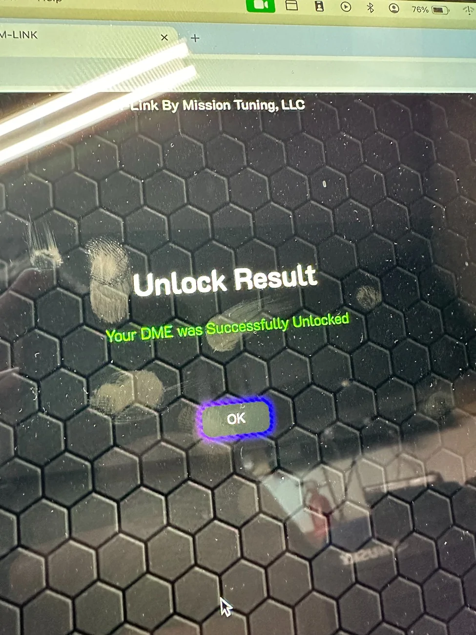

I've used the Mission Unlocker with good results. Super fast and easy.
That’s great to know it works well…it’s about $100-$150 cheaper than MHD tool if I recall, so solid option!

2) If you are post-2020 DME and had AUTOTUNER full unlock, you’d need an Autotuner shop to regain access via bench unlock. Per Autotuner directly, only their tool will work to bench unlock it should dealer relock after service. There are currently 3 authorized shops in US that can do it so you might have to mail it in if a shop is not close. Is it possible Autotuner is “just saying that”, yes - but nobody has posted that they tried using the other bench unlock tools on an autotuner unlocked DME. I’m not gonna be the guinea pig and risk damaging a DME….
