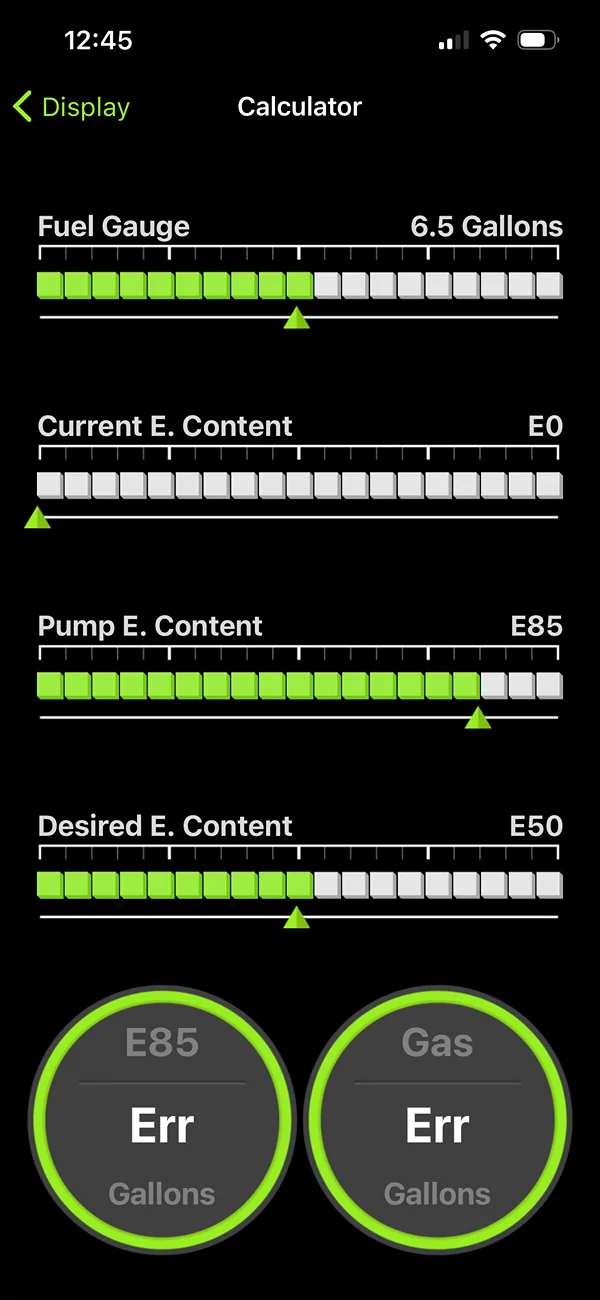

Had Fuel-It and now MHD. No issue with either. The Bluetooth and Fuel-It app is nice and include E calculator

You can view ethanol % via the dash, no need for an app.

BM3, MHD, and MGF you can see it via the tach with steering wheel controls. Ecutek, your tuner can hijack the torque/hp gauges on the center screen to display ethanol percentage.
Reality is that you shouldn't have to check it very often so any of the above are a good solution.

It depends a bit, in relation to the frequency.. I mix at home, with 20l cans I have with e85.
I use Chat GPT to do the math, for the mix, but I always verify - on the dashboard after doing the mix.. Again, I've had no surprises, but its nice to see if I hit the expected E35, I usually go with.. :)
