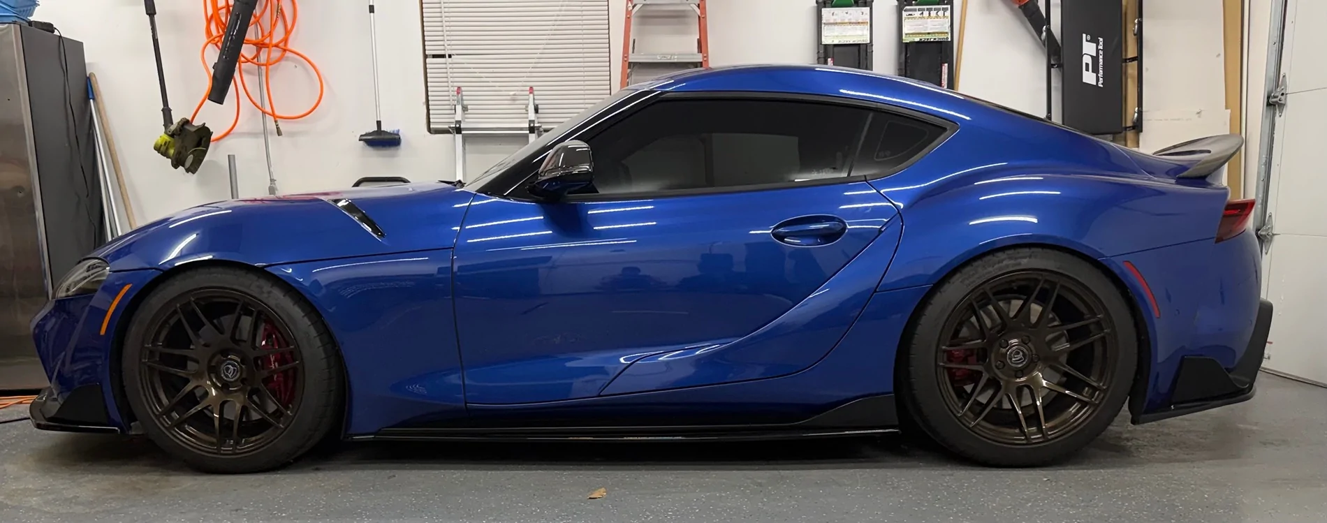

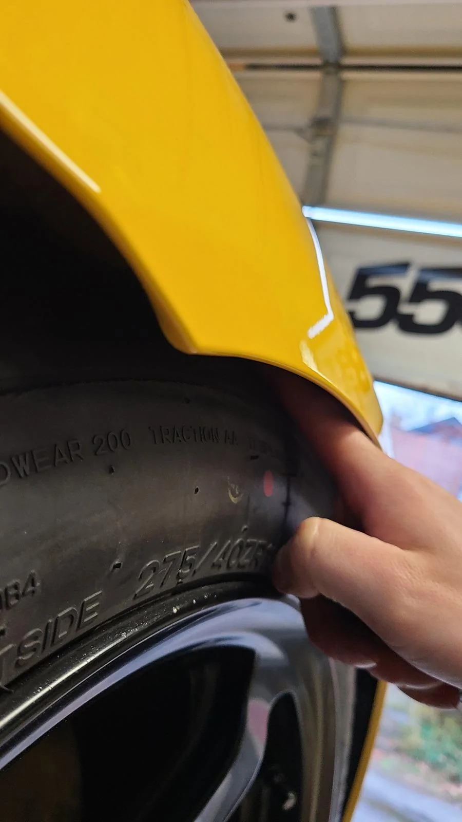

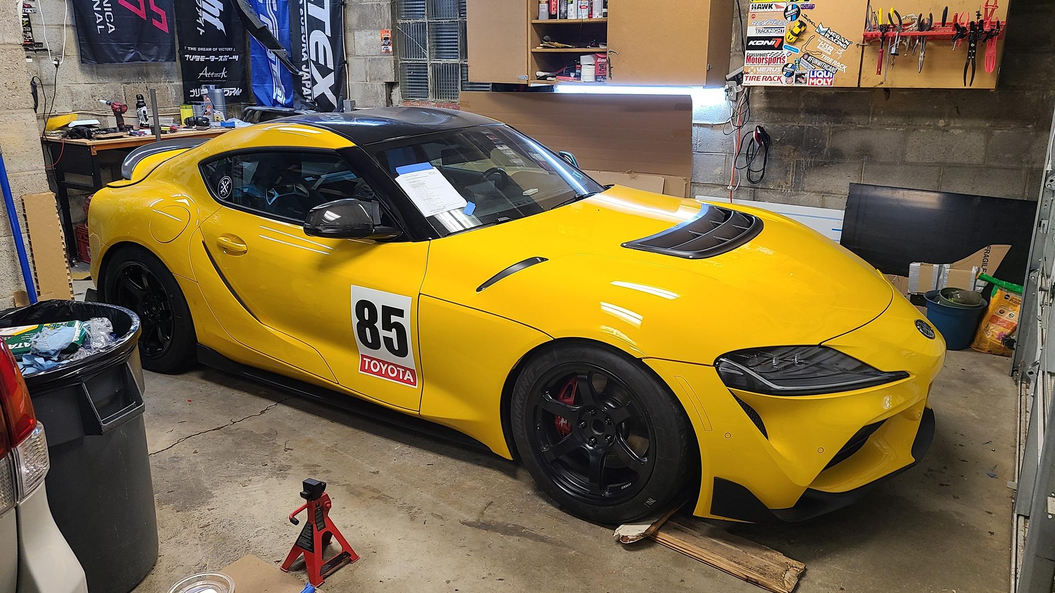

Here is the car at maximum height in the rear with 305/35s rear. Front is 275/35. The fender front and rear are the same height from the ground. Going to raise front about .2” and rear .5-.75” when spring perch spacers show up (aiming for same gap, but the rear tire is taller so a small rake).

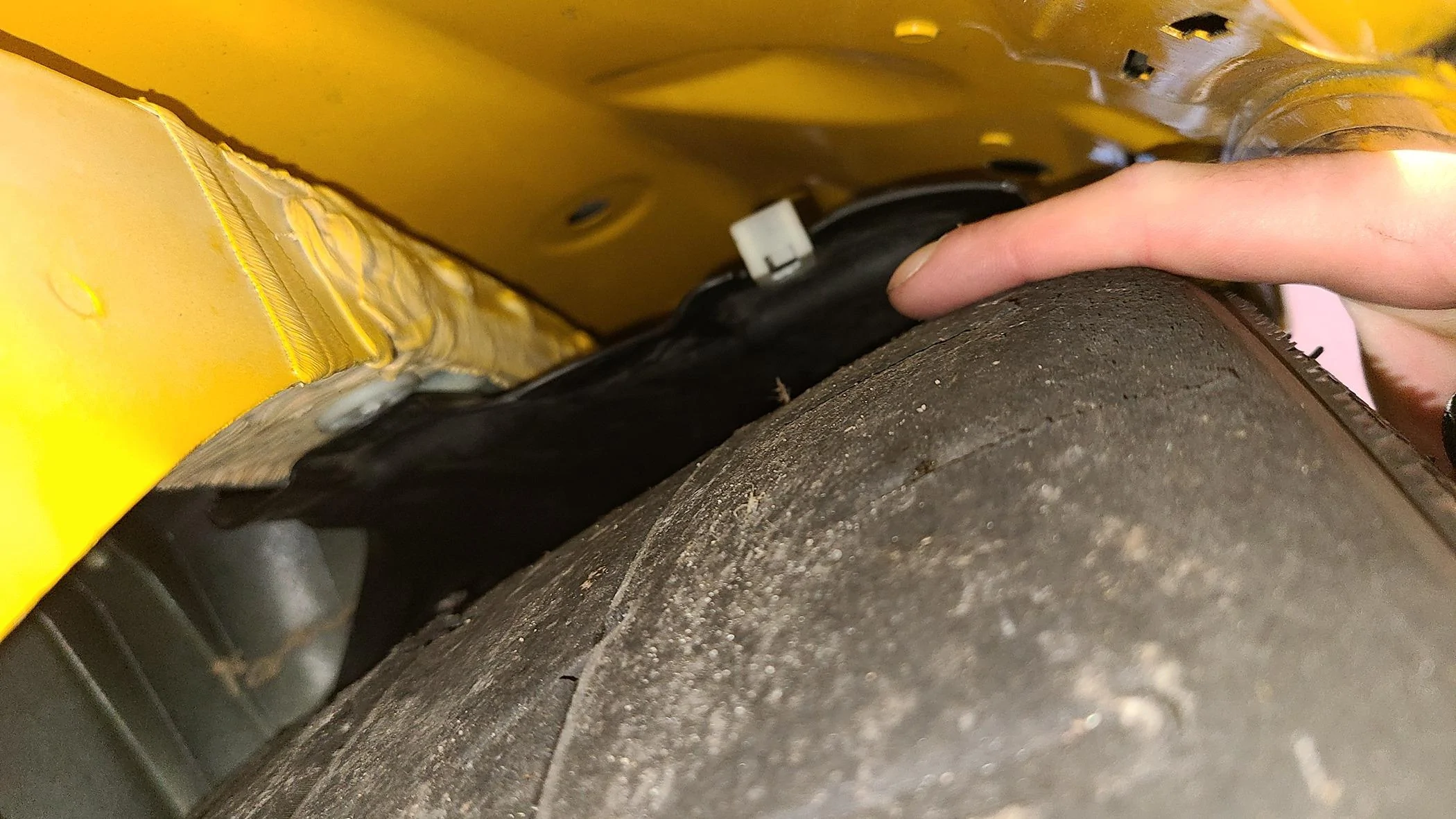

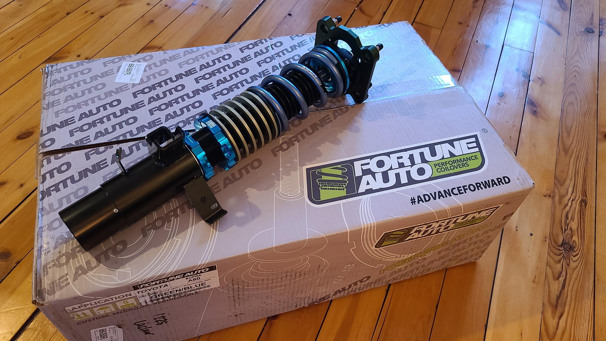

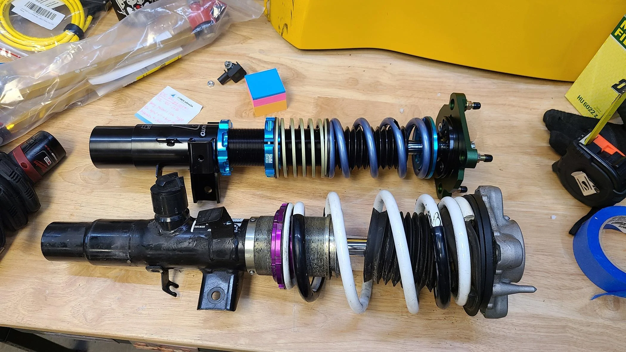

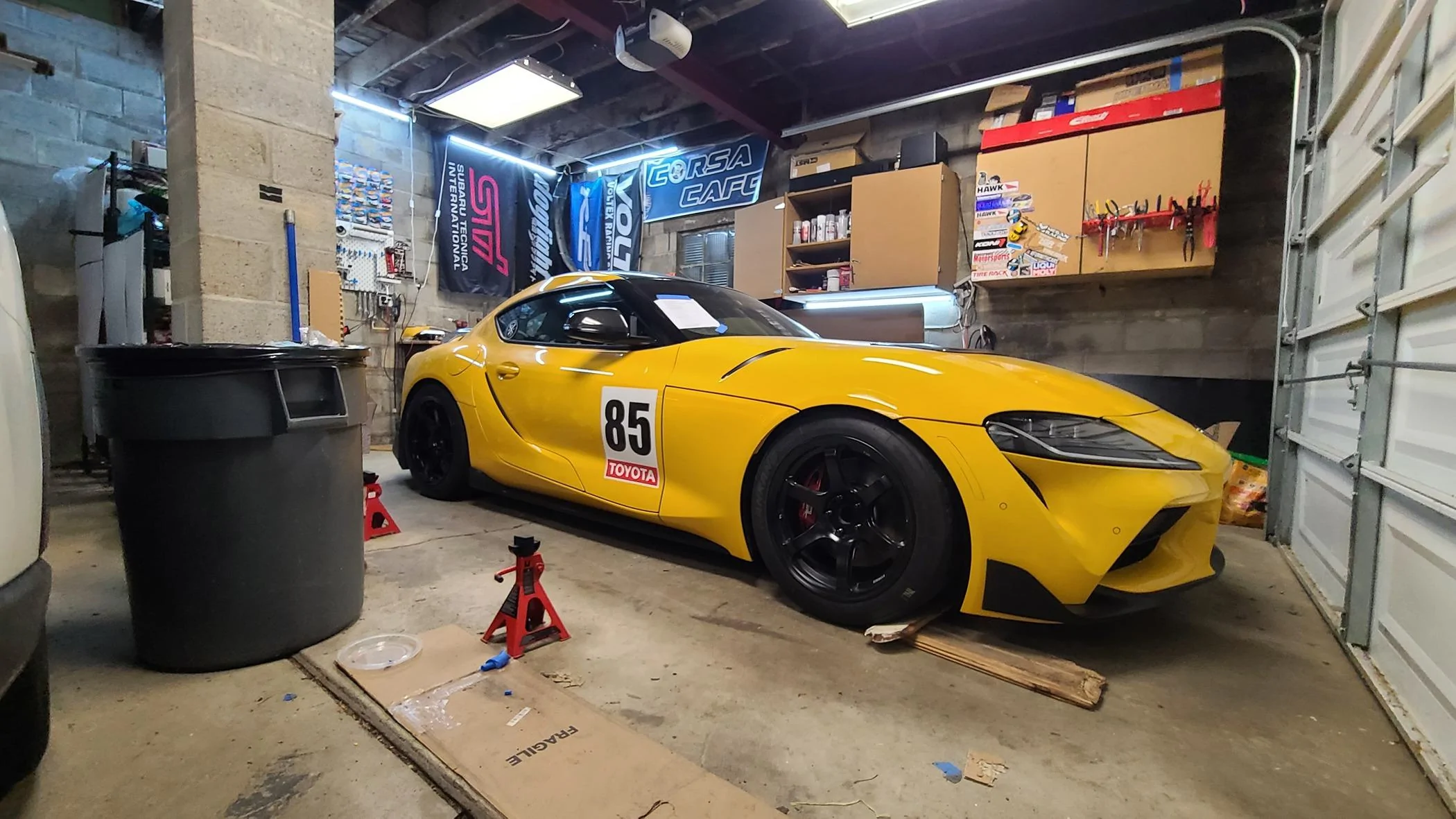

Finally got around to installing my Fortune Auto 510 coilovers this weekend as they've been sitting in my garage the past couple months. Initial driving assessment - big fan compared to Stock strut + Eibach Euro lowering springs. Over the years I've always gone lowering springs for my cars and this is my first time going with coilovers so I was concerned about the comfort and my conclusion after install is there was nothing to be worried about there. Handling feels noticeably improved (shocker I know..) and I would say comfort feels neutral to better (except for the large bump bounce noted below). I never loved the ride with the Eibach's.
Now the bad:
- I specced these 8/10k which is lower than most here. This is primarily a street/canyon car so all goals were to maintain comfort and what was recommended from the shop I ordered from. Doing again I'd have gone 9/12 or 10/14 (ordered before the more recent posts saying to go higher). The rear over large bumps has more bounce than I'd prefer, which I believe upping the spring rate would reduce. I may just need to play with the dampeners though currently at 10F/12R so I'll be upping the rear to 18 next time I jack up the car. I think its mainly the rear. Seems like I could just order a 12k or 14k spring to swap out the rear if I can't dial it in.

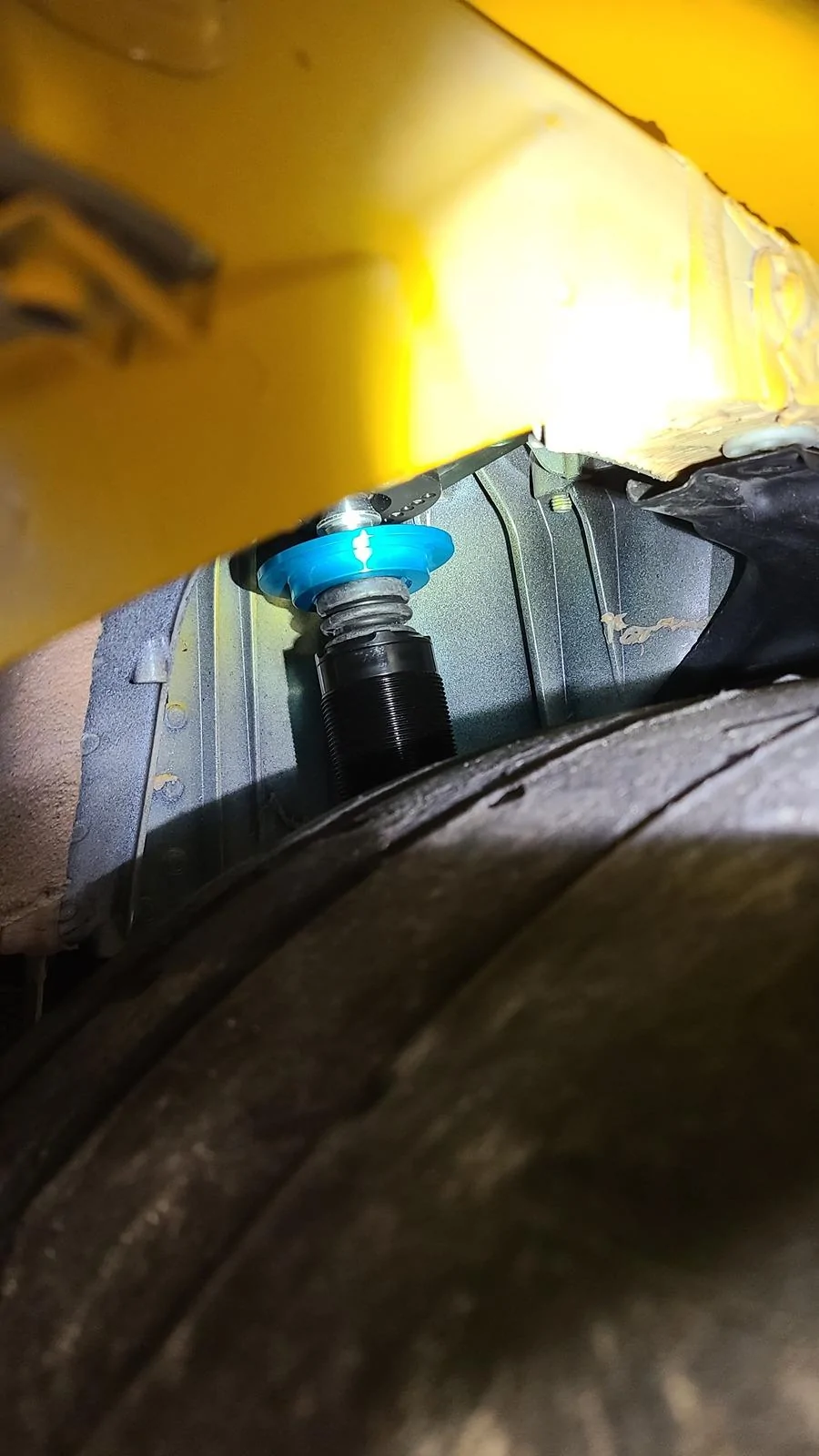

- I run 305/35s and rubbing over bumps was the main reason I moved to coilovers and I was hoping to raise the car close to a two finger gap. Plenty of adjustment remaining on the front up or down but on the rear I'm at max height and I'd like to be 0.5" - 0.75" higher so it looks like I'll need to buy and install the spring perch @rwense pointed out. Which sucks because that lower control arm bolt is my nemesis (on re-install...maybe 3rd time is the charm). I'm at roughly a one finger gap and 27" ground to fender with these meaty tires and still getting some rear rubbing on compression (but was significantly reduced).
I will try and remember to take an actual pic of the car to post when I'm in the garage later today.
