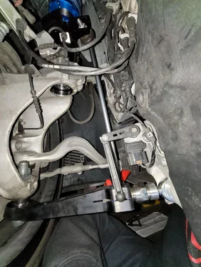

How much lower are you? You can also attach the sensor arm ball joint directly to the SPL arm without the bracket.

Thanks guys! I did not think to attach directly to the arm without the bracket. I guess the threads on the ball stud are compatible with the LCA tapped hole? I did modify the black plastic bracket and used the middle hole to mount the bracket to the arm which effectively allowed me to lower it. But I like the direct connection idea better ?. Thanks for the pic. Ideally SPL should have made an adjustable ball joint assy (like someone did on this forum) as they never know the height and should know most people lower the suspension.
SPL sent me a new style bracket that "guarantees" the sensor to be OEM height but that was useless because I am lowered.
Have to take out tomorrow and check for chassis message. I'm on the adjustable HKS Hipermax springs used them as they came out of the box so I think they are ~ 1" drop. Had lowered the car first - no chassis error. Added the all the SPL parts and now have the error. Thanks again!
