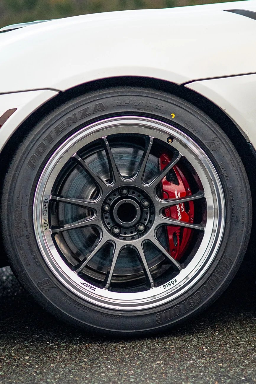

Hey everyone!
Just replaced the front brake pads with Hawk DTC-60 and the rotors with Zimmermann Coat Z (single-piece). After a few track sessions with braking from 140 mph, I’m getting some judder that goes away once things cool down. I suspect the rotors can’t handle the heat. Any advice on whether I should try the Zimmermann Formula F (two-piece) or just go straight for Girodisc?
