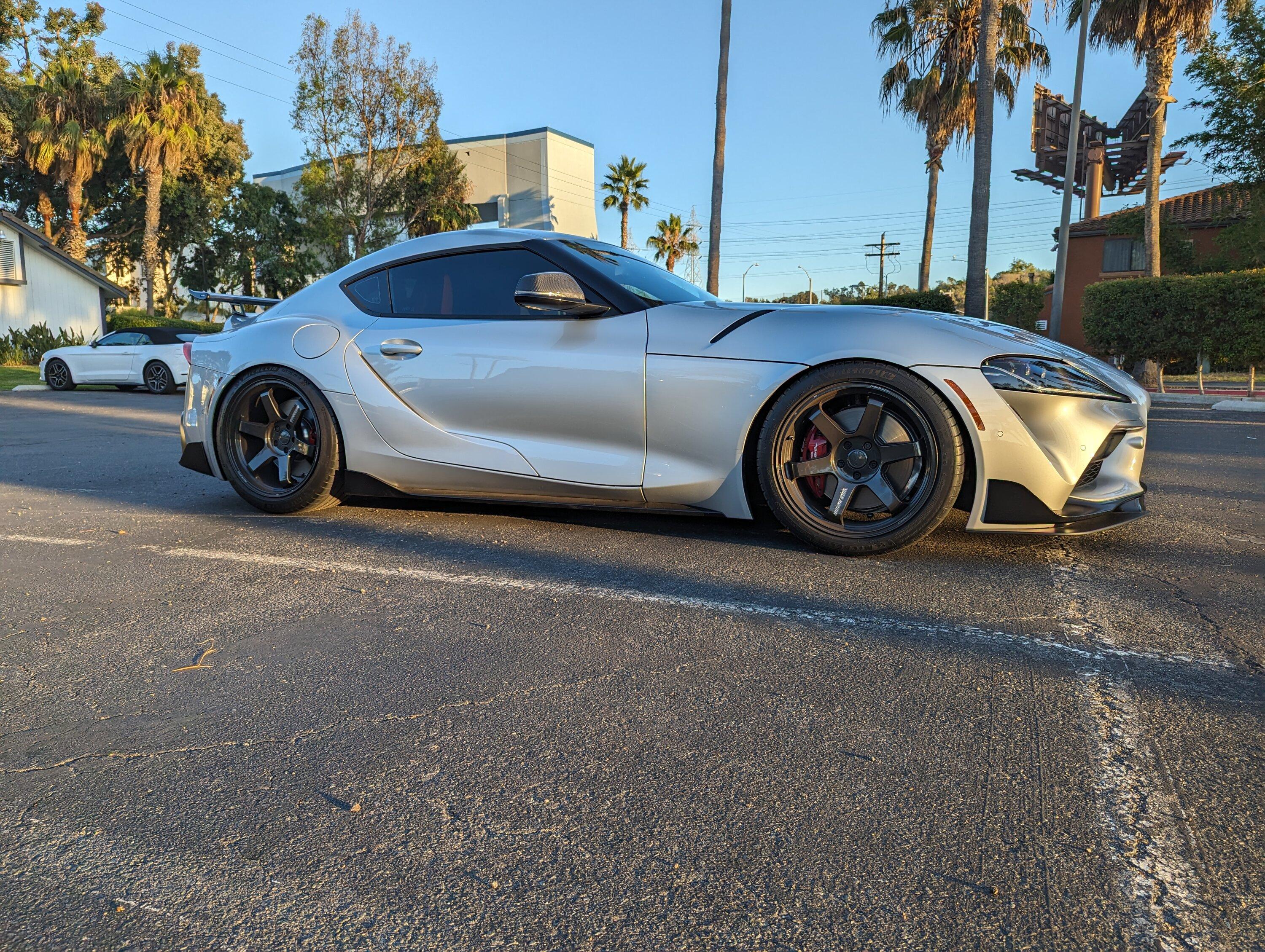

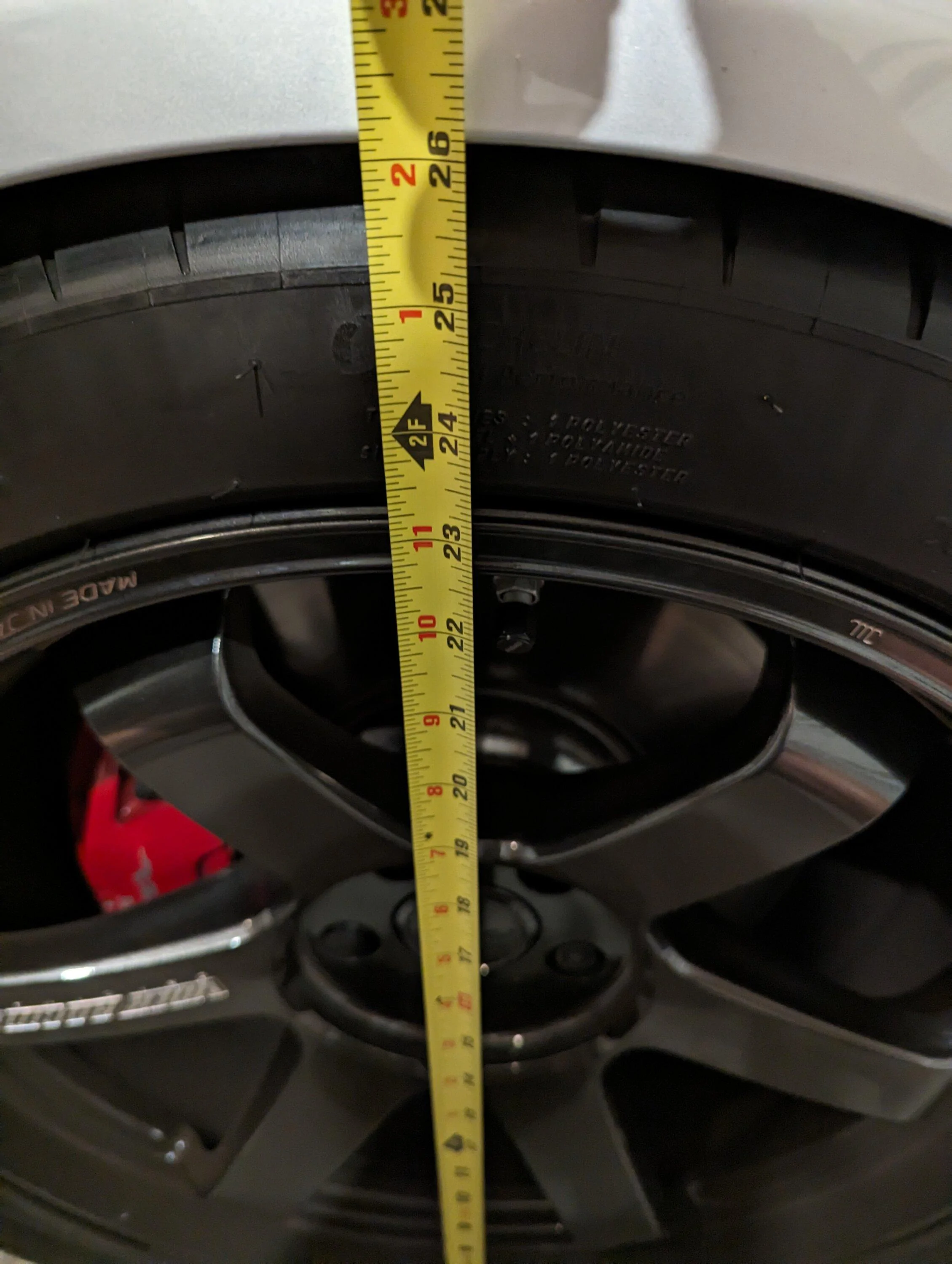

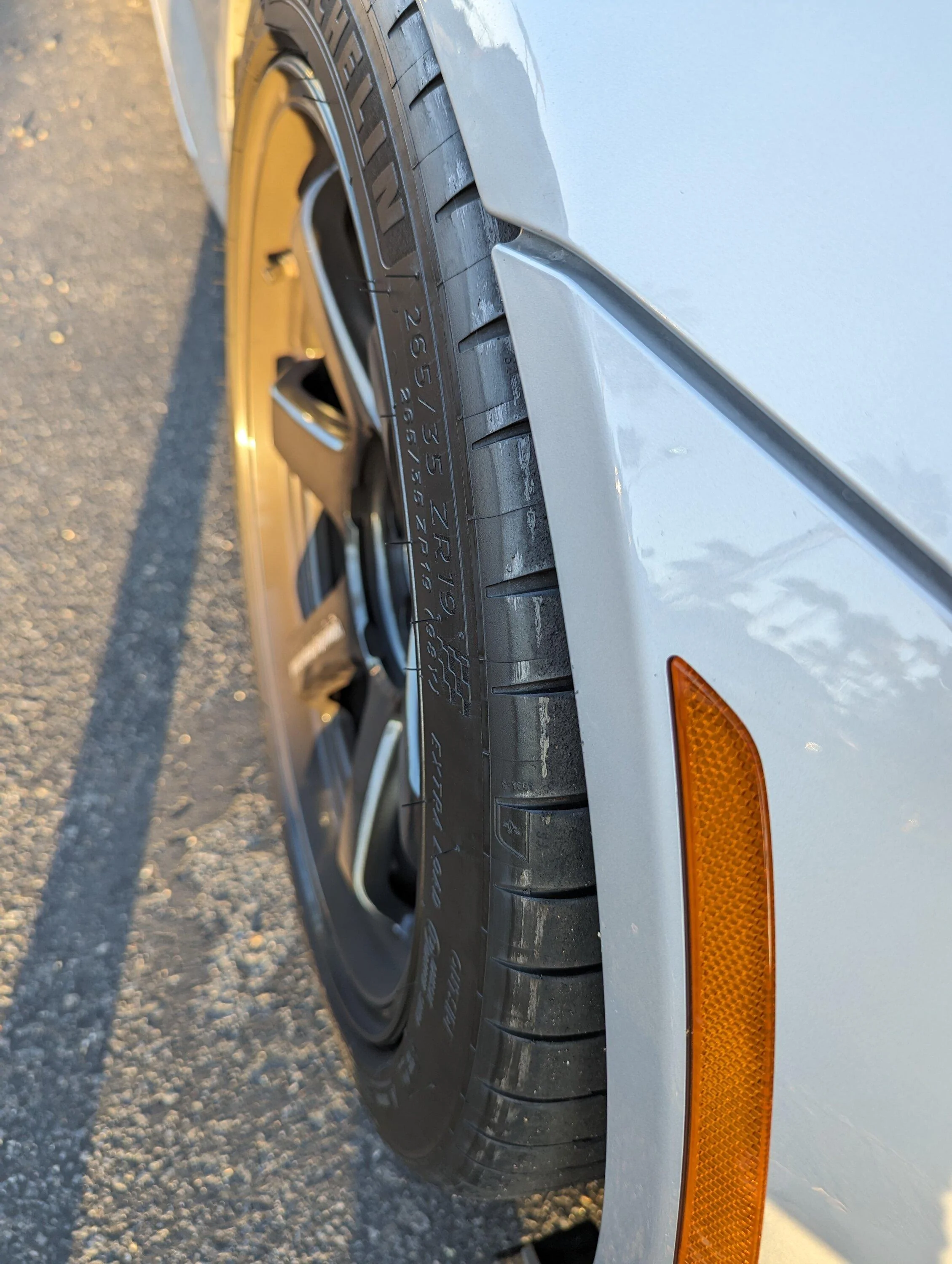

I recently upgraded my suspension with the KW DDC coilovers and lowered the car a bit more than it was sitting on the lowering springs. Unfortunately It started rubbing in the front.
This weekend I went to the canyons and I could hear a rubbing noise in every other turn.
My setup in the front:
- TE37 Supra spec 19x9.5 +23 5x112
- Michelin PS4S 265 35
Is there anything I can do other than lifting it up?

The tire does look poked out. You're not running any kind of wheel spacer are you? I have 275/35/19 on a Advan GT Beyond - 19x9.5 +25 and do not rub at all. I'm on HKS coil overs and lowered a little more than you....
8,805
17,266
More negative camber. The car is also wayyyyy too low front and rear. /thread

Yea looks like you need some negative camber. In that photo, it looks really poked.
