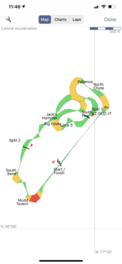

Yesterday. Red is from a large puddle that was across track. Lol.
Need a second suction cup and I am going to start using their video with embedded data tomo I hope.

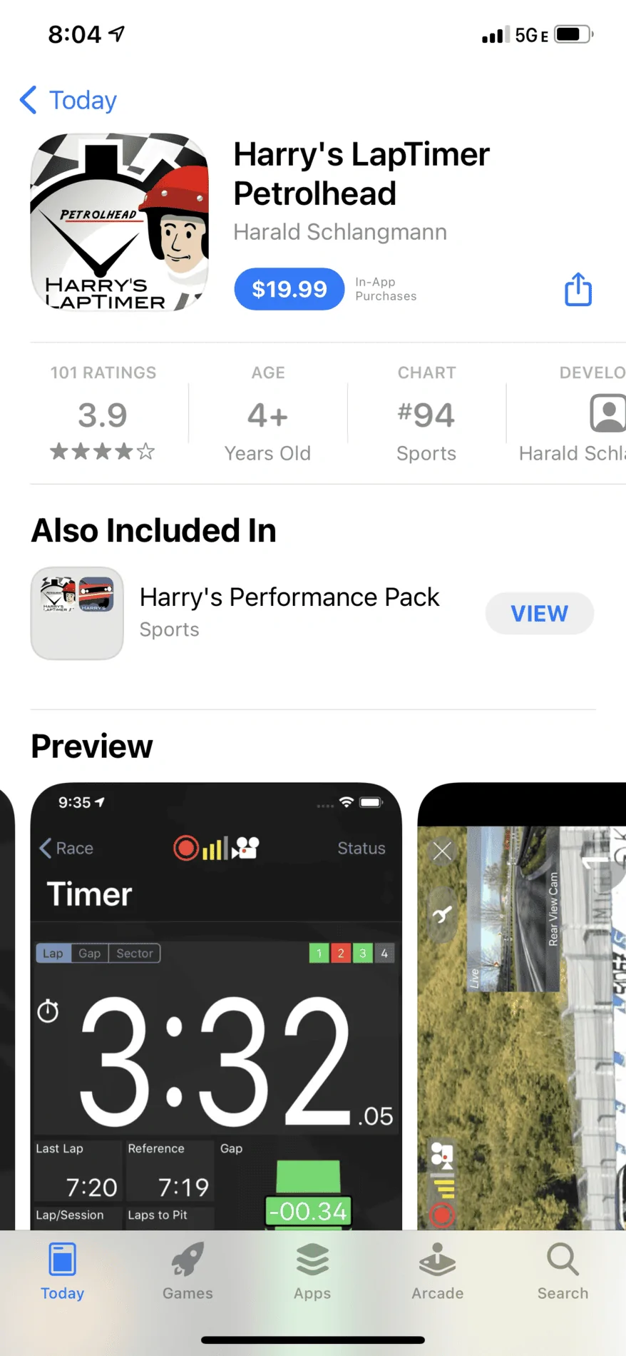

Ok, I purchased the petrol head version. Are you guys using an external gps? Or is your phone gps accurate enough? I’m using an iPhone 11 Pro Max with a RAM windshield mount.
