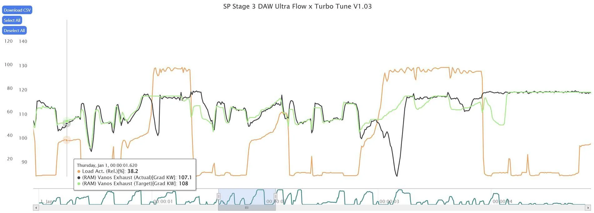

So on my last track day (Dec 28th 2024), car went into limp mode little ways into the lap. It was fixed by restarting but it went limp again. I tried to reflash, delete codes and restart but no luck. Went into limp again after maybe 30s - 1min of time on the track.
Was running 27psi tune, 98RON fuel, 550whp with DAW UltraFlowX. Ambient temp was between 20C-30C. I dont think its an overheating issue. Is it?
Weirdly, driving HARD on the street, doing multiple WOT pulls and I dont run into limp mode or these errors. It was only on the track.
Was getting the following errors:
  • 130716: VANOS, exhaust: control error, camshaft stuck
  • 132301: VANOS: Group error
  • 132101: VANOS: Group error
After reviewing the logs (attached), I found that the exhaust Vanos value was consistantly off the target under high load. In the bellow screenshot, you can also see the limp mode occuring after the last load cycle towards the right.
What do you think? My tuner says its a hardware issue with the Vanos valve but the car is new, only about 13k km on the dash. I have read other threads here which indicate it might be fixed on the tune. What do you think?

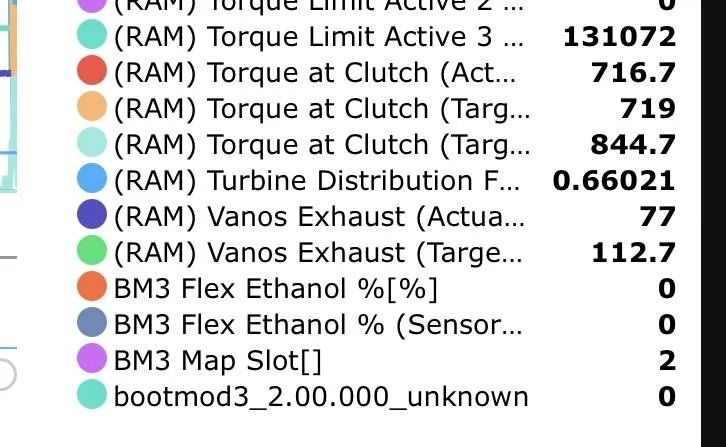

You are well below HPFP angle limit in your logs.
IAT is 135F. Very high.
What fuel level? Might have been fuel starve as well.
Also, looks like you got one of those ultra high quality lightning bolt tunes. ;)
fuel level was half on the dash gauge I believe. The tuner I’m with, Sam Performance, is supposed to be one of the best tuners in the region, I’m going to give HTE a shot
do you have any recommendations on tuners?
for IAT, what temp should I start worrying? I’m in Dubai, so we have very hot ambient temps usually so 135f is common in Spring/Summer. It’s winter now and I usually see 85-105f
