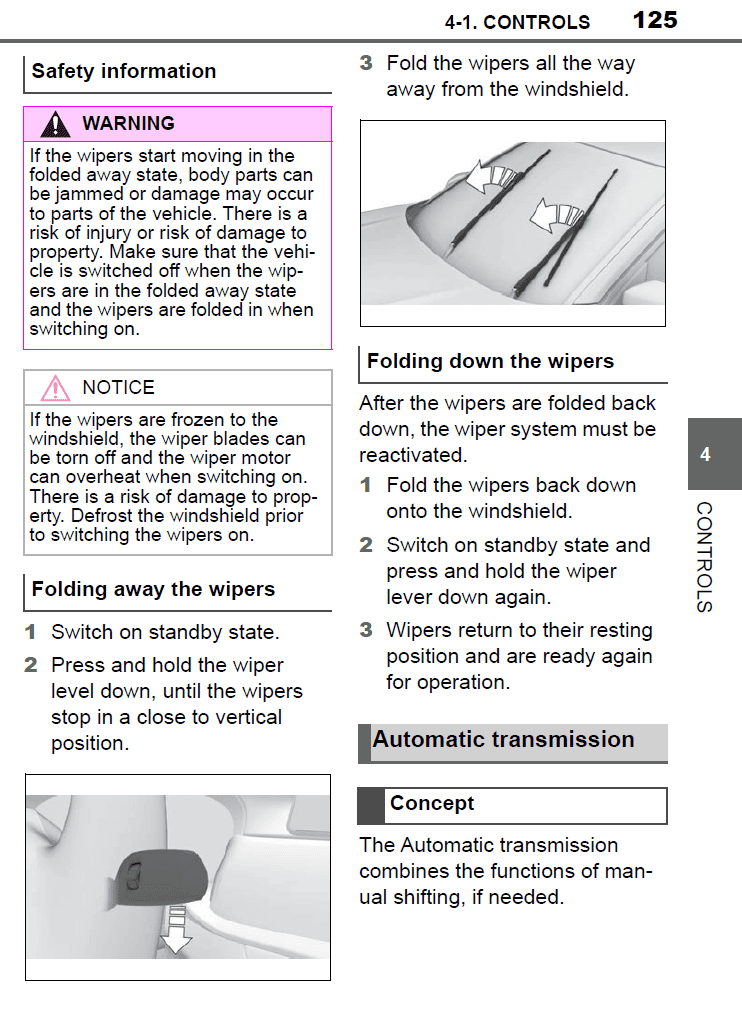

As you can read the title a friend of mines his GR Supra a 2021 Phantom gray wipers were stuck upwards position. He accident tapped it while we were driving and it we pulled over at a gas station to see what was going on. My friends and I disconnected the battery cable and reconnected it and also unplug the fuseā€™s as well. Still no movements on the wipers. I donā€™t know if it is a BMW recall or electronic issue, however I tapped the wiper motor with my fingers a few times and then the wipers started to work again, but when it worked the motor sounded weak more of a weak wining sound to it. It works now but we all did recommend him to bring it to Toyota just to check it out. Has this happened to you guys before???

has not happened to me but I know there is a way to reset the wiper motor, I believe its in the manual.

ooooh this is... I did not know about this šŸ˜ˆ great prank material for bmw friends.

I had the same issue and ended up removing the wiper arm and reinstalling so that it sits a little lower now.
