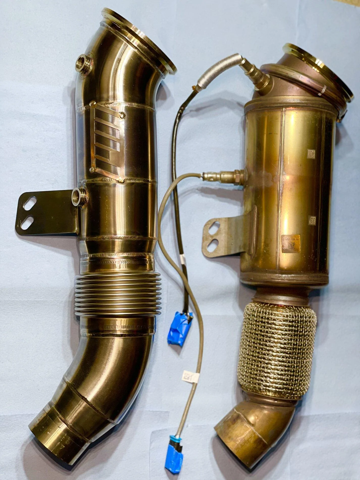

The factory exhaust is fairly free flowing as it is. I would expect gains to be minimal at best. The biggest restriction is the massive Catalytic Converter on the downpipe, see pic below.
