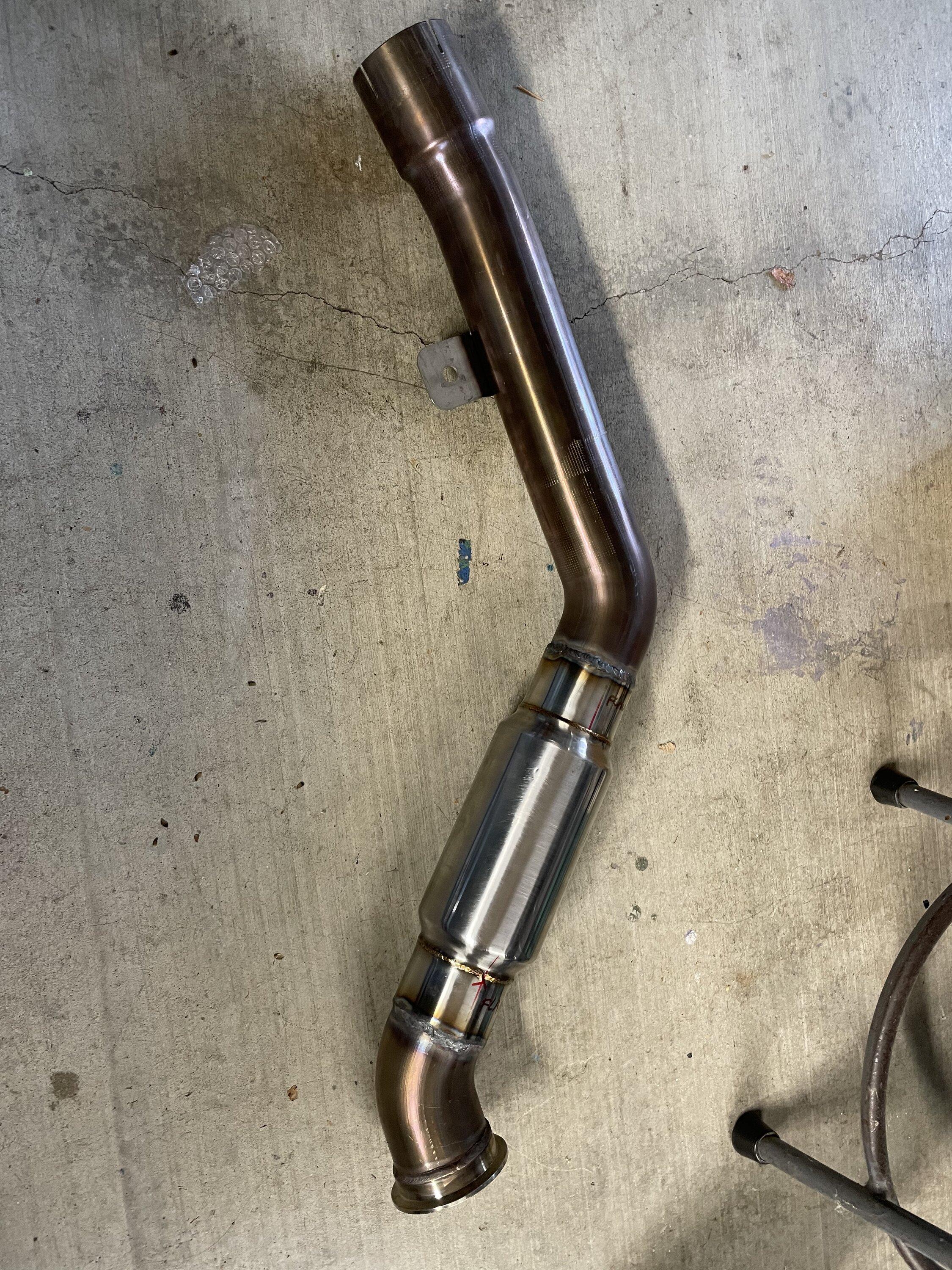

I will be adding a 12” resonator on the 3” pipe after the DP to see if I can eliminate the resonance between 1500 and 2000 rpm. I’ll report back when done. It’ll be a tight fit but it looks like it might work.

Ok. I installed a 4” dia 1’ long 3” inlet on the 3” MF mid pipe. It’s a tight fit leaving only about 1/4 clearance between the heat shielding and the pipe. I say it reduces the drone between 1500 and 2000 rpm about 50% or so. Definitely reduces some of the annoyance. Quiets the overall sound just a tad, but noticed it also quieted start up a bit too.
here is a pick prior to the install back from the fabricator.
