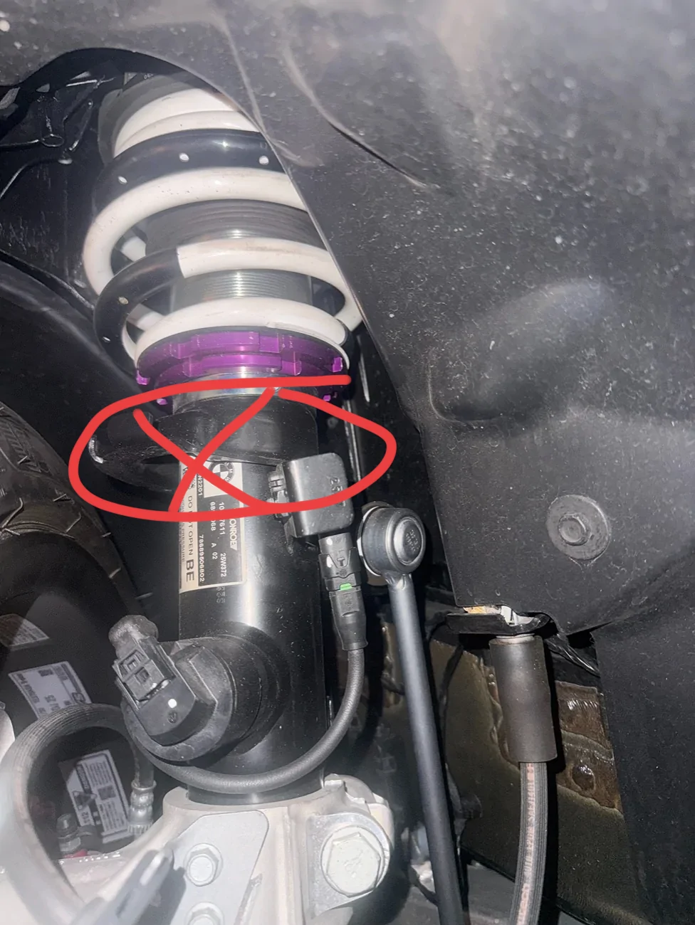

Hi everyone! I’m new to the Supra world and this is my first sports car, so please go easy on me haha.

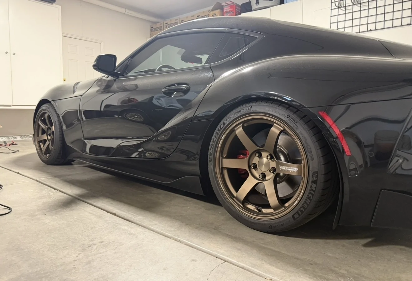

Looking for some advice on suspension/fitment for my 2026 manual GR Supra. I’ve done some searching on this forum and still can’t seem to make sense of my current situation. This has honestly been keeping me up at night, and I don’t know what direction to go at this point.
Since bringing the Supra home from the HKS HAS install, it’s mostly been sitting in my garage because I don’t want to drive it much until I figure this out. It makes me sick thinking about the money I’ve spent on the HKS HAS and install, just to possibly take them back off and switch to coilovers. Any advice would be very much appreciated.

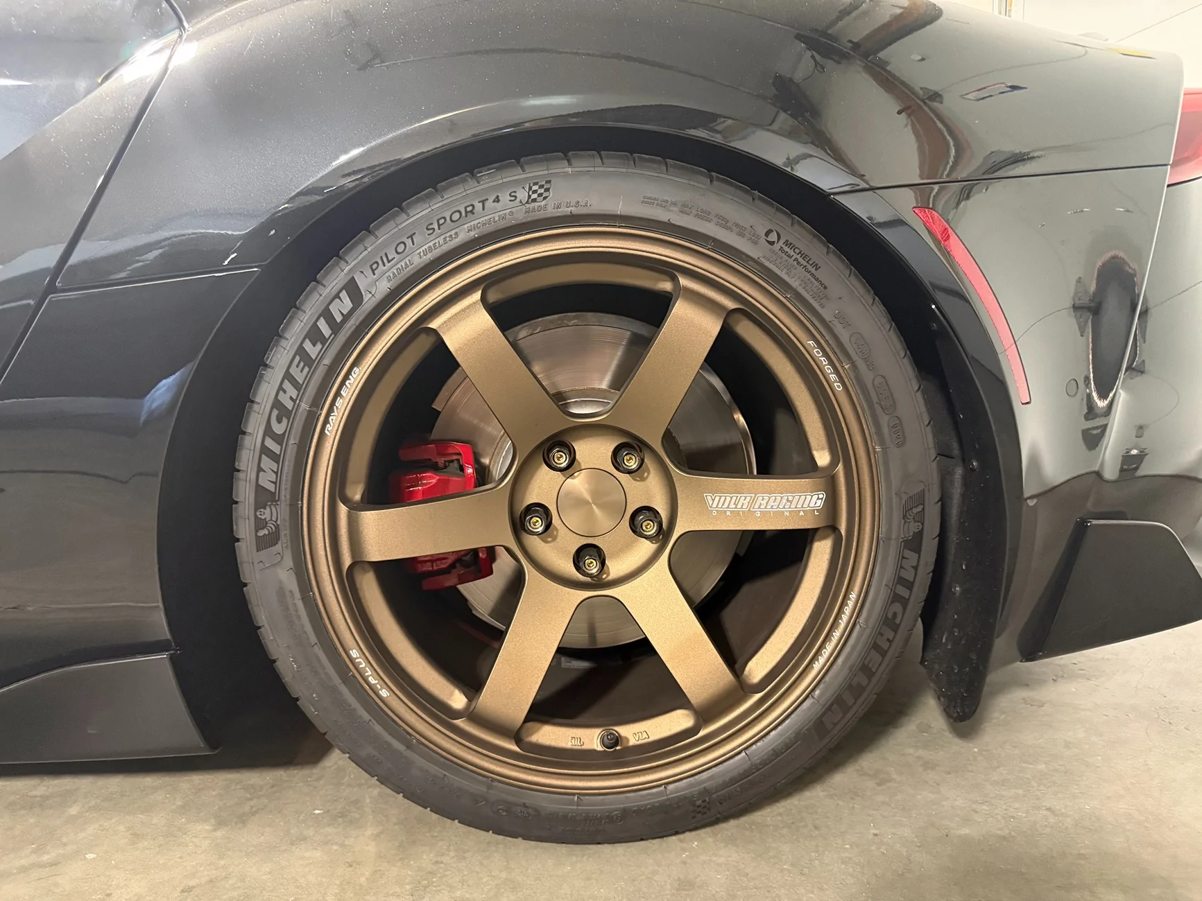

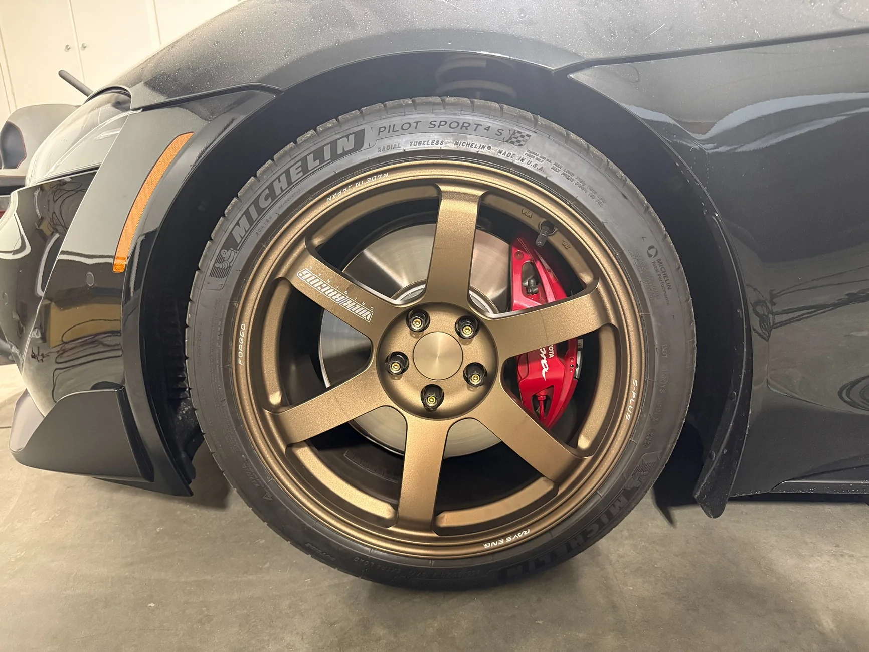

This tire, wheel, and HAS setup was recommended by the shop I bought the wheels from. They said it was a very common setup and a good option since I could keep the EDC. I was pretty excited until I picked the car up and saw the front gap.
Current setup:
  • HKS HAS
  • Front: Volk TE37 Saga S-Plus, 18x10 +25, 265/35ZR18
  • Rear: Volk TE37 Saga S-Plus, 18x11 +34, 295/30ZR18
  • Front and rear installed, with the front set as low as possible
  • Shop used the HKS packers/spacers to get the front as low as they could
Issue:
The front still isn’t going as low as I want. There’s still more gap than I expected, especially in the front. I’m trying to figure out whether this is just the normal limit of the HKS HAS on these cars, whether the 18s are making the gap look worse, or if there’s something else I should be looking at.
A few things I’ve already looked into:
  • Alignment is drivable for now, but rear camber is still pretty negative. I plan to fix that with new rear camber arms once I get the height dialed in
  • I’ve seen mixed comments online: some people say HKS won’t go low enough in front, while others on 18s say they were actually rubbing
  • I’ve also read that the manual might not go as low as the auto
Questions:
  1. Has anyone here run HKS HAS on a manual Mk5 Supra with 18s and had the same issue?
  2. Does the manual car sit differently enough that the drop ends up less than expected?
  3. Do 18s just make the remaining wheel gap look worse, even if the actual drop is normal?
  4. Is this basically the limit of HKS HAS in the front?

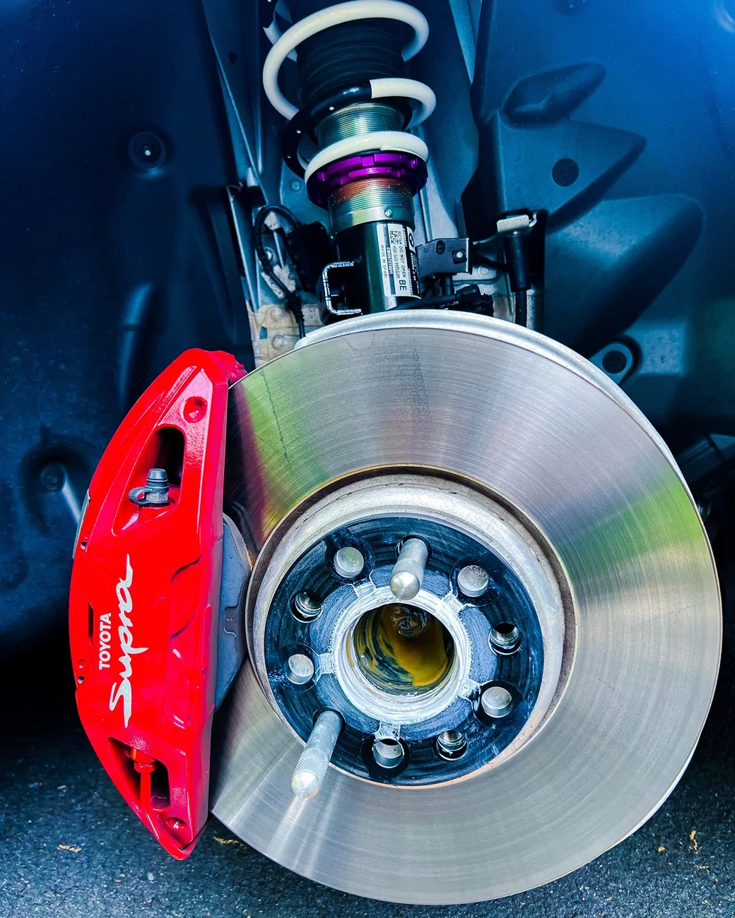

  5. Could the OEM spring perch still being there be causing this issue? I’ve included a photo that will hopefully help determine that.
  6. If I want it lower but still streetable, would you go with:
    • switching to 19s
    • a different HAS-style setup
    • BC ASP / MSS / similar keep-EDC setup
    • full coilovers
I’d especially appreciate feedback from anyone running 18s on HKS HAS, or anyone who switched from HKS HAS to coilovers because the front wasn’t low enough.
Thanks in advance, everyone!

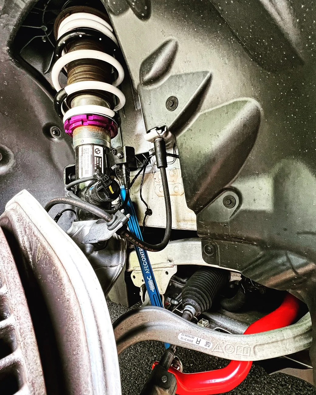

FYI... OP...
"The HKS Hipermax HAS (Height Adjustable Spring) kit absolutely requires you to remove the factory front spring perch. The adjustable HKS threaded sleeve cannot seat properly on the strut body unless the OEM perch is completely tapped off."
The perch isn't welded on. It just taps off.
Notice this installer knocks the perch off (54s)
And the new HKS sleeve goes on...
Bad installation.

Demand all your $ back from that shop. What the hell is that install

Isn't sass, it's a call to action. How many other Supras has that shop worked on, currently driving around with an incorrectly installed spring kit? If OP doesn't tell them, it's going to keep happening

Can’t thank you all enough for the responses! I feel relieved to finally have some answers, but also pretty frustrated at the same time.
I’m new to the Supra community, but already love it and am really happy to be a part of it!
Seriously, thank you all again. You may have just saved me a lot of money. Hopefully the shop steps up and makes things right.

Let us know how it goes mate, they need to make this right for you. Aside from some good photos here, there is plenty of evidence on why they need to fix this for you.

OP had an actual issue which most of us (myself included) wouldn't have caught. This isnt another 'which oil' 'the M2 is better' thread. This called for some real help
