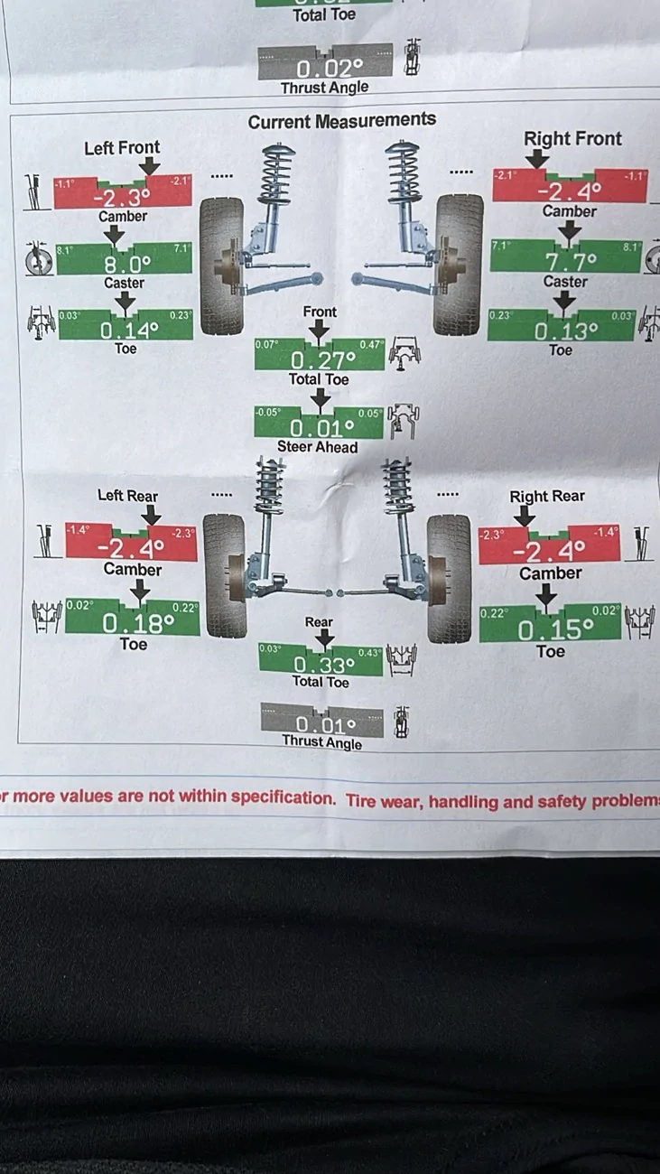

I ran front camber plates with HKS springs at one point - didn't upgrade any other suspension parts.
This was my alignment and setup at that time
