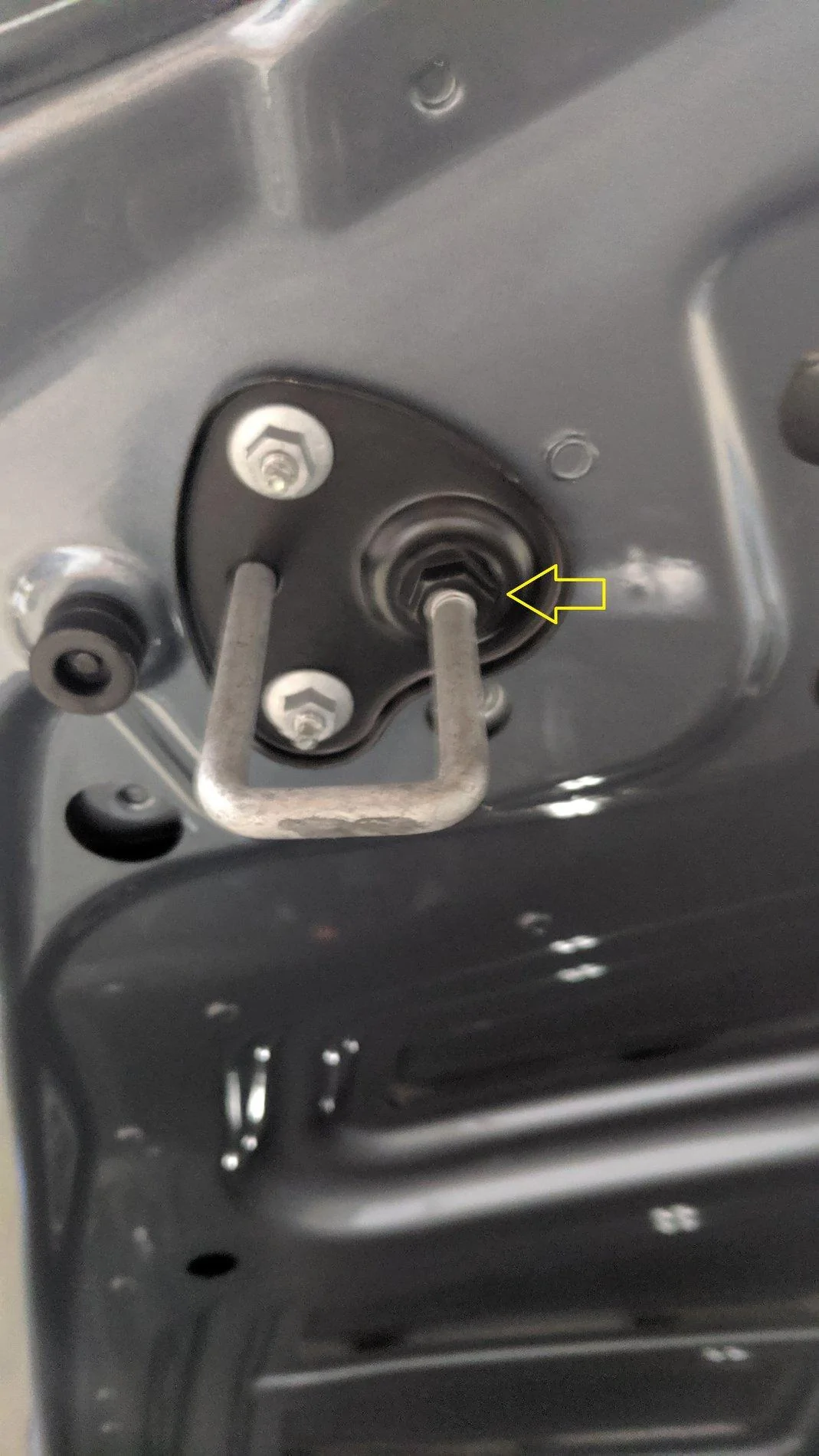

As the OP mentioned, I did check the hood latches and they are both even and don't seem to be the issue.
