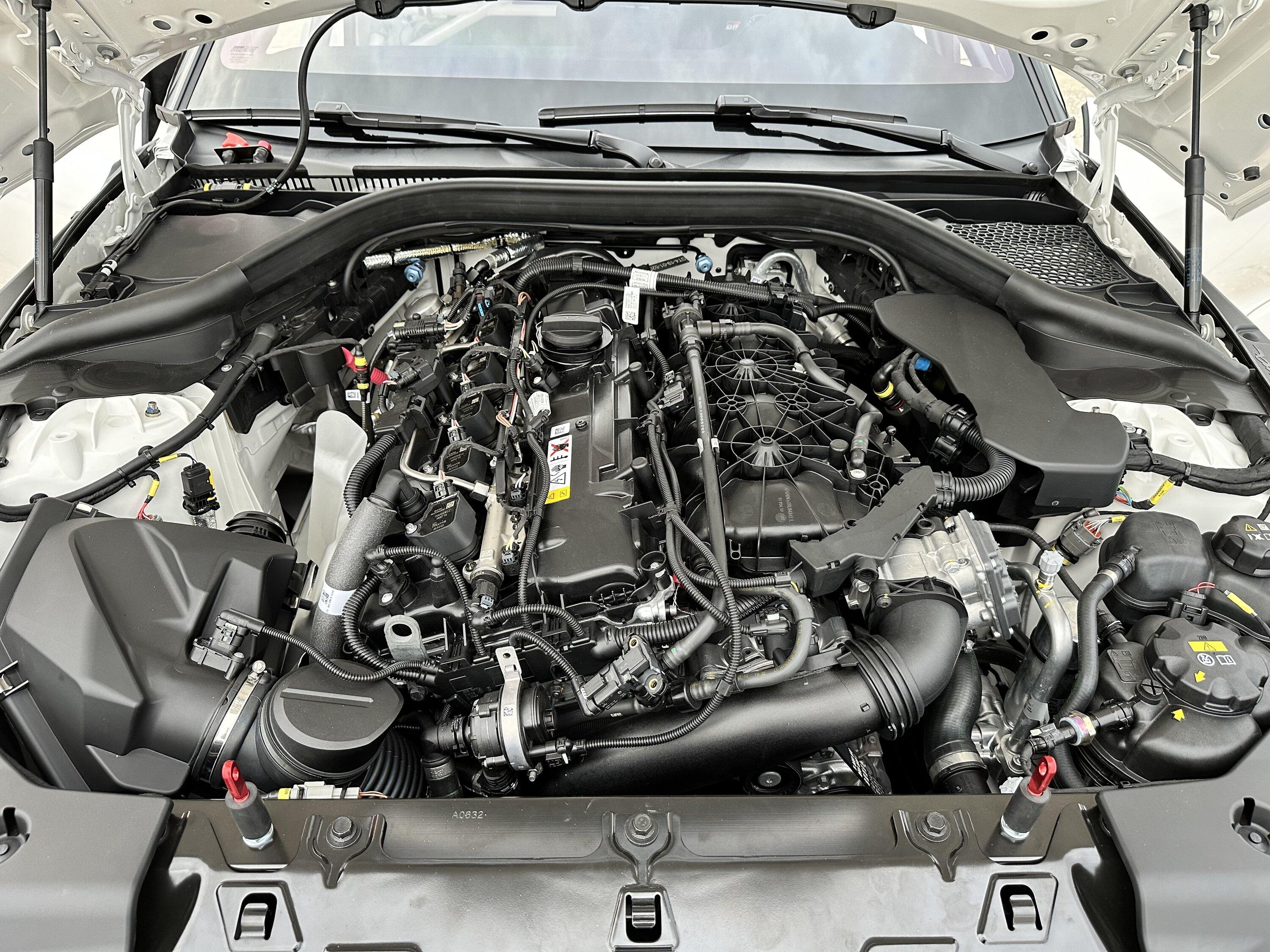

I have a carbon fiber hood incoming and i'm wanting to buy some aero latches for it. The only thing is i can't seem to find ANY information on where under the hood they would mount to?
I understand the hood is double latched but i'd rather have them and not need them than need them and not have them.

Front strut bar holes. Exactly where the GT4 mounts them.

You're a life saver, thank you. Does that remove the ability to mount a strut bar or can you do both? No biggie if i can't (i have a 2020 so i don't have one anyway)

Don’t see why you couldn’t do both

Any reason I couldnt use these locations with Quick-Latch style hood pins?

Wouldn't see why not. When you say Quick-latch style, are you referring to the push button-esque types you'd find for bumpers? Personally, I'd just stick with Aerocatches.

Quik Latch QL38 is specifically rated for secondary hood latching.

Correct - Quik-Latch QL38 is what Id like to do as they are low profile.
