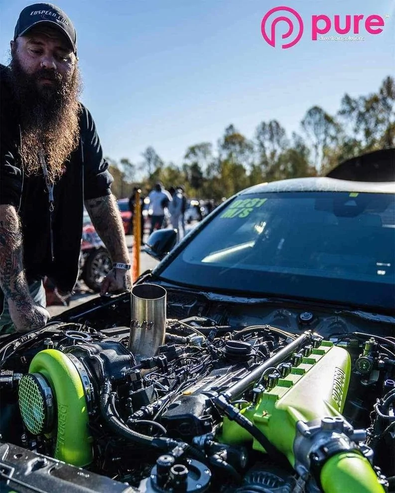

So just out of pure curiosity for those of you who have a hood exit exhaust or know someone with a hood exit exhaust, what are the pros and cons?
Mk5phtm
Paul
Jun 2, 2020
250
300
Socal
2020 Toyota GR Supra Phantom
@a90haysuz on Instagram
8,472
14,122
Cons:
- Can't really drive in rain
- Need to keep it covered
- Loud
- Burn marks on hood/heat distortion on windshield
- Custom fab (KLM has a kit, but it's only for the savage kit [works obviously with any Next Gen PTE])
Pros:
- Less backpressure against the turbo
- Launch Control looks great at night
Bonus: Zero sleep me in a Pure ad after up all night rebuilding this car at World Cup Finals.
