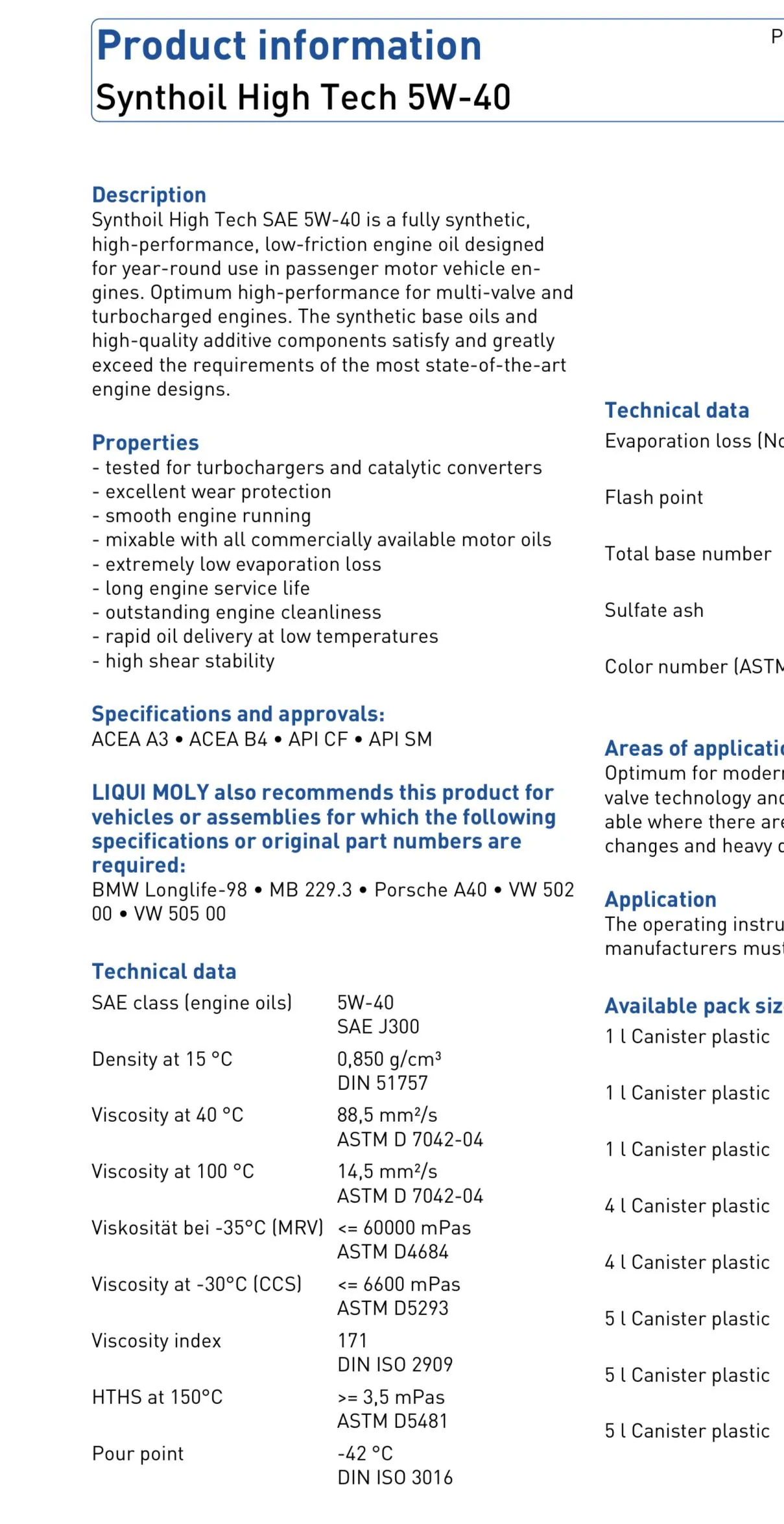

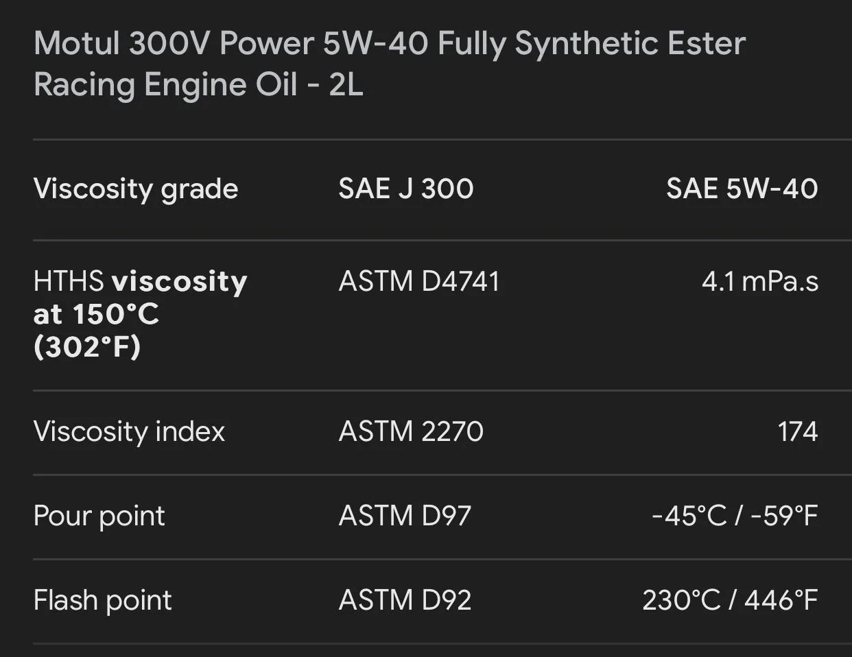

For maximum protection HTST viscosity is what’s important when selecting an oil for strenuous use. Even with LL01 spec not all 5w-40 oils are equal.
Attached below liquimoly vs motul 300V, there are non racing brands that are comparable to motul spec without the price tag.
