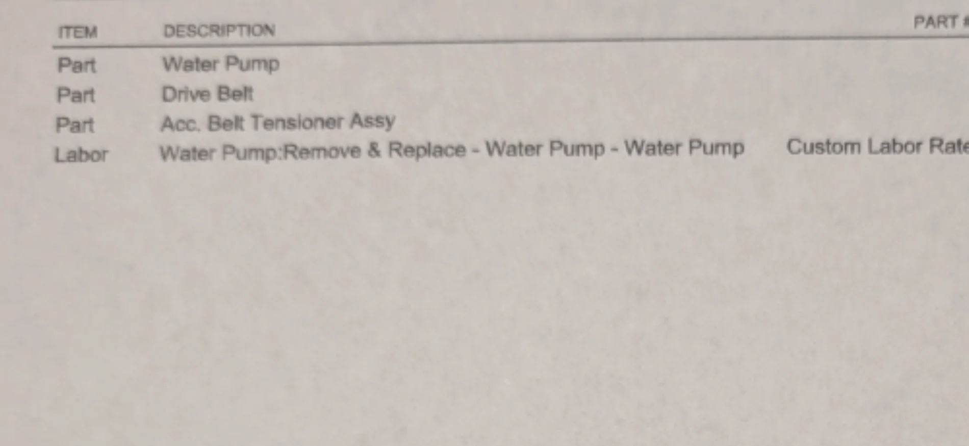

Did you ever get this resolved? Ran into the same issues this morning

Hi there. Sorry for the late response …… this was the problem !
They replaced that and bam . Problem gone . They also recharged the battery !
Thank you! Got hit with the same exact thing, except turbo went too.
