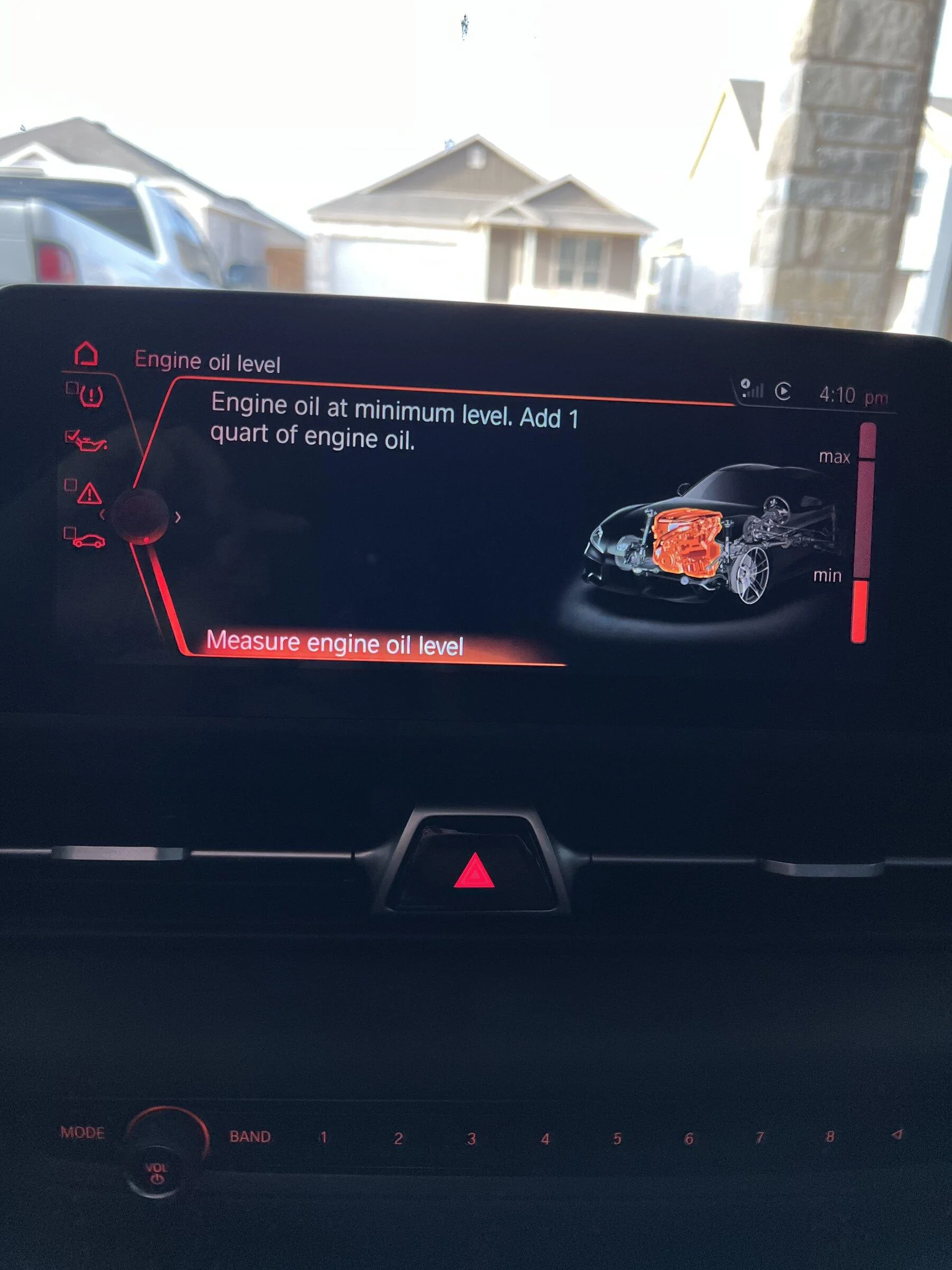

speaking of… now off to autozone to add my fifth quart of oil. 5.1k miles pretty much exactly. I drive it HARD. Manual says 1k miles per quart is within spec so I just send it and keep a quart in the glovebox.

looks like I’m due for another quart after some spirited driving today. That’s 600 miles since my last quart was added. JB4 was installed during that time. Not blaming just notating.
will never need to change your oil I bet...you add so much.
