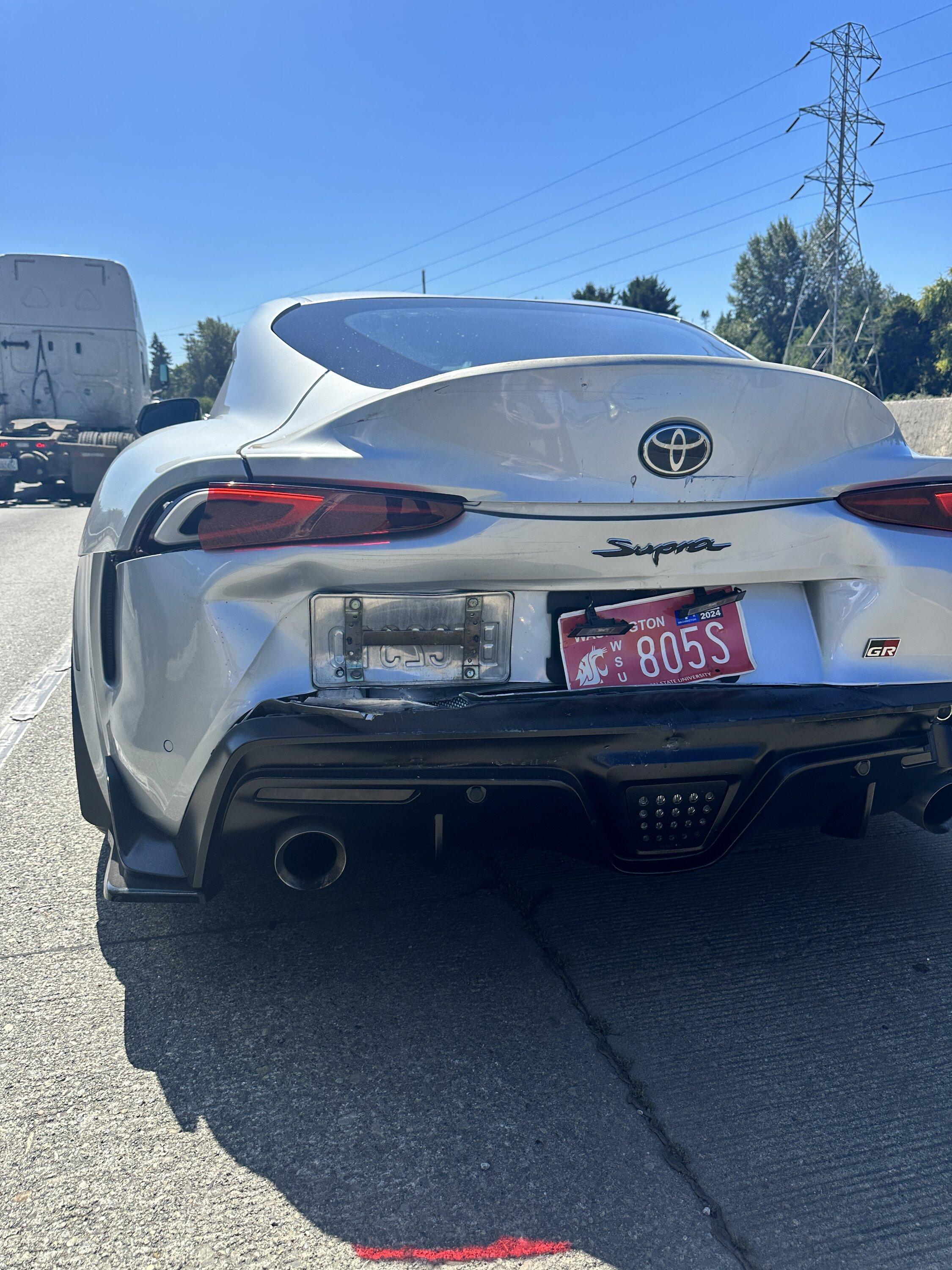

Gr supra 2020.

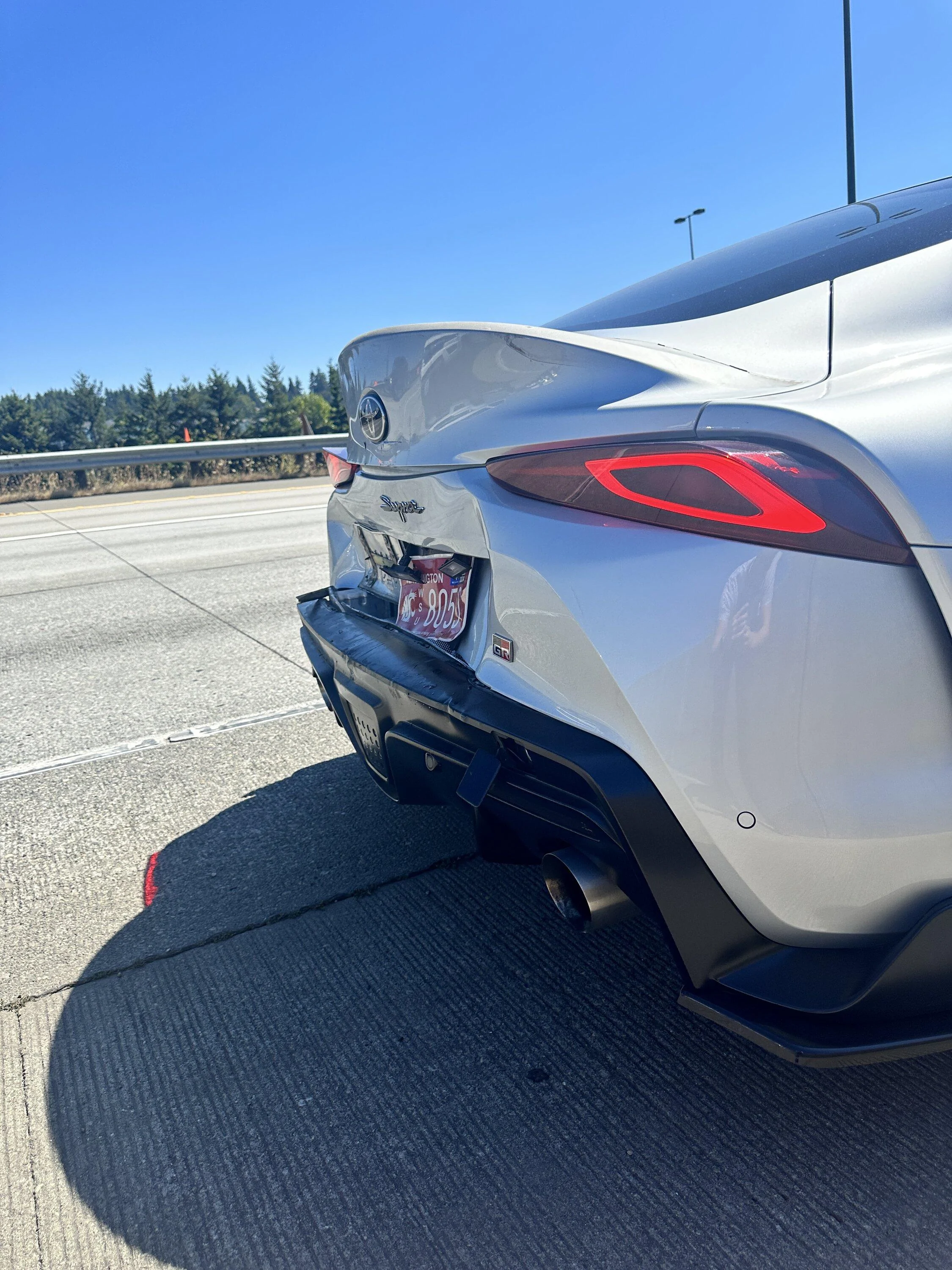

I was in stop and go traffic, I was stopped, he was going. No airbags and I drove it home so nothing really mechanical that I can tell.
Also, since my car will now have an accident reported, do I get any compensation due to the now lowered value of my car? How does that work?
Anyone ever seen a plate stuck in a car before?

Oof yikes, this could actually be totaled, I think everyone is a little low on estimates, the paint alone due to blending is going to be pricey, I would say on the low end 10-12k, with the high end being 20k+, a good Diminished value attorney should also be able to get at least 8-10k in dv for an accident like this. but ya seeing how the quarter pannel buckled and shifted, I would prob air on the side of caution and take as many mods off, and have it totaled and either get yourself into a new supra, or whatever it is you want.

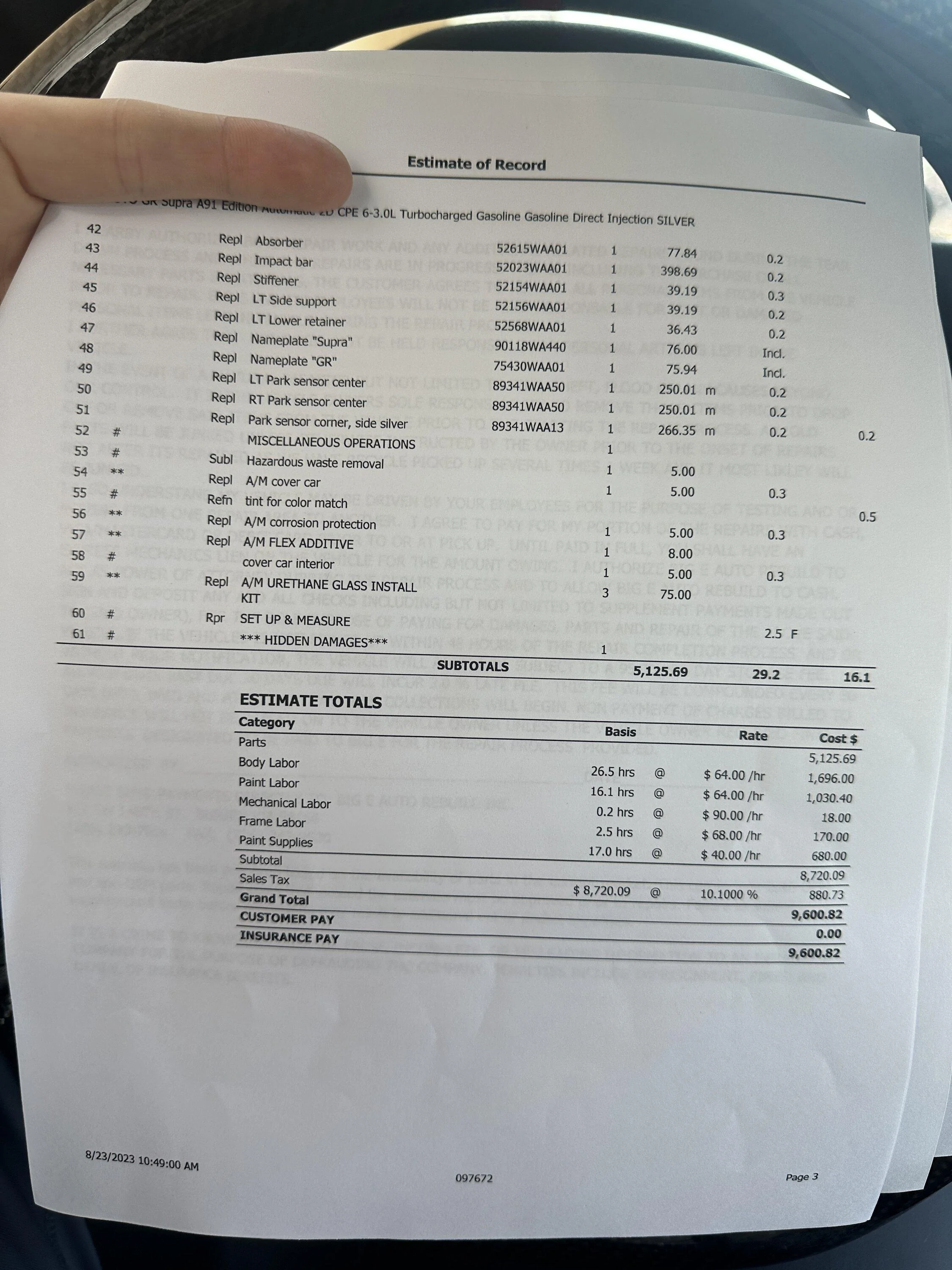

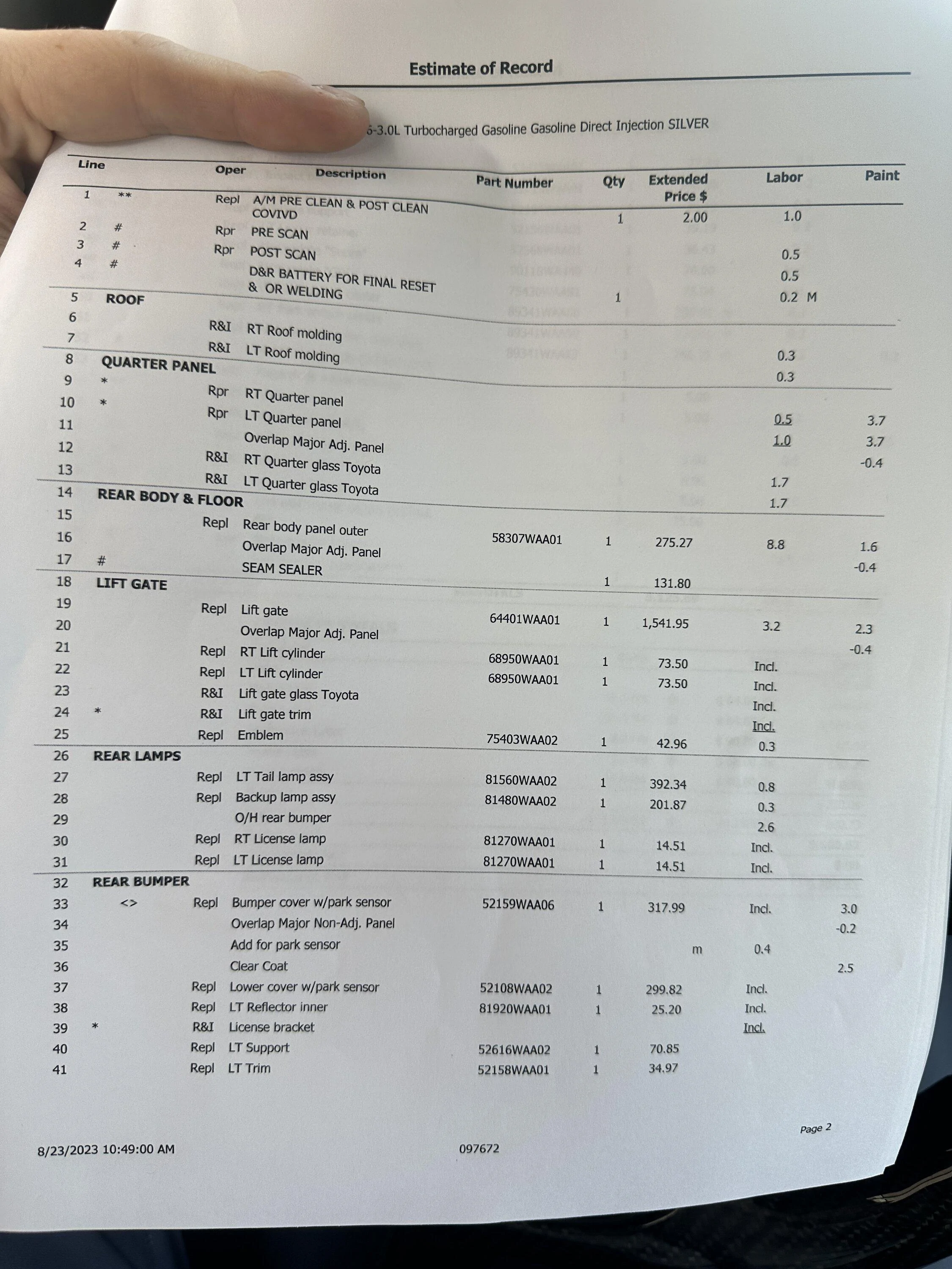

Alright y’all, here’s the first estimate. She said it is very likely to “go up substantially” once they start taking pieces off. A few shops turned me down simply because they haven’t worked on the new Supras, a few others said they don’t have a unibody jig if they need it. Thoughts?
8,472
14,122
Seems close

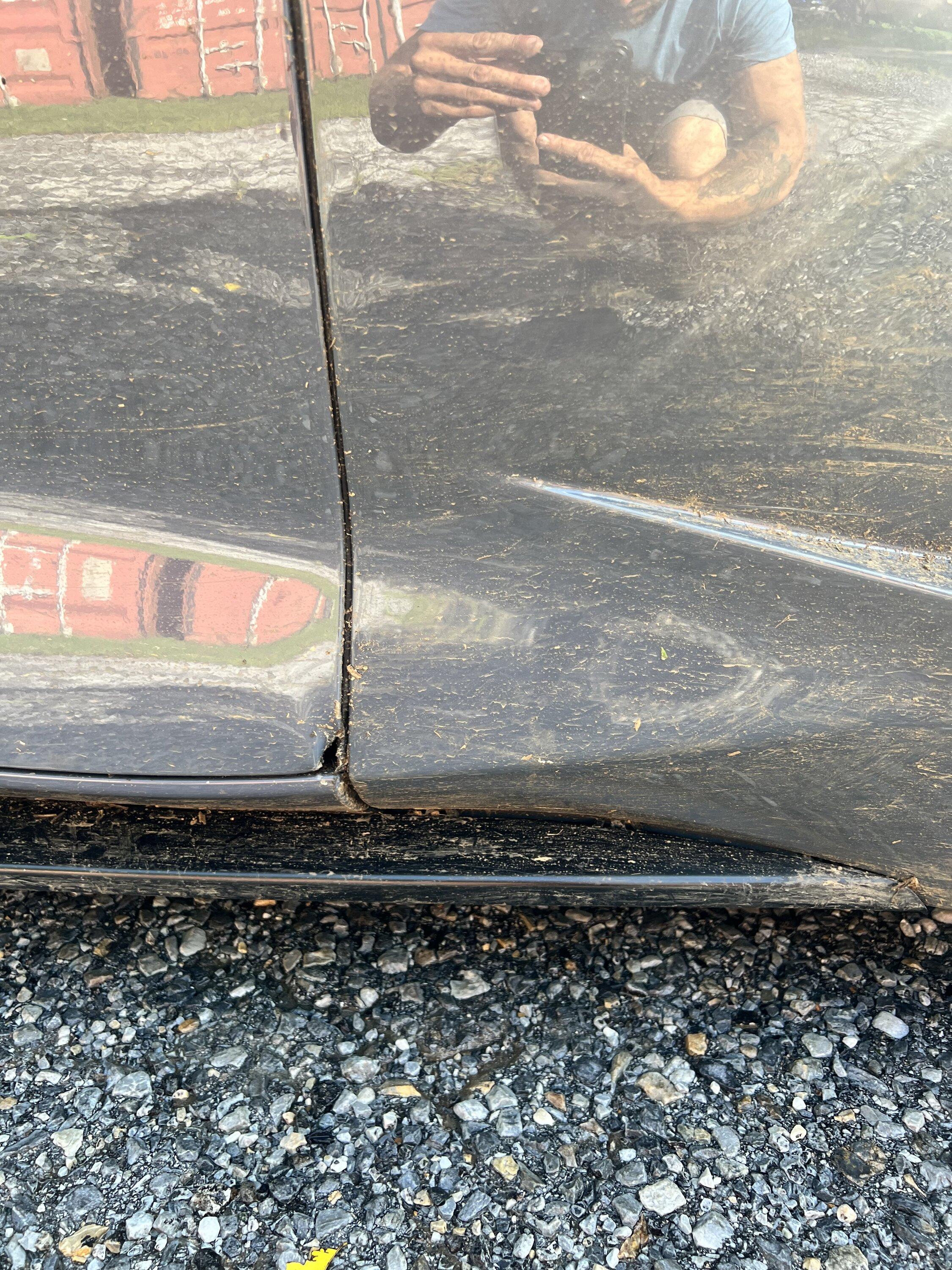

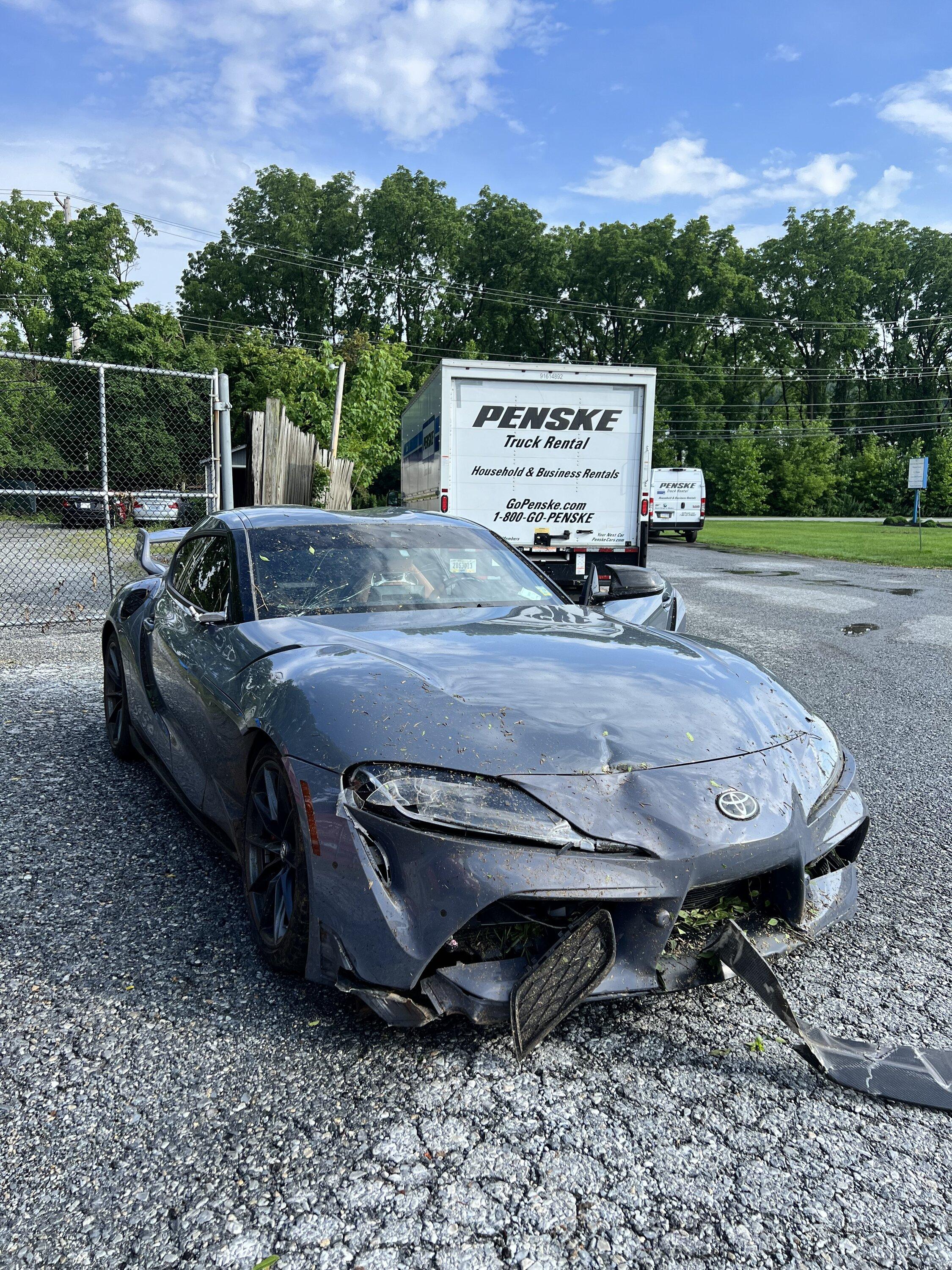

If you were closer I'd tell you to go to Fix Auto in Puyallup, I've dealt with them several times and they're good. This is exactly why I avoid Seattle like the plague! I fucking HATE Seattle!

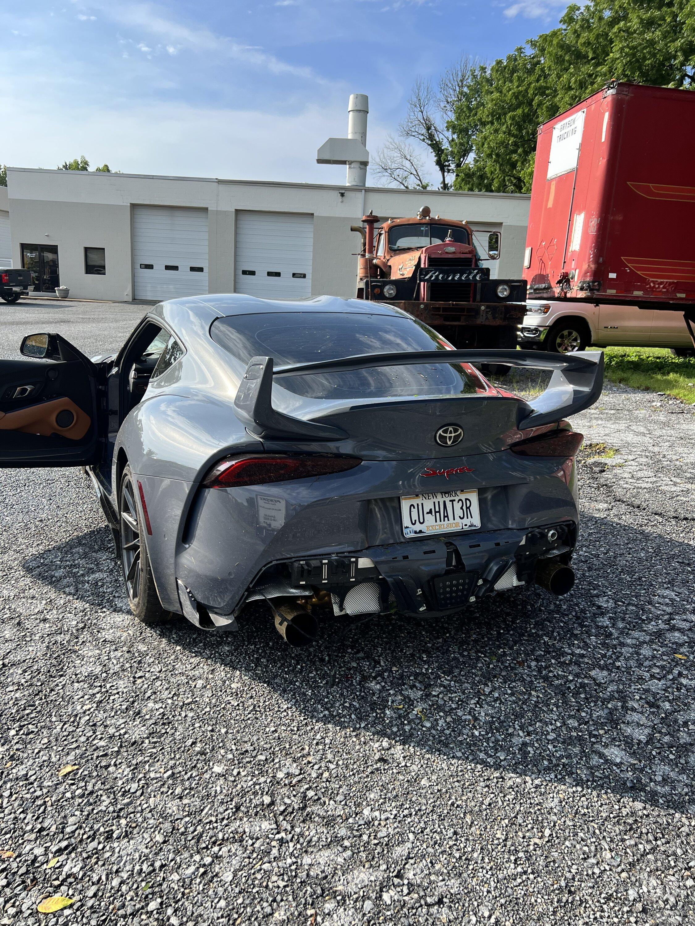

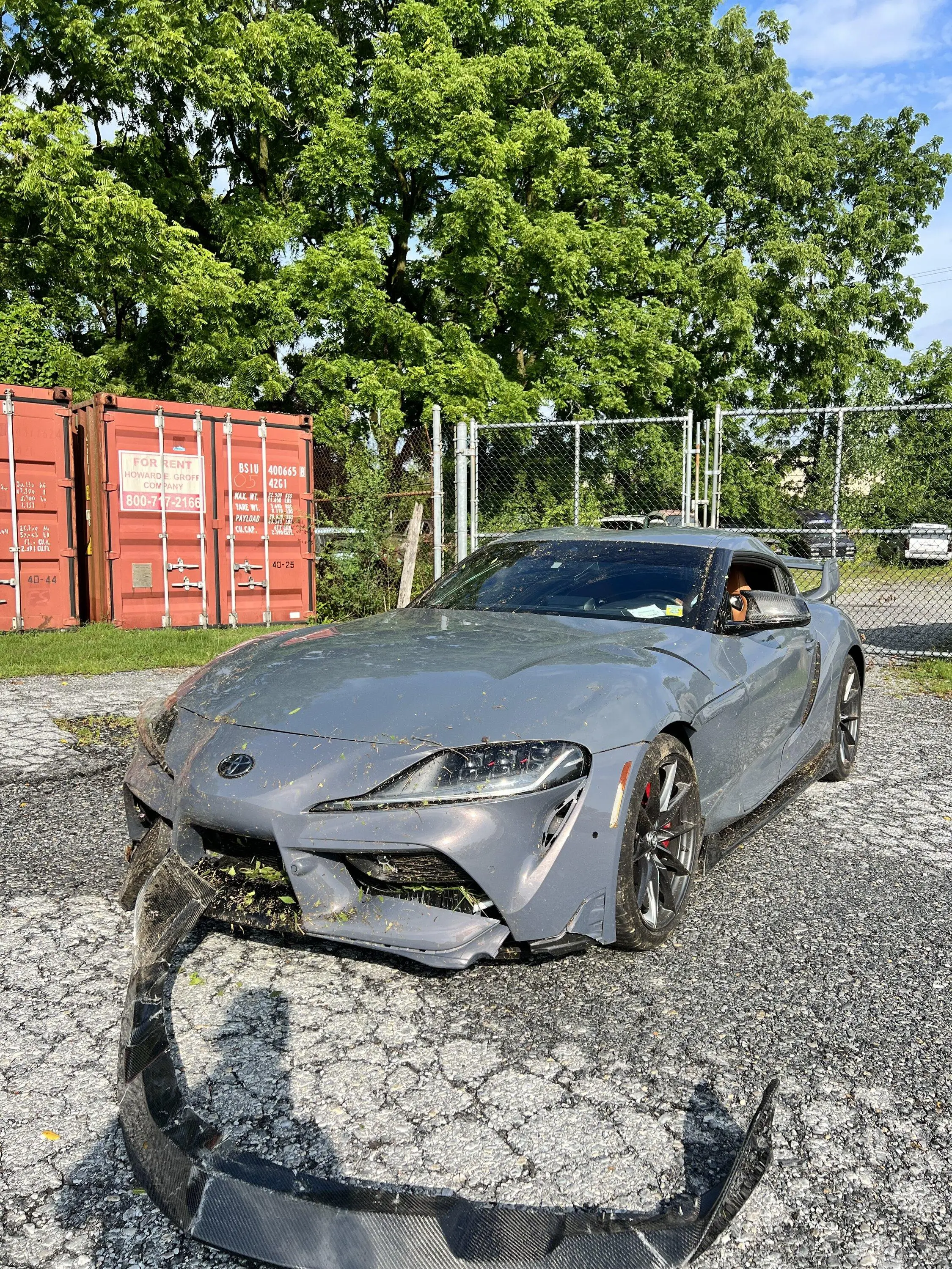

Mine was estimated 30k in damages they didn’t total it. You should be okay
And what the FUCK did you do? Did you go high speed off-roading?

I wasn’t satisfied with the landscape work the state provided.

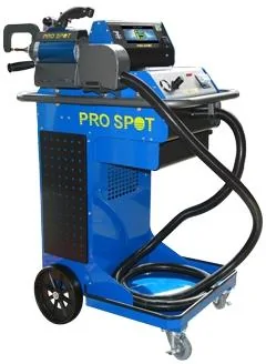

@PNWDMM estimate looks solid. Pretty much everything I expected. Glad the quarters ended up clean. Some minor repairs from where the hatch popped them probably. One thing I should have mentioned earlier, make sure the shop you choose has a dedicated spot welder for replacing that rear panel. The machines should be standard equipment at most shops now but they’re 40k+ for a lot of the models so some still just do it by hand.
Missing OEM style spot welds are a dead giveaway some major work was done.
something like this.
