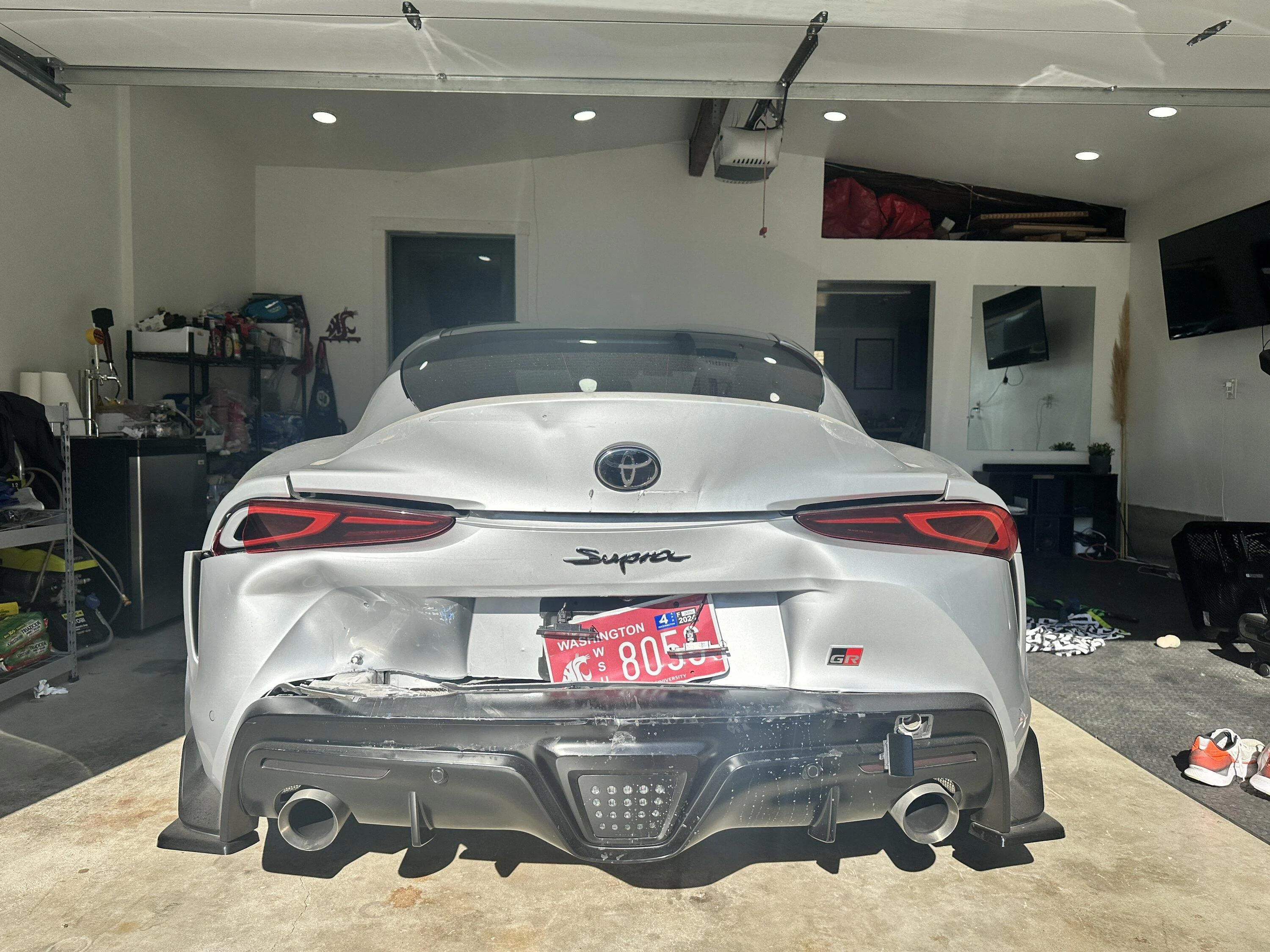

I was in stop and go traffic, I was stopped, he was going. No airbags and I drove it home so nothing really mechanical that I can tell.
Also, since my car will now have an accident reported, do I get any compensation due to the now lowered value of my car? How does that work?
Anyone ever seen a plate stuck in a car before?

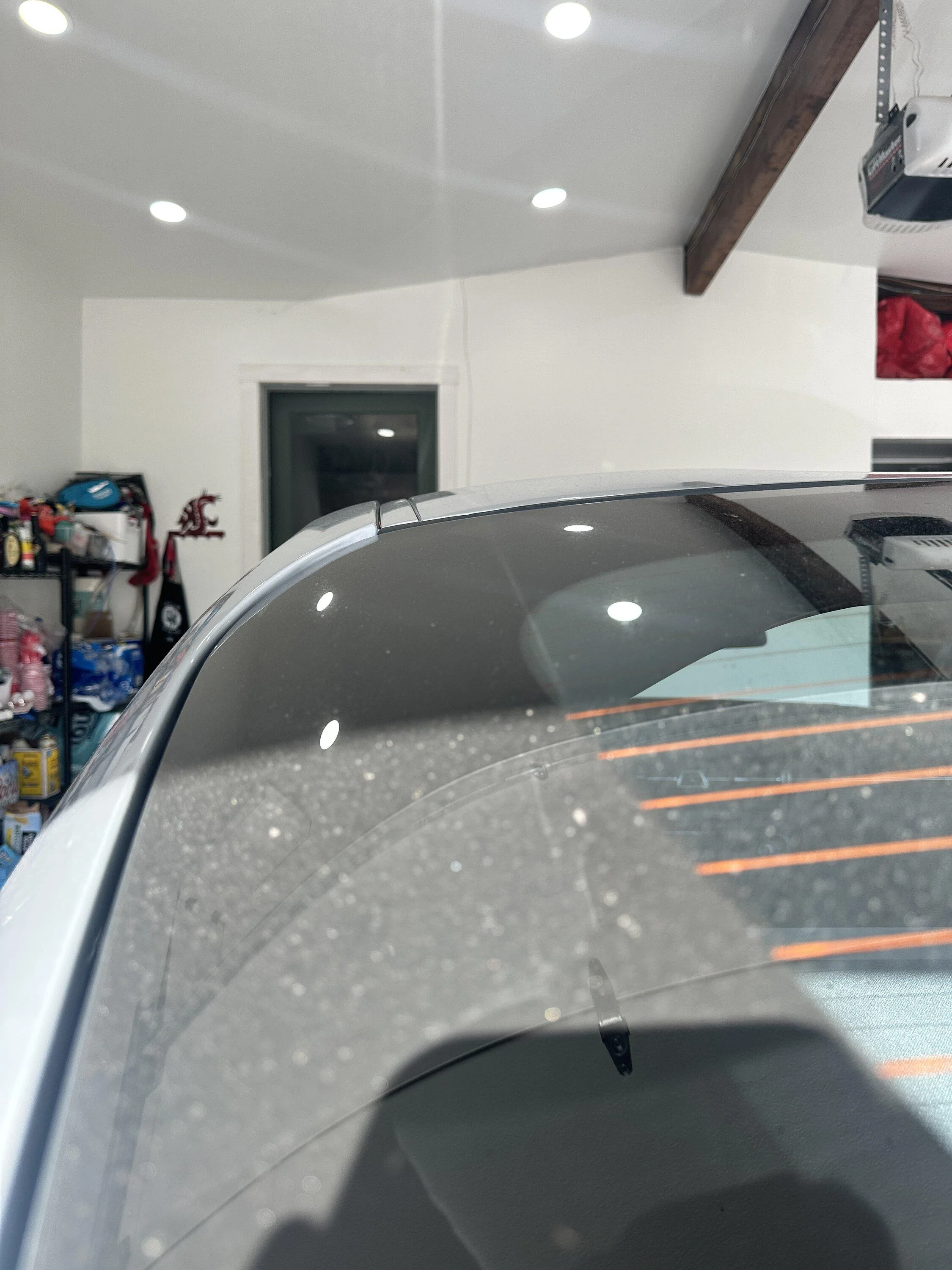

Man. I really hope I’m wrong but it might be considered totaled. Let us know what your carrier ends up saying.

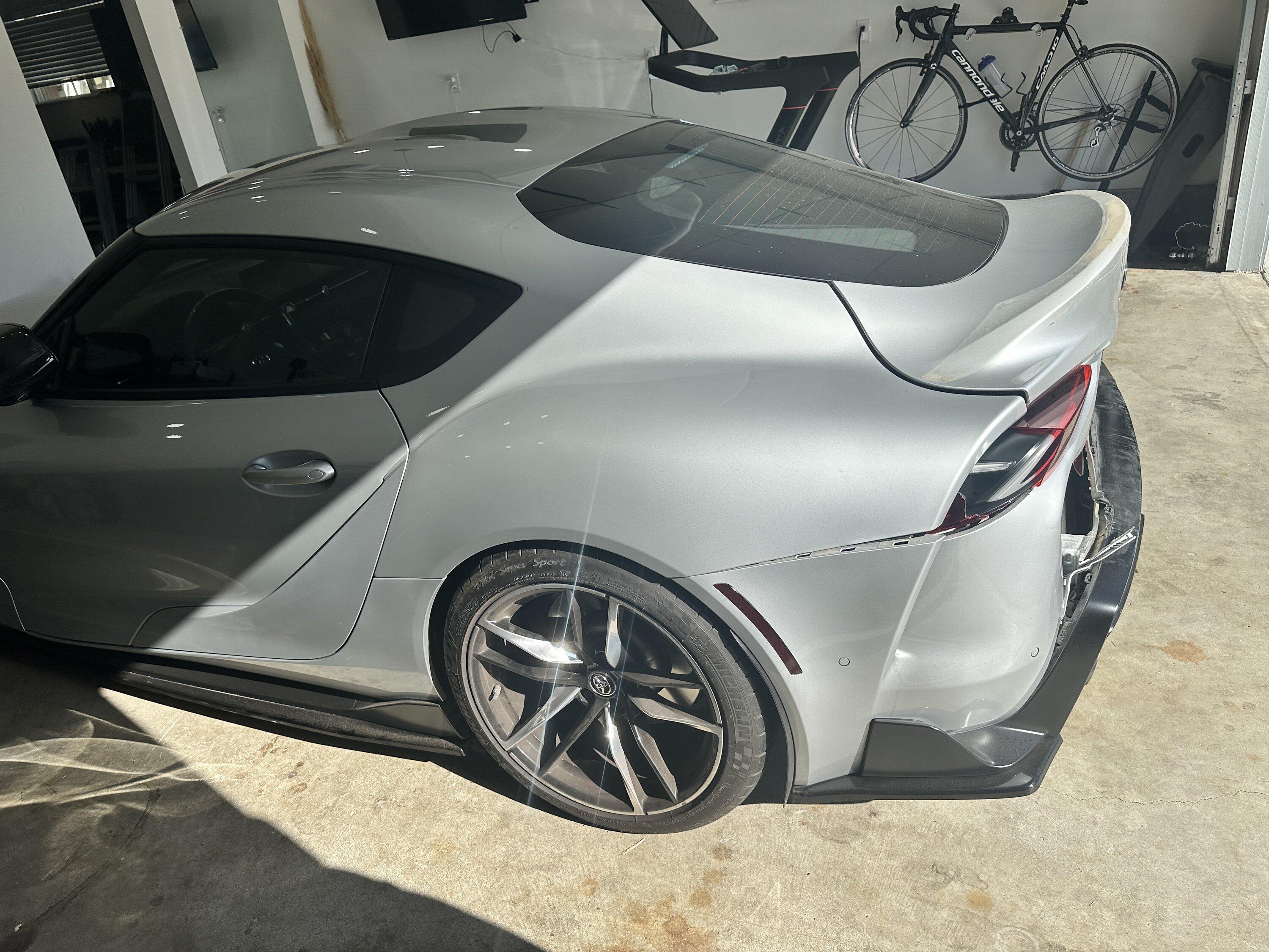

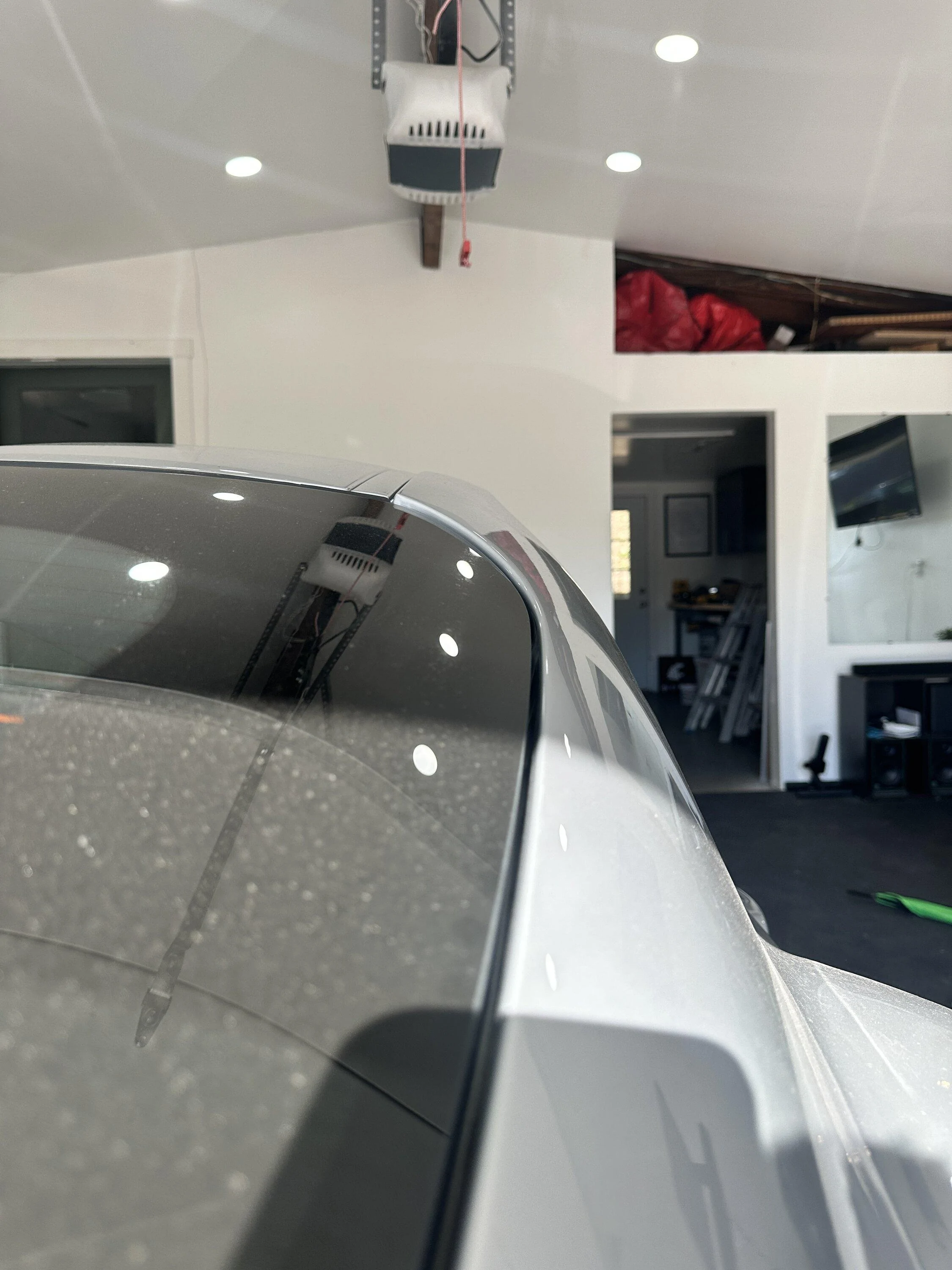

New bumper, hatch, driver tail light, rear diffuser/valance… and it could just the camera angle but the area above your B/C pillar looks a little raised where it meets the roof.
Sadly I second the above, good catch on upper area on the drivers side above the rear glass, maybe it’s just sun or picture angle, don’t forget about the trunk pan area, check to see if there’s more damage than just plastic pieces… best case $10k if no structural damage, plus the parts availability and shops as well.. :(
Definitely all the things you mentioned. The angle does show it a little more raised than it actually is, but I just went out and the drivers side is raised by maybe 1/8th inch more than the passenger side. Adjuster coming out tomorrow…..

Typically we began the possible total evaluation at around 60-70% of the vehicles value. From what little I can see from these pictures I don’t believe it’s anywhere near that. Outstanding factors like damaged high strength steel sub structure, cracked primary frame rails etc could also tip the scale on a much lower percentage, but unlikely. The quarters do not seem pushed outward or pulled into the centerline which is a good sign. I can’t speculate much more beyond that without better pictures of the quarters and roof rails. Certainly a crash bar, absorber, decklid/hinges and likely rear panel replacement. If the quarters are buckled, the vehicle will be pre pulled on a frame machine to bring panels back into spec before the rear section behind the bumper is cut out. Could be looking at rear frame extensions and possibly a repair/replacement of the trunk floor. Won’t know until tear down. All n all it’s not too bad.
if you’d like me to look ever any estimates you receive I’d be more than happy to. Also, as someone who’s done this for a long time, a little bondo on the quarters is better than some shoddy sectioning job. Pretty sure bmw does not authorize quarter panel being sectioned anyway, and instead requires the panel to be replaced in its entirety. Meaning full door surrounds and rockers.
If they are truly buckled hard and replacement is required, I’d be raising absolute hell. Not that it can’t be done, but simply because it’s a new car and you have every right to fight it. They will probably drop you from coverage immediately afterwards but you can always find a new company.
also just a note about picking a shop. The insurance will try to tell you “we only warranty repairs made at Shop x y and z.
That tactic is called steering, and it’s illegal in Texas but they never get more than a slap on the wrist for it. You have the right to pick any shop of your choosing. The insurance will want you to take it to one of their DRP shops (direct repair program) because they have special rates pre negotiated, and a strict list of what they will and won’t pay for. Stand your ground and ask around before settling on a shop.

I have a call with his insurance adjuster today (didn’t go through mine to avoid deductible, let me know if that’s the wrong route), and I have a call with the repair shop on Friday that I have used before and did great work, who also happened to be on their list they sent by coincidence.

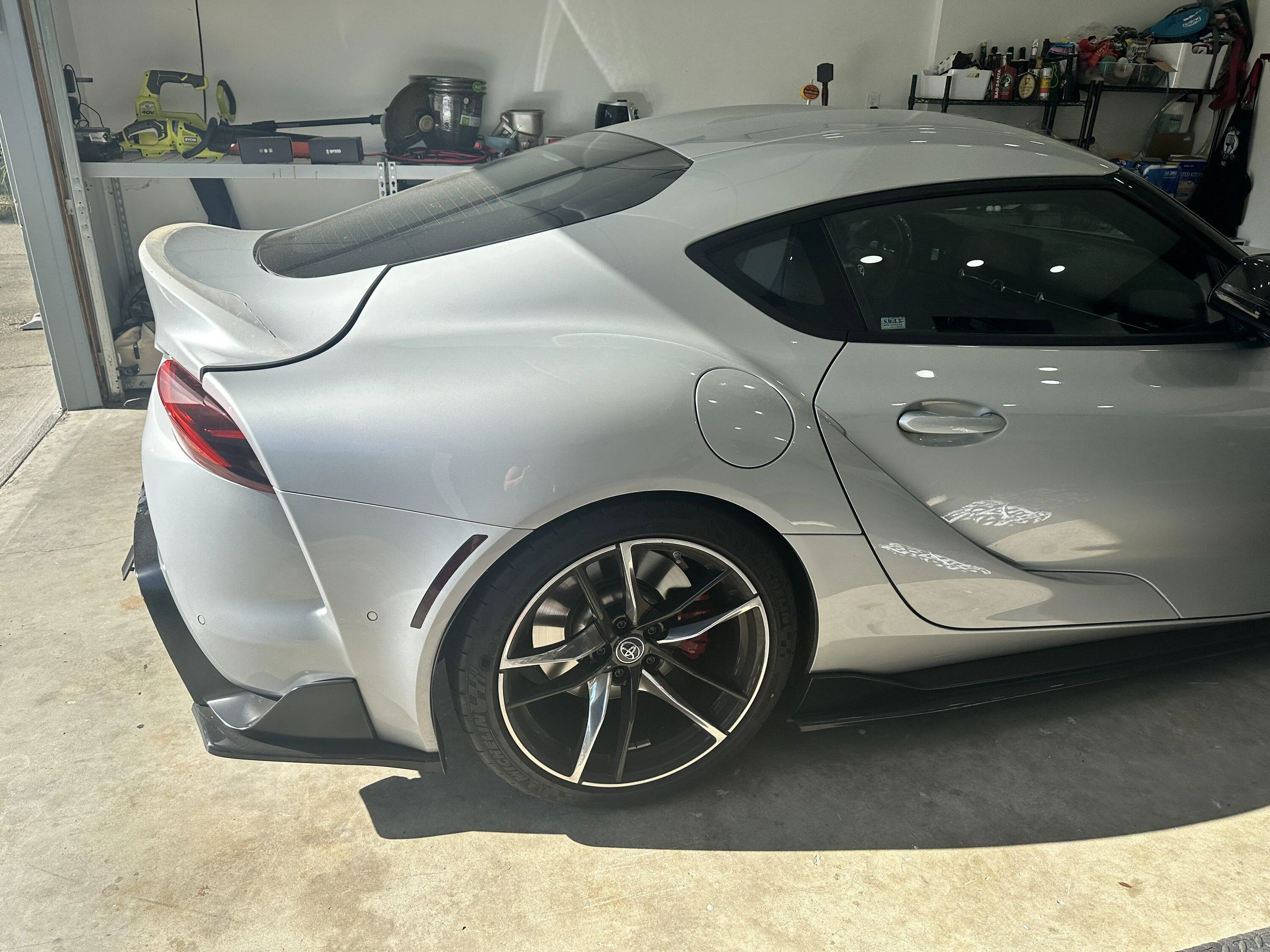

I’ve taken a few more pictures along with closer ups of that pillar others were concerned about. It is ever so slightly raised on the drivers side it seems. I should add that where the rear window meets the roof line right at those pillars, there is damage above the window where it looks like it pushed the window towards the front of the car.

I’m still hesitant to say too much without being able to physically get my hands on the sheet metal and inspect, but your left quarter is the only one I would worry about. Door gap looks tight but could just be the angle. The gap between window and roof rails looks off.
it’s remarkable hard to see some of this stuff without being able to skylight the panels properly so I don’t want to say much more and set your expectations wrong.
Ive circled the areas a buckle is most likely to occurred, so you can check those yourself. Arrows are gaps that look off.
It may all seem scary, but I’ve done and seen some incredible work come out of shops. Left quarter does appear pushed out slightly, but a good percentage, or all of it, will move back into place once the pressure from the crash bar being inside of its own ass is relieved.
Once that bumper is off and the truck trim is pulled out, you’ll know everything there is to know. You could scoot under the back of the car and see how the floor etc looks if you’re bored. Don’t open the hatch cause there is a coin flip on if it will close again.
