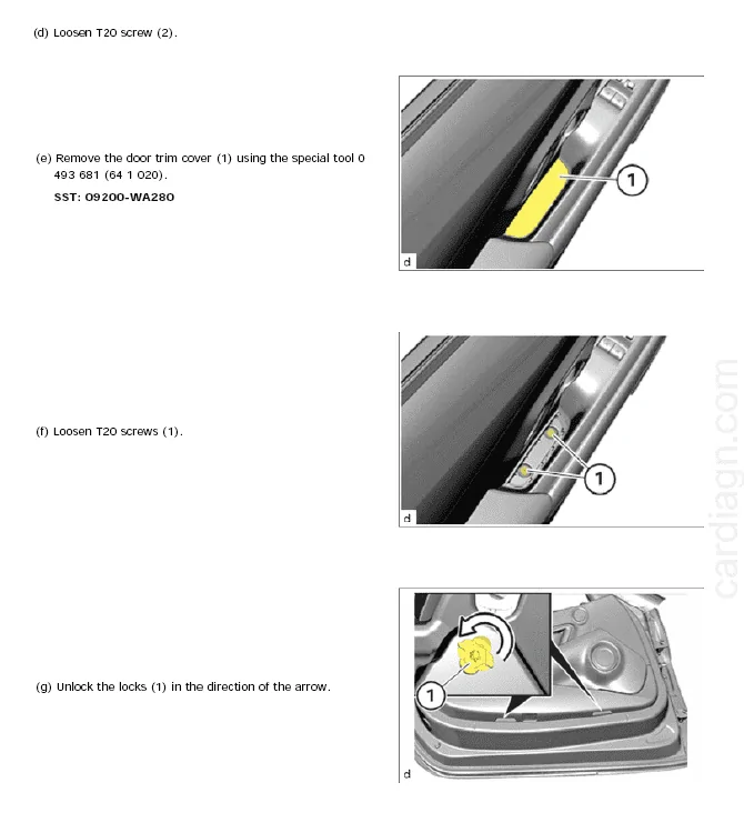

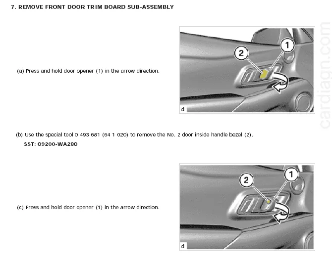

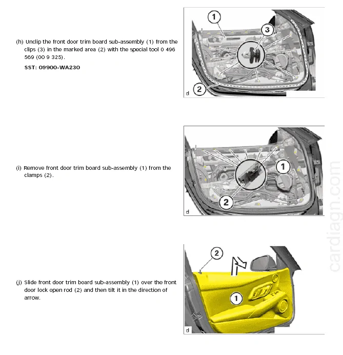

How hard was it to pop the door cards off? Any damage occur?
