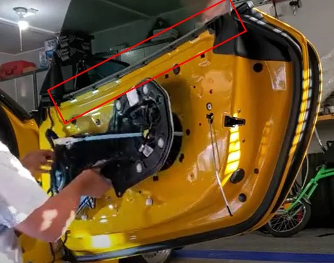

From what it seems to me this might be due to the interior panel coming off the clips a little. I had my panels removed recently and there is a thin line of felt like material similar to what is poking through that gap.
Heres an image of what I can find on how it looks like when you take off the panel.

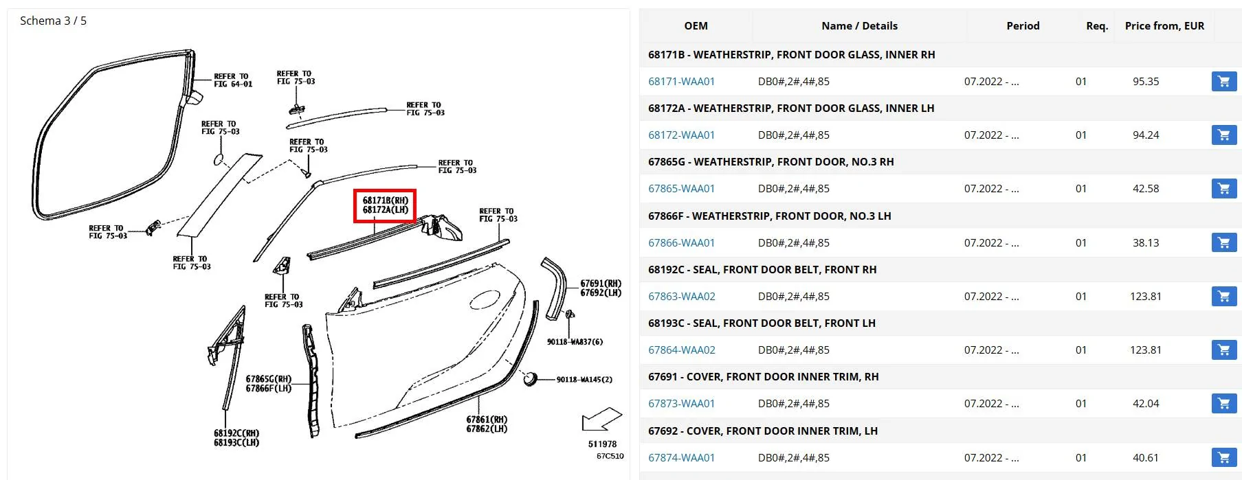

Toyota accepted warranty complaint on both door weatherstrips, they are going to replace both sealings. I think these are the ones on the picture, correct? I thought this sealing was glued to the door panel while it's clearly attached to the door itself, therefore I'm wondering if replacing it makes sense. What do you guys think?
