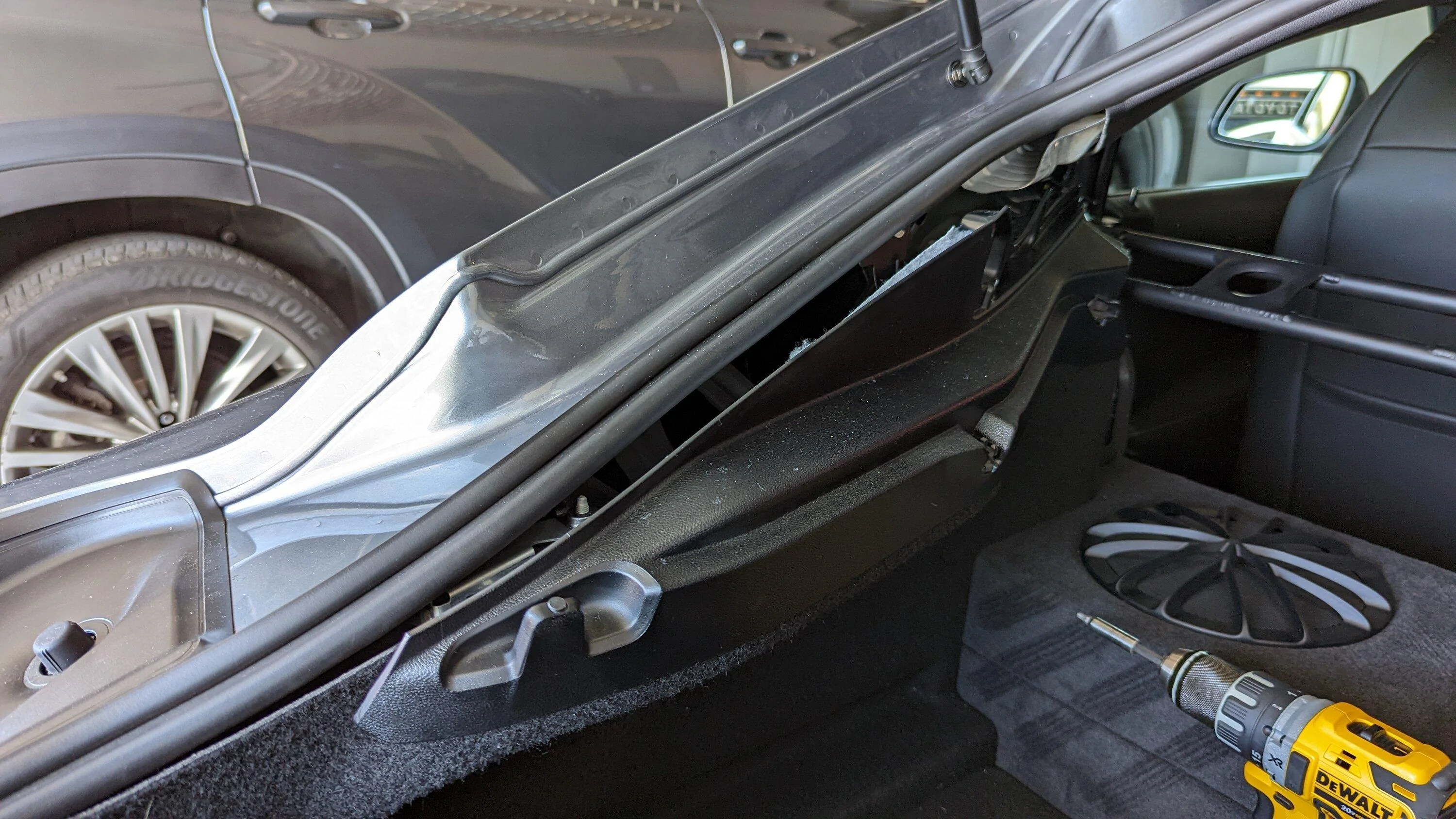

I searched here and couldn't find exactly what I was looking for - apologies if this is a repeat question. I'm attempting to install the Hochman harness bar I purchased, and because it's larger than most, a significant number of interior panels must be removed to slot it into place. I'm down to one more panel needing to be removed and I should be good to go.
This is the panel in question:

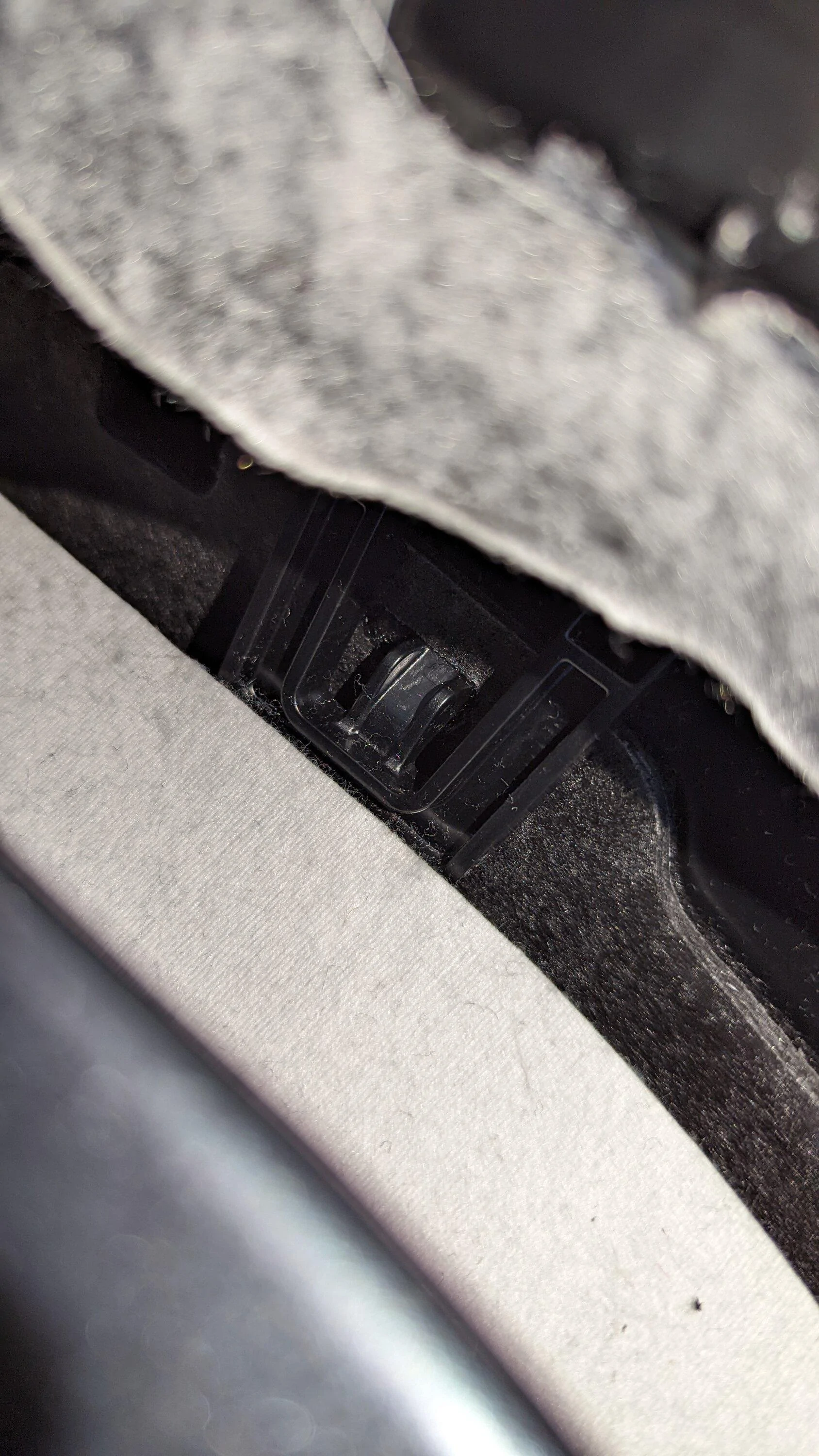

Specifically these clips:
I can't seem to pull them out enough to where the tab slips the notch in the fabric and slides off. Am I missing something?

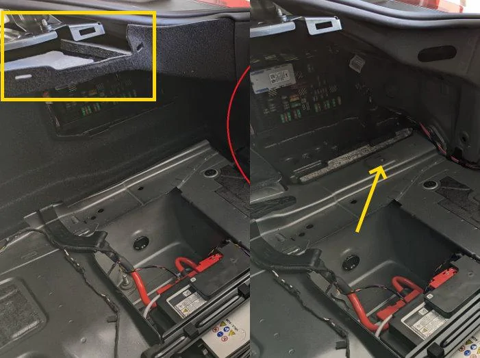

I may not be understanding you entirely but if you are looking to remove the side panel you will have to remove the basically everything else in the trunk to do so. The top plastic bit and fabric are one whole piece.
For reference:

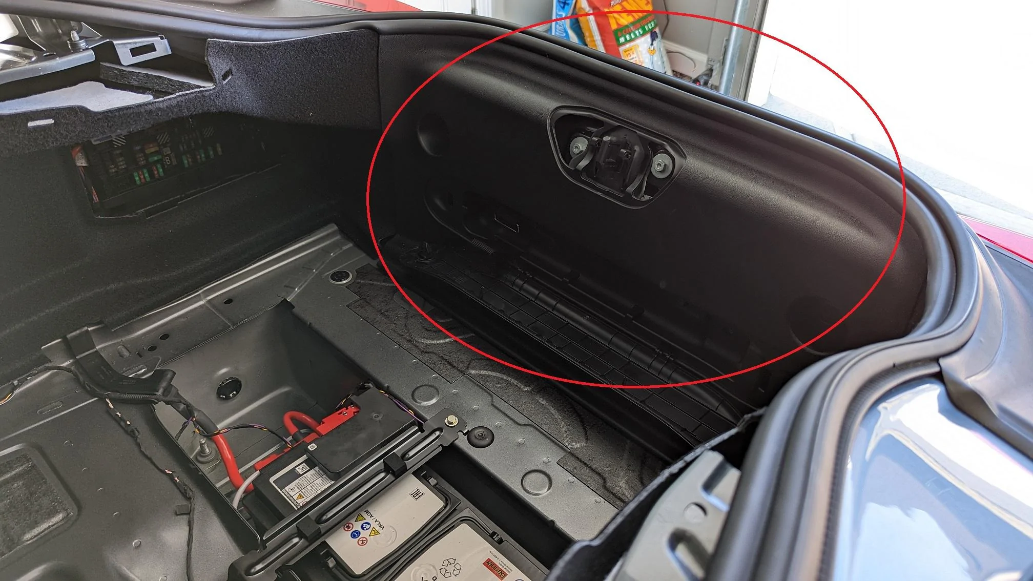

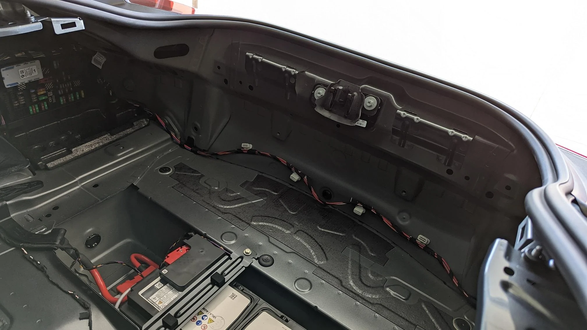

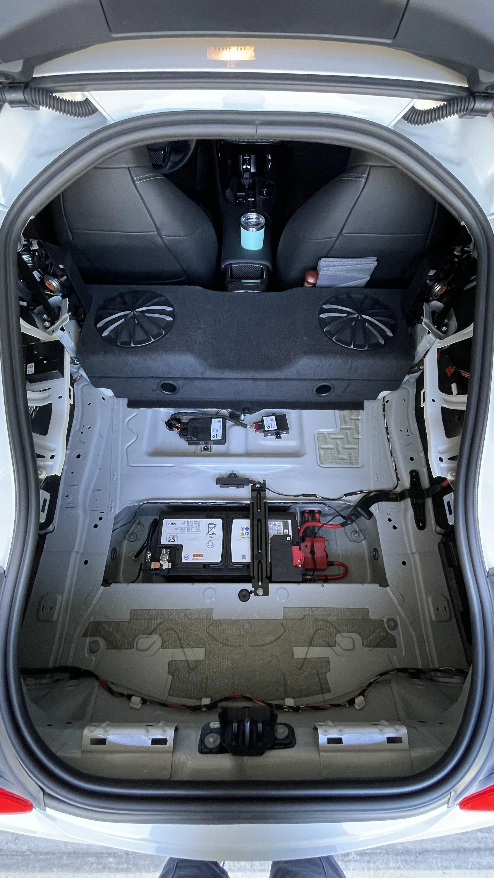

Ok, I got everything out, installed the harness bar (which I will post pictures of), put some stuff back in, then decided just to remove the interior entirely. So instead of posting a new thread I thought I would revive this one. I cannot, for the life of me, figure out how to take out this panel, which is holding the two large pieces of carpet on the sides of the trunk:
I've removed the two plastic lock push and pull screw thingies and the two metal screws. I see there are two bolts that from what I can tell hold the latch for the trunk, and not this body panel, and I'm hoping isn't the key to this because I really don't want to have to realign everything. It's being held on by something at the top - maybe around where it curves. Any pointers? Have I just not pulled it hard enough yet?

Take a look at my picture above, there are 4 slots on the top edge that hold that piece in place. You’ll have to peel back the rubber weather stripping to pull straight up on that piece. And you are correct, those two bolts have nothing to do with this panel, thankfully.

Excellent! Thank you for this pointer. This is exactly what I was missing. Going to go wrestle with this here in about an hour.

Thanks fam (@J29DB03)! Popped right out, just like you said, when peeling back the gasket material and pulling up with a good bit of force. Now just need to remove the trim on the liftgate and then I can work on the speakers.

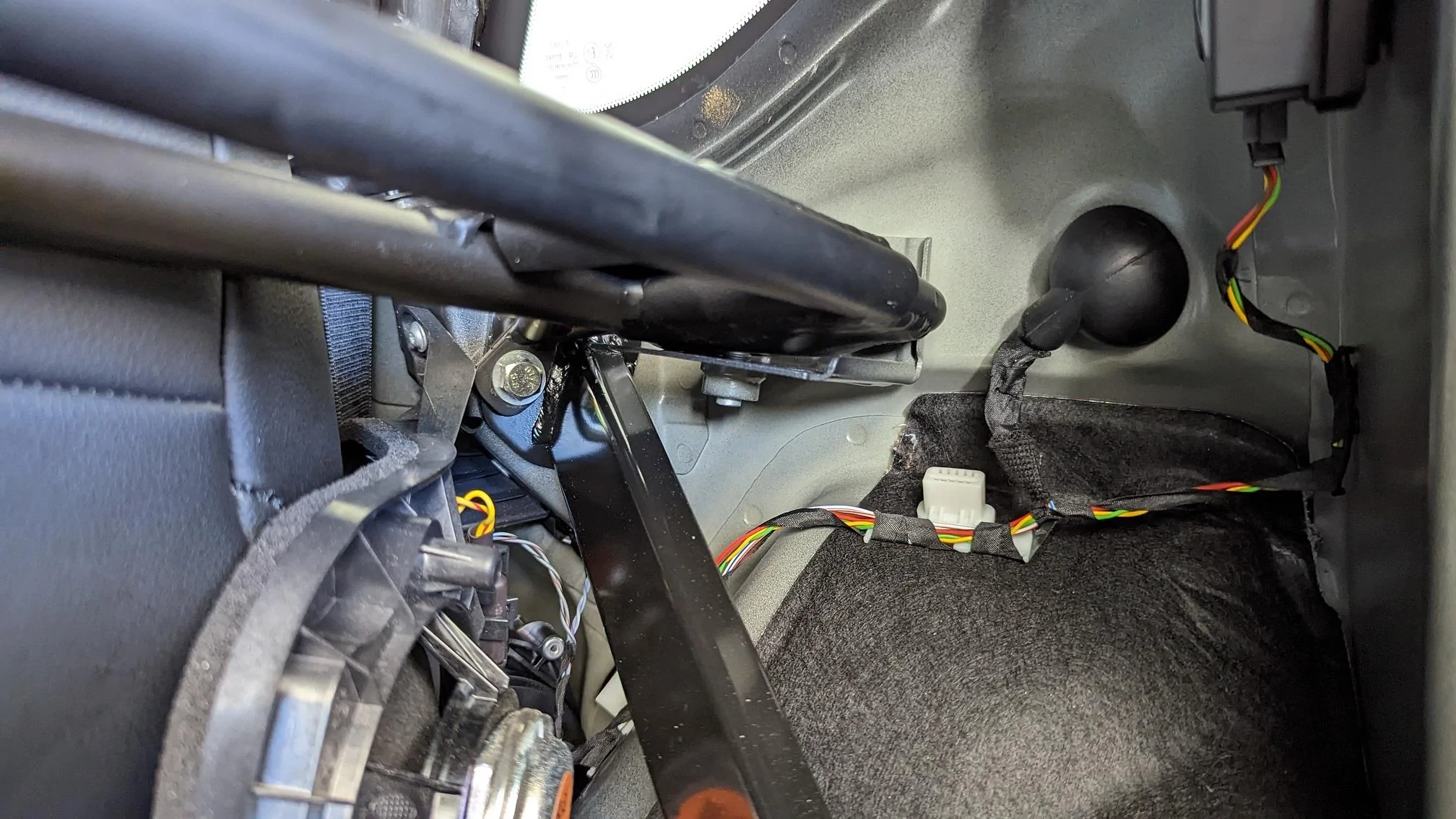

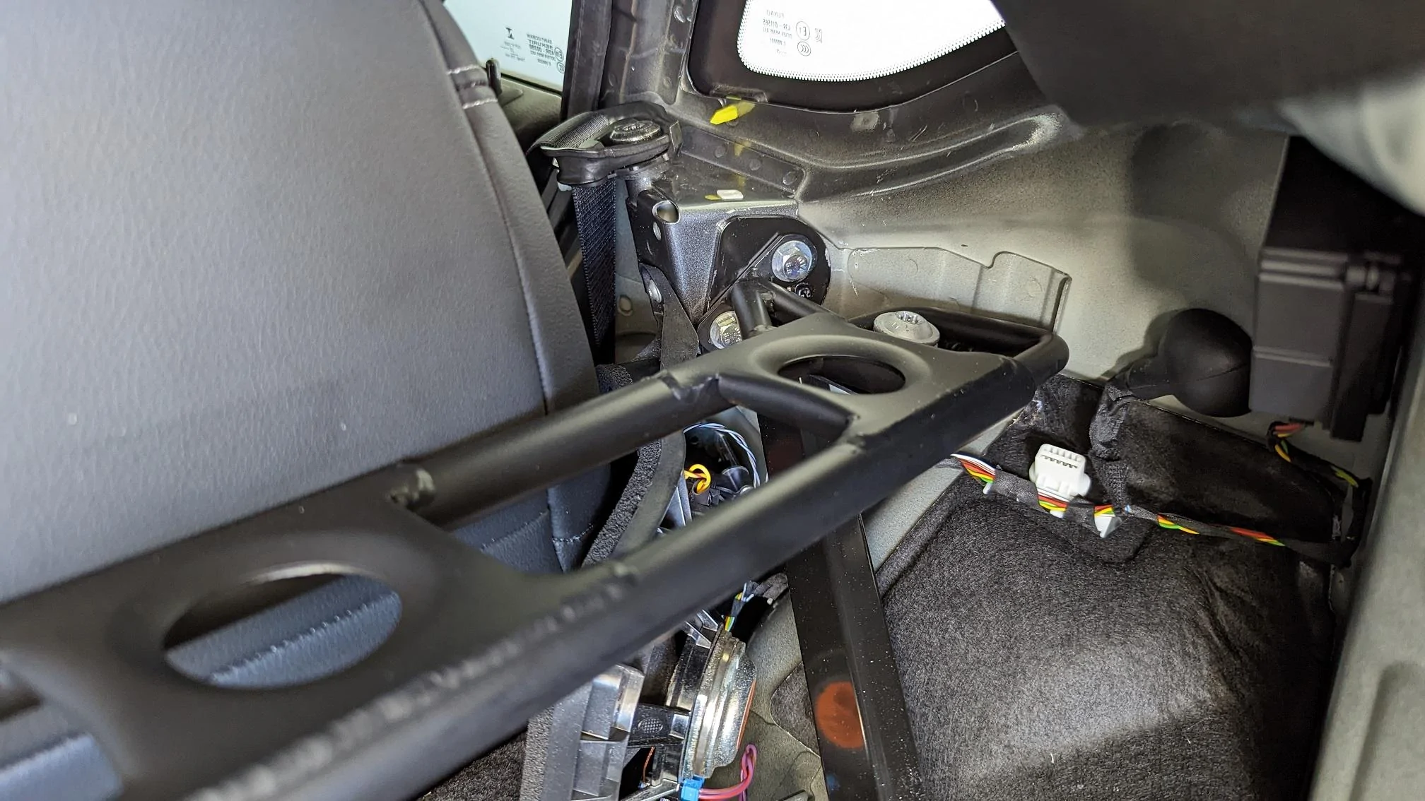

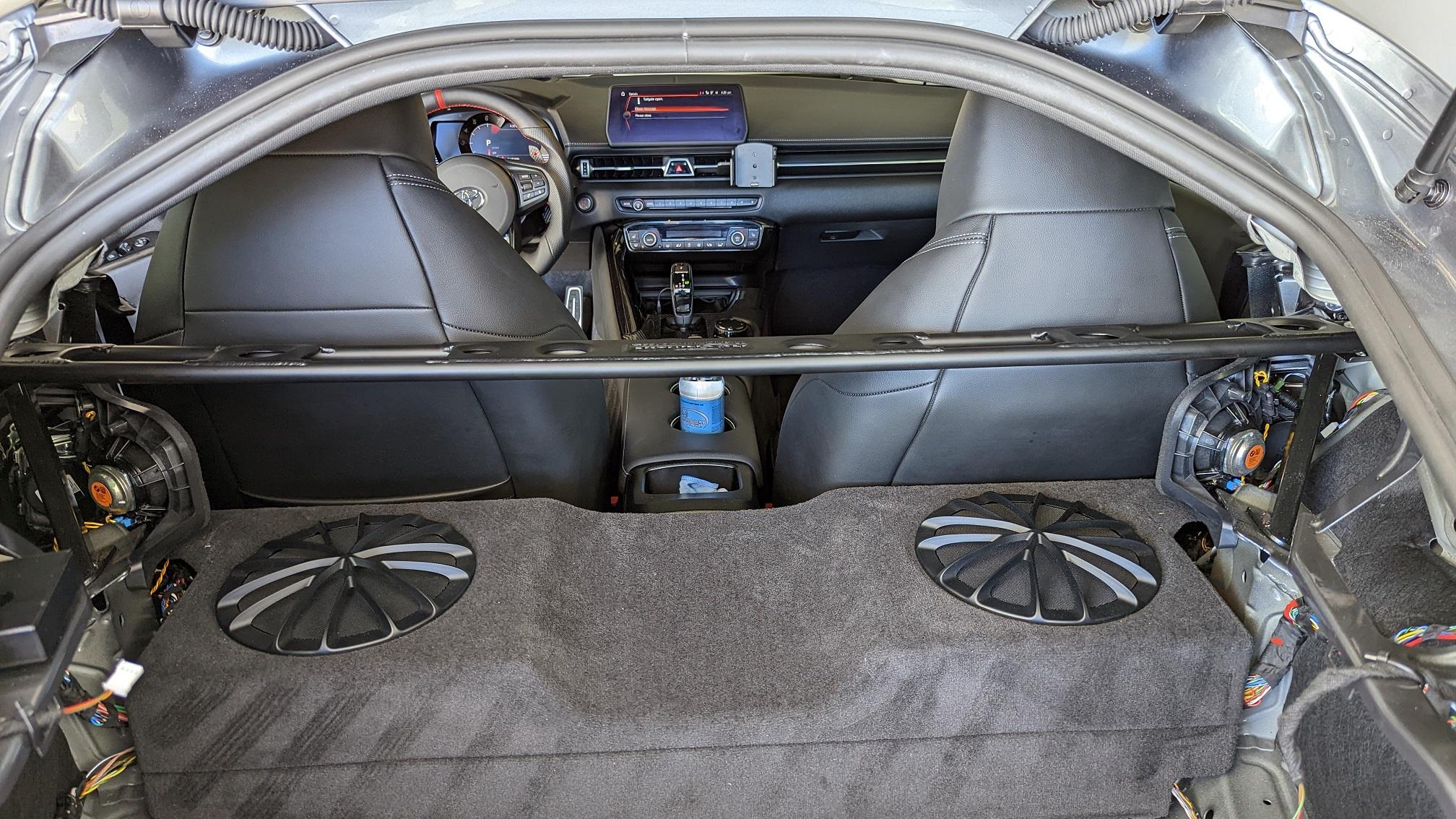

So, it's been a while, but here are pics of the Ben Hochman harness bar (powder coated matte black):
The thing is built to millimeter precision and high quality. It is expensive. Ben was absolutely awesome to work with and sent pics and video of the fabrication throughout the process. When compared to something like the Cusco harness bar, it's night and day. However, because of the way it slots into place, it's significantly more difficult to install and requires the removal of a bunch of different interior panels. Due to this, it makes it difficult to recommend unless you're removing your interior anyway either permanently or are working on another project. Or you're a masochist. Had I known how difficult it was to install, I wouldn't have purchased it.
Well, it seems to be one piece but apparently looking at the pictures it can be separated, fabric from upper plastic part. How to do it? I'd like to install OEM tie down hooks 66311-WAA01 and bracket set tether anchors 73708-WAA01. Maybe someone has already installed them and can share a picture? I believe they go into the threaded holes pointed by arrow, right?
