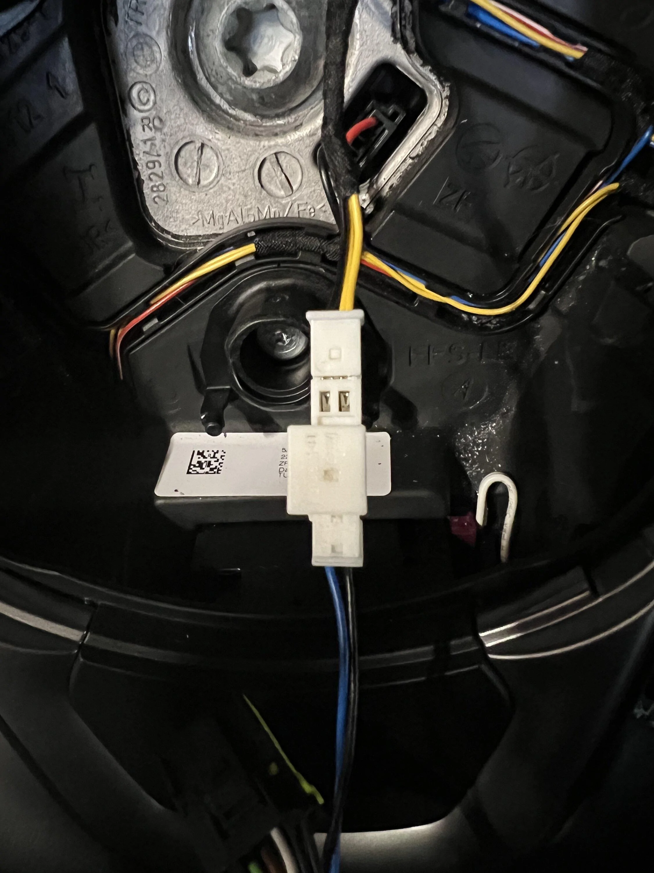

I got the airbag out of the wheel but I cannot get this clip undone to full disconnect it. Anybody have any advice??
I had the same issue. I was able to remove it eventually in a way, but if you're going to do that, I would do it with caution.
There's a part in the clip where it should simply be press and pull, but clearly that's not the case. I used some vice grips to press that area and pulled lightly. If the vice wasn't tight enough, I would add 1/8 of a turn and try again until it would come out. Don't over tighten or you'll crush the clip.
Maybe there's a better way to do it, but at least this method worked for me with my available toolset.

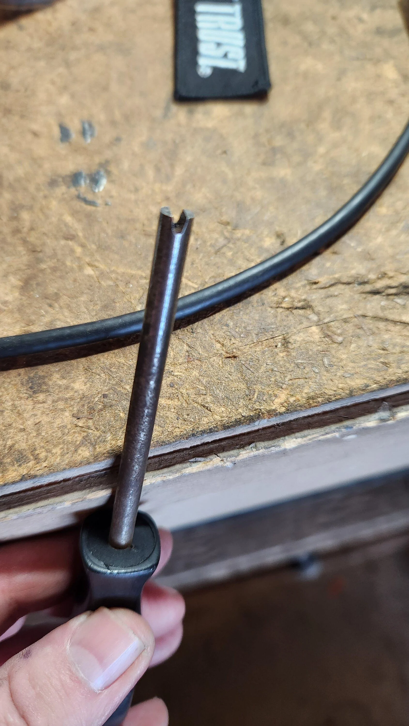

You need to depress the pin with either a screwdriver or pick tool and pull the connectors apart
