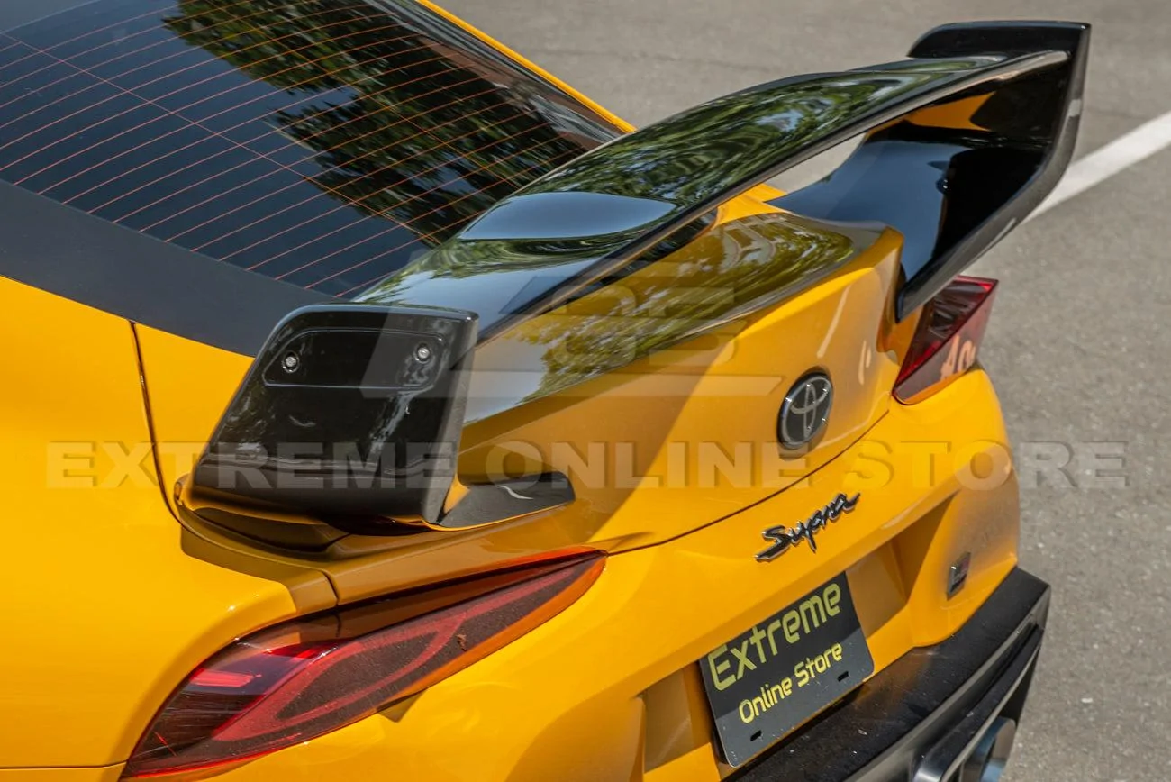

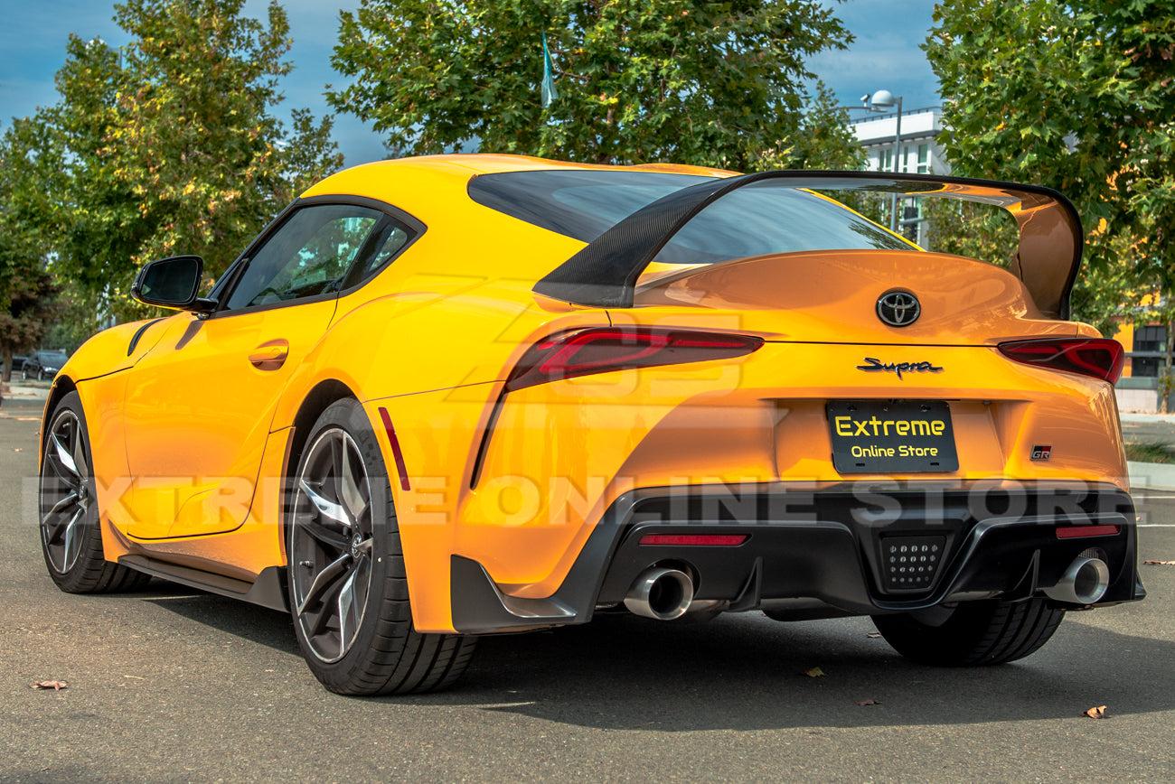

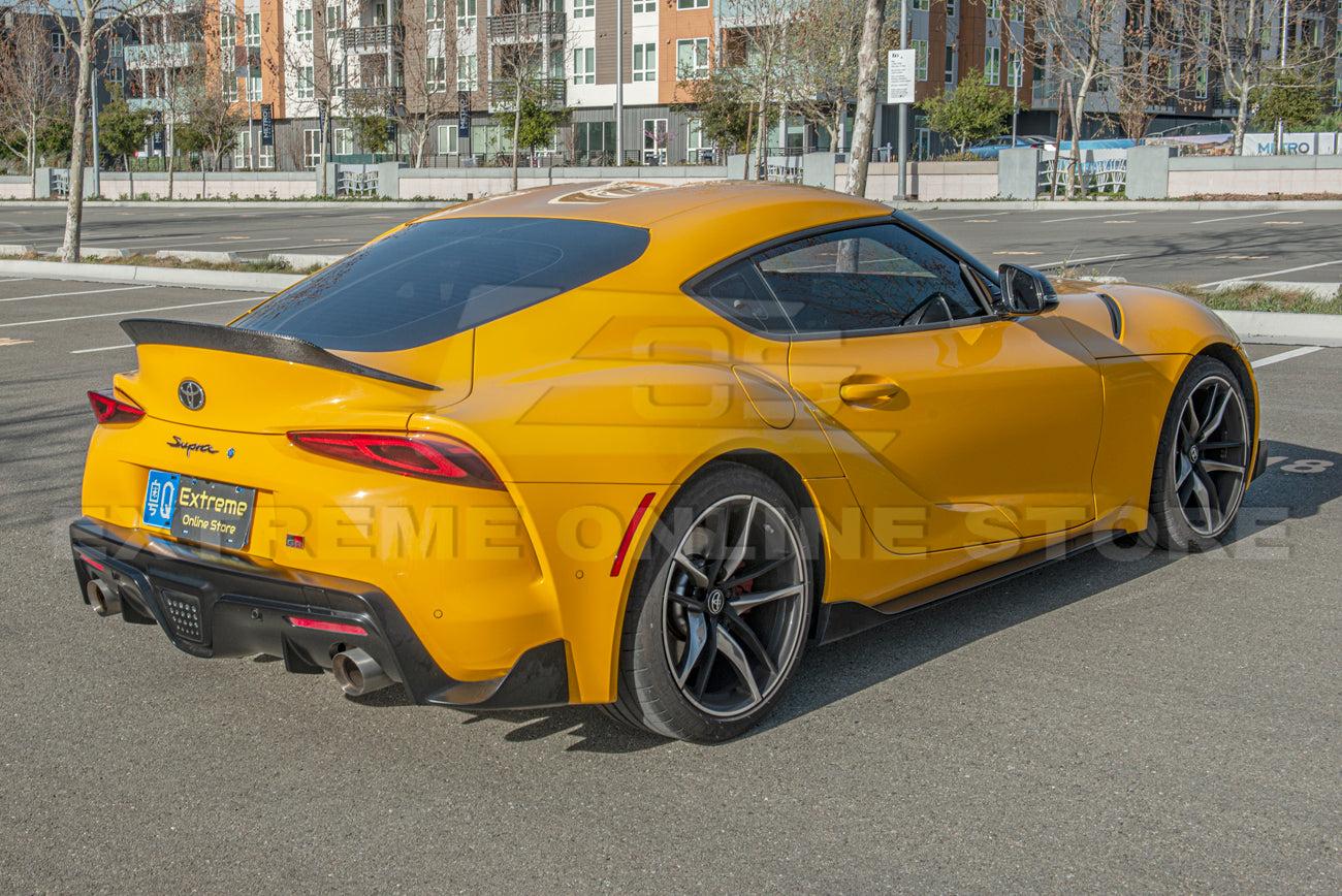

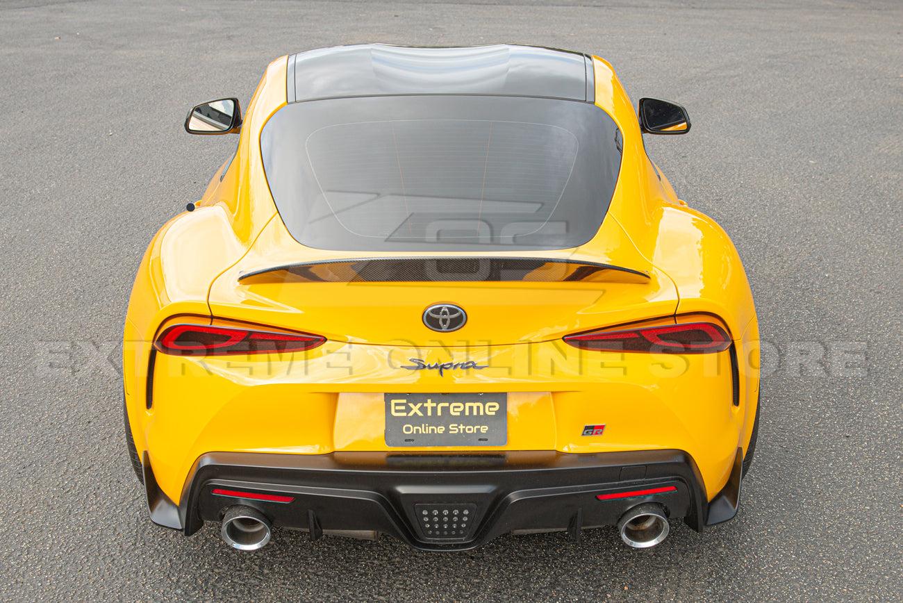

A car spoiler is a wing-like device that is attached to the rear of a vehicle to increase downforce and improve stability at high speeds. While spoilers have become popular accessories for their sporty look, they also serve a practical purpose for high-performance cars. In this article, we’ll explore how a car spoiler increases aerodynamics and why it is an important component of high-speed driving.
Introduction:
When driving at high speeds, air resistance becomes a major factor that affects the performance of your vehicle. To combat this, engineers have developed several aerodynamic components that can help reduce air resistance and improve the stability of the car. One such component is the car spoiler.
A spoiler is a device that is attached to the rear of the vehicle, and its main purpose is to increase the downward force or “downforce” on the car’s wheels. This increased downforce helps to keep the car planted on the road, improving stability and handling, especially when driving at high speeds.
What is a Car Spoiler?
A car spoiler is a small wing-like device that is mounted on the rear of the vehicle, typically on the trunk lid or rear deck. The spoiler’s shape and angle are carefully designed to produce downforce by redirecting the airflow over the car’s body. The increased downforce helps to reduce lift, which is the tendency of the car to become airborne at high speeds. This increased grip on the road enhances the handling and stability of the car, making it safer and more fun to drive.
How Does a Car Spoiler Increase Aerodynamics?
A car spoiler works by disrupting the flow of air over the car’s body, causing the air to separate and produce turbulence that creates downforce. When driving at high speeds, the airflow over the car’s body creates a lifting force, called “lift,” that makes the car less stable and more prone to become airborne. The car spoiler helps to counteract this lift by directing the air downwards, creating a downward force that keeps the car planted on the road.
The angle and shape of the spoiler are critical to its performance. The angle of attack, which is the angle between the spoiler and the oncoming airflow, determines the amount of downforce produced. A larger angle of attack will produce more downforce but also increases drag, which is the resistance created by the airflow against the car. Engineers must balance the angle of attack with the shape of the spoiler to achieve the optimal balance between downforce and drag.
Different Types of Car Spoilers
There are several different types of car spoilers, each designed for specific types of vehicles and driving conditions. Some of the most common types of spoilers include:
Lip spoilers: These are small, flat spoilers that are mounted on the rear of the car. They provide a sporty look and a small amount of downforce, but their main purpose is to improve the appearance of the car.
Wing spoilers: These are larger spoilers that resemble airplane wings, and they are typically mounted on the rear deck or trunk lid. Wing spoilers provide a substantial amount of downforce and are used on high-performance cars to improve stability and handling at high speeds.
Rear diffuser spoilers: These are mounted underneath the car, and they work by directing the air around the rear wheels, creating a low-pressure area that helps to reduce lift. Diffuser spoilers are commonly used on racing cars and high-performance vehicles to improve aerodynamics and handling.
Canard spoilers: These are smaller spoilers that are mounted on the front of the car, and they work by redirecting the airflow around the front wheels. Canard spoilers help to reduce lift and improve the stability of the car, especially when driving at high speeds.
Each type of car spoiler has its own unique design and function, but they all serve the same purpose of improving aerodynamics and stability at high speeds.
Conclusion:
In conclusion, a car spoiler is a simple yet effective device that can greatly improve the aerodynamics and stability of your vehicle. By directing the airflow over the car’s body and producing downforce, a car spoiler helps to keep the car planted on the road, making it safer and more fun to drive. Whether you’re a high-performance driver looking to improve your lap times or just looking to add a sporty touch to your car, a car spoiler is a great addition to consider.
